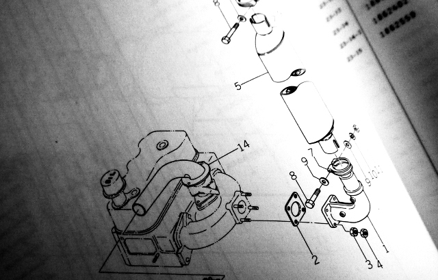

I have had the exhaust manifold elbow adapter break off on my 1910. I have not had the best experience welding cast iron so I had a welder fix it, he used some special rod I am pretty sure it is not brazed. Came out great. I made a brace from the front of the tin to the top of the stack to help prevent me hooking it a second time.
   / Iseki G192 TS1910 19 #26
Actually, on my tractor, it is the curved piece that goes up to the muffler that has cracked, it leaks exhaust gases, but not that bad, I am just going to use it, until I can replace that piece, thanks for the tip making a support brace. The muffler will have to be replaced soon... it is blowing pieces of hot metal out, because it was open to rain for several years.
   / Iseki G192 TS1910 19 #27

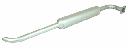

Yes mine cracked at the 90 degree curved part. The angle casting had two short bolted in braces along side the casting that prevented the muffler from falling off.
The link shows a curved head pipe, replacing the curved casting.
The curved manifold must have had a design flaw.
You should get your manifold welded. Mine was welded without removing it from the tractor.
