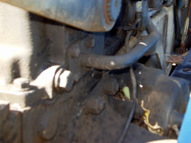

where does the return line fix into on my tractor is there a blanked hole to accomodate it in rear casing around seat area, any info much appreciated
/ iseki hydraulics #7
Cardun14 , Not sure if this will help or not , This is a model 2202 Iseke. So No clue if its the same or not, & I,m only assuming its the return line as I didn,t install or hook it up . Hope it might help till someone else can. I just snapped a pick. But yours may be Way different . Best of luck. CB

/ iseki hydraulics
many thanks cb, doesn't look like it but will look at mine in morning as it,s dark and raining again here in scotland
