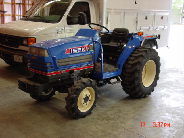

Here is picture of my TA207. I have installed industrials on the front since this picture.

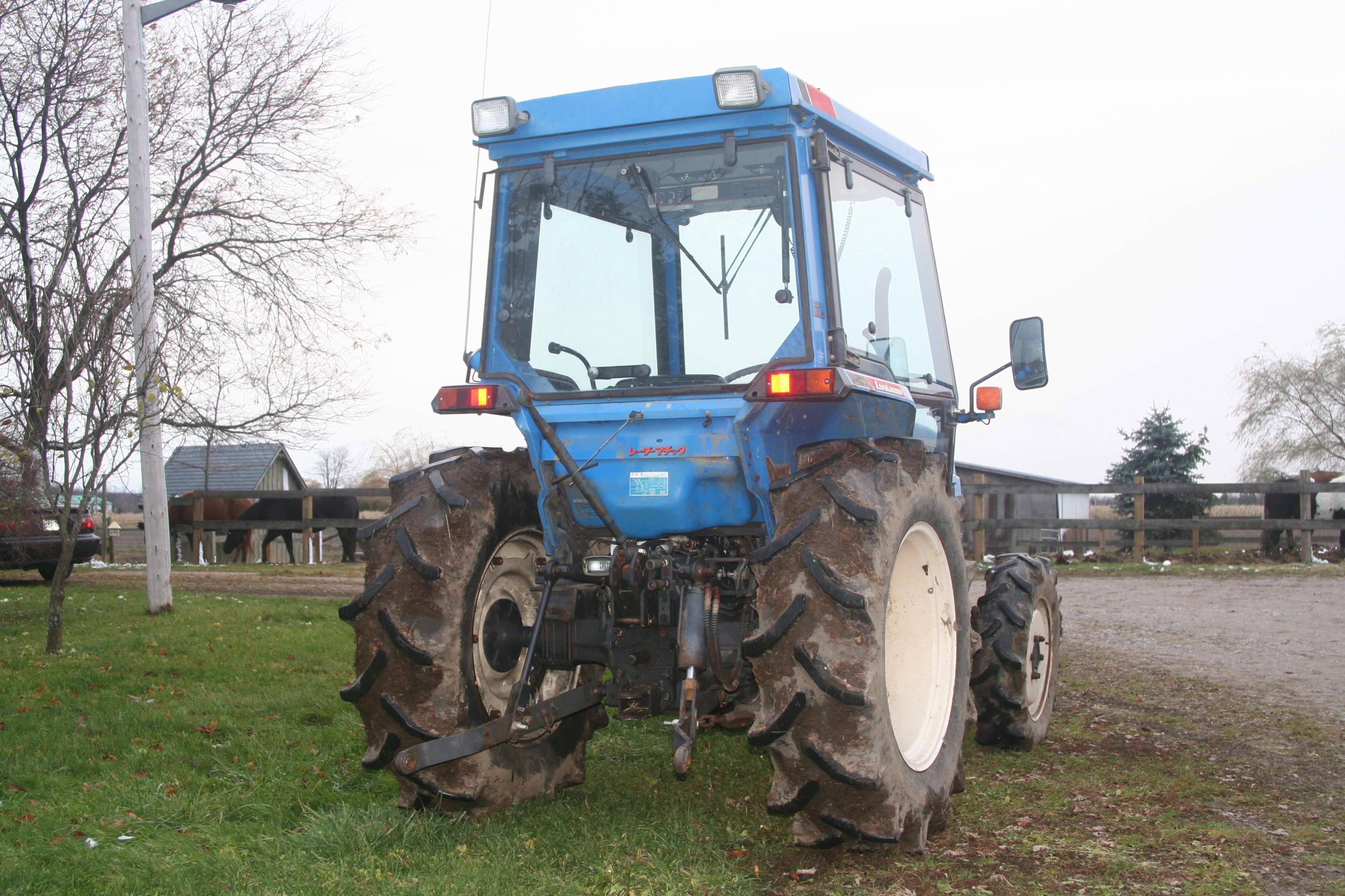

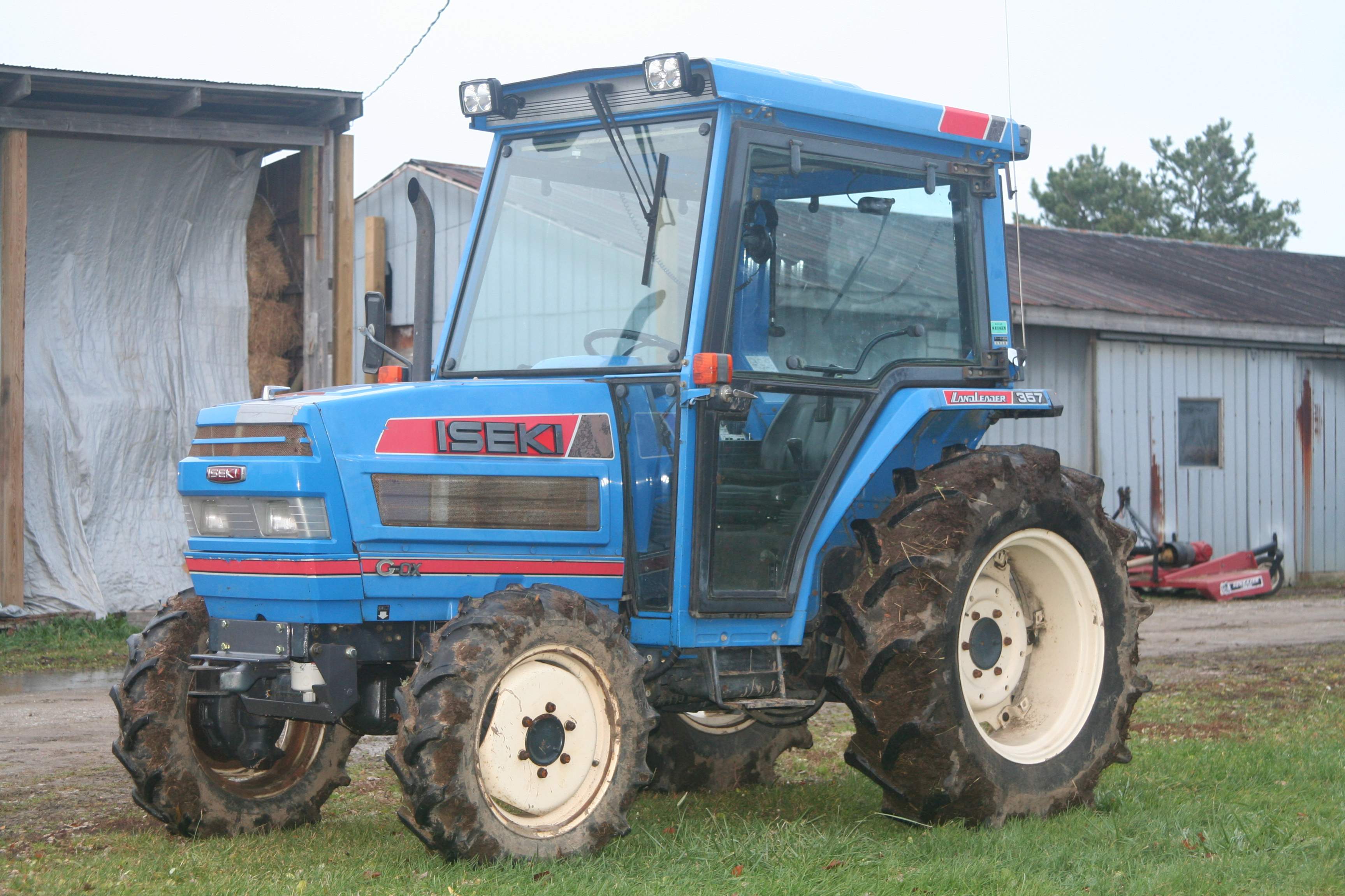

Here is my TA357. I've had it for 2 months now, very happy with it so far. It needed a lot of TLC (plus a new rad and new bushings in the top of the front axle final drives). It seems to be a cross between a MF1160 and a MF1260. It has a 4cyl Isuzu engine like the 1160 but everything else appears to be closer to a 1260. Also it has a lot of hydraulics on it such as the all hydraulic controlled 3ph and a button you can push when its in 4wd that doubles the speed of the front wheels :cool:. Hopefully none of this gives me any trouble cause I don't think there's any North American crossovers that have these features.

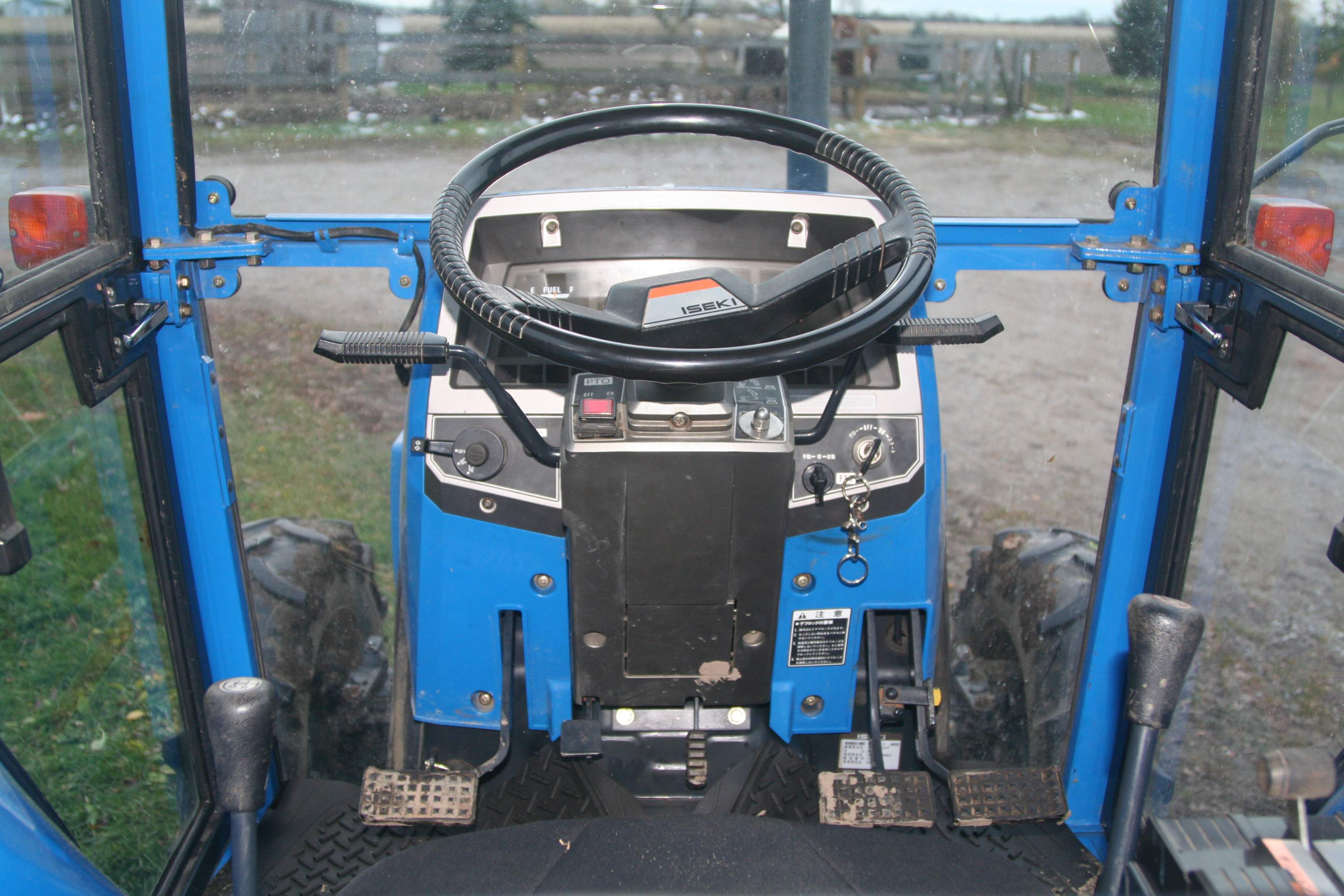

Where is the button that doubles the front wheel speed? I have a green square button in the box that my 4x4 shifter is in. Do you have the button by the steering wheel that raises and lowers the three point to your presets?
   / Iseki Landleader 230 is it a TA230? #17

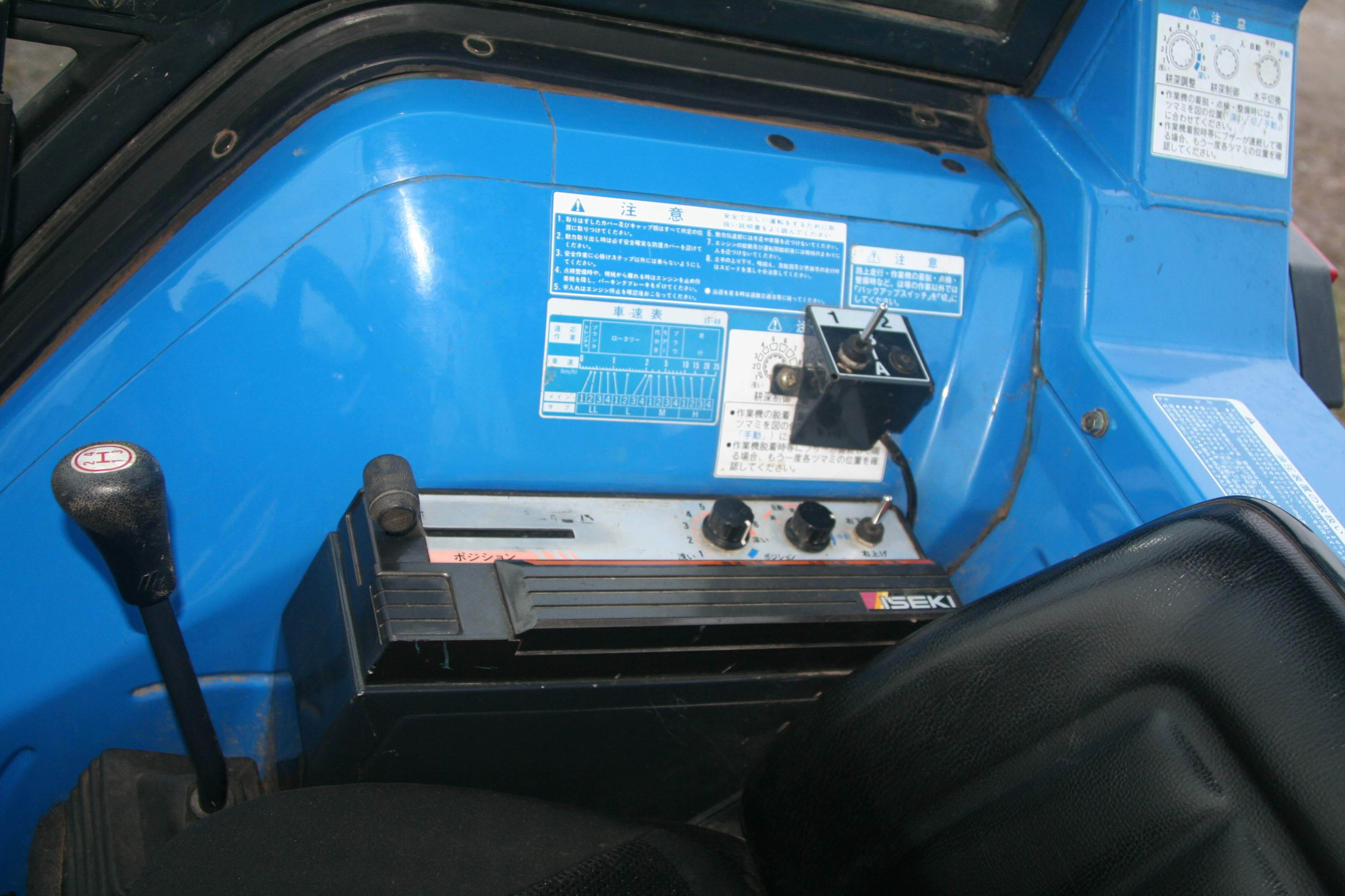

This could get interesting. My TA247 has the buttons you are asking about. I dont know much about them. I am curious if anyone has figured out all the switches and knobs in the 3pt box on the right side of the seat. ?? Also what does the button do that is next to the steering console on the left next to the horn and lights?
MM.:confused:
   / Iseki Landleader 230 is it a TA230? #18
Kays The button is in front of the 4wd drive lever to the left of the seat. When I push it in when the tractor is in 4wd an icon shows up on the dash depicting a tractor in a tight turning radius. I figured that was what this option is for, so you could get turned around in a mucky rice field.
The tractor did come with the button on the column to the right of the steering wheel that raises the 3ph. I took it off though because I want to use the switch on the overhead console to run the front cab lights. They are add-ons but Iseki used the same switch to run the rear cab lights and there is already a cutout in the console next to that one. That 3ph override is a nice feature though so I may have to rethink that one.
Yomax My tractor had an operators manual and a parts manual under the seat when I bought it. Only problem is they're both in Japanese. I have been trying to translate it but am finding out it is not an easy language to learn. Right now I just have both dials turned completely to the right which allows my to use the 3ph in the normal manner.
   / Iseki Landleader 230 is it a TA230? #19

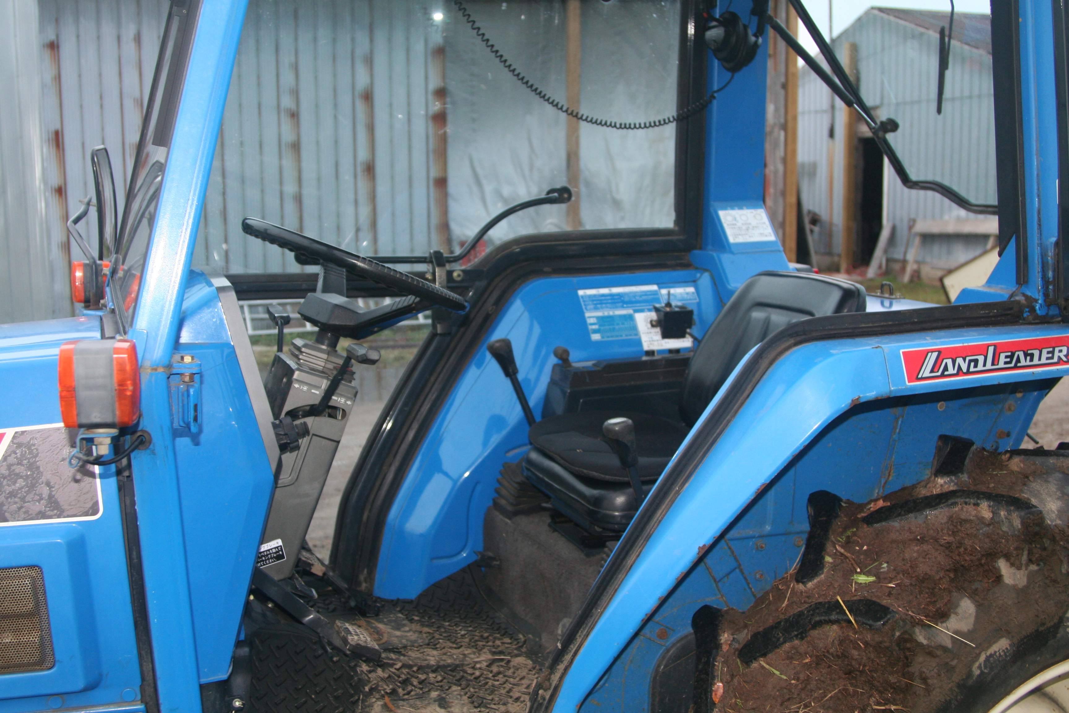

Do you all remember the Rubix Cube? Well I fiddled with the switches and knobs on the 3pt panel until I got it to adjust the side cylinder and set the high and low limits on the 3 pt. I can then push the button to the right of the steering wheel and the 3 point goes up to my preset and then hit it again and it goes down to my set. It is really handy when aerating and box blading. It also can set how fast the arms go up and down.
My tractor has the 4x4 button, but a light doesn't come on the dash , so I guess something isn't working. I really don't need it, but it will be a challenge to get it working.
