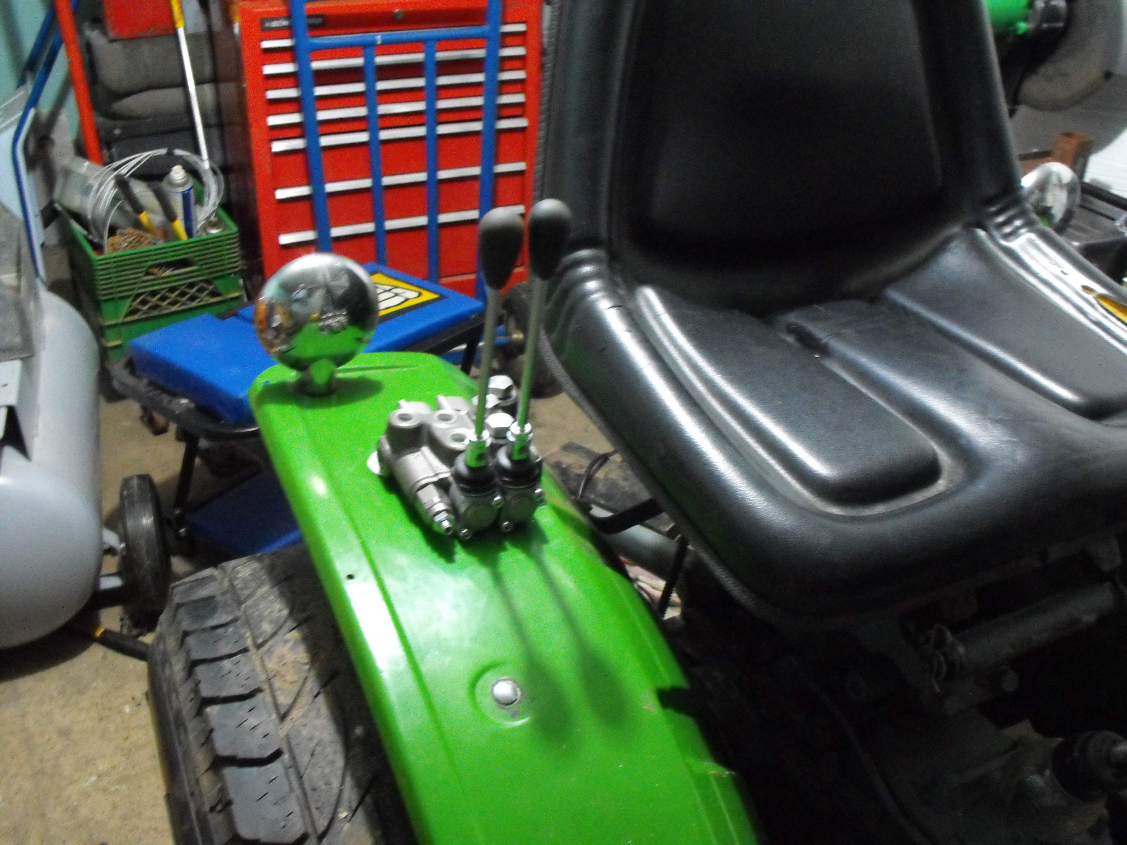

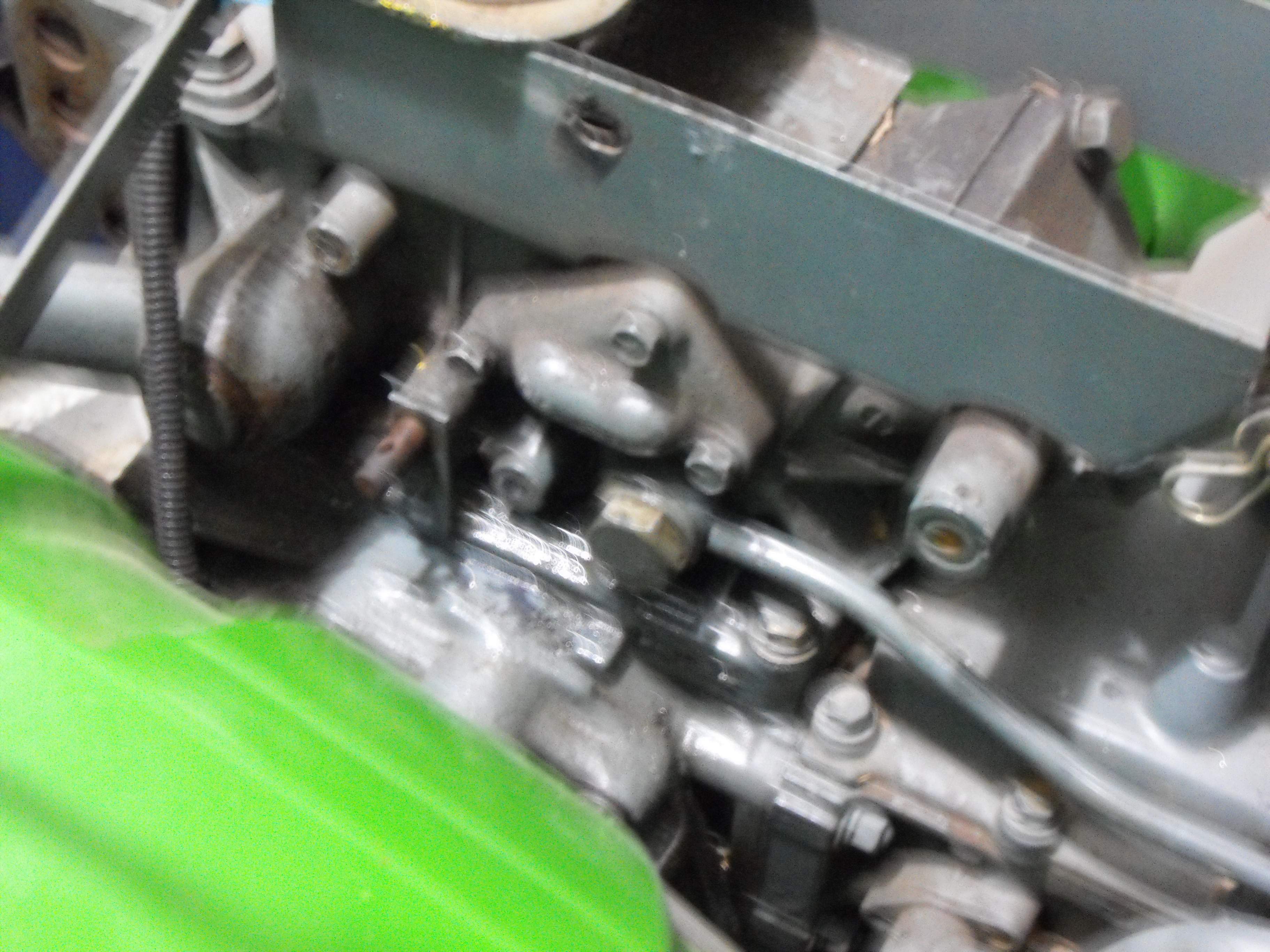

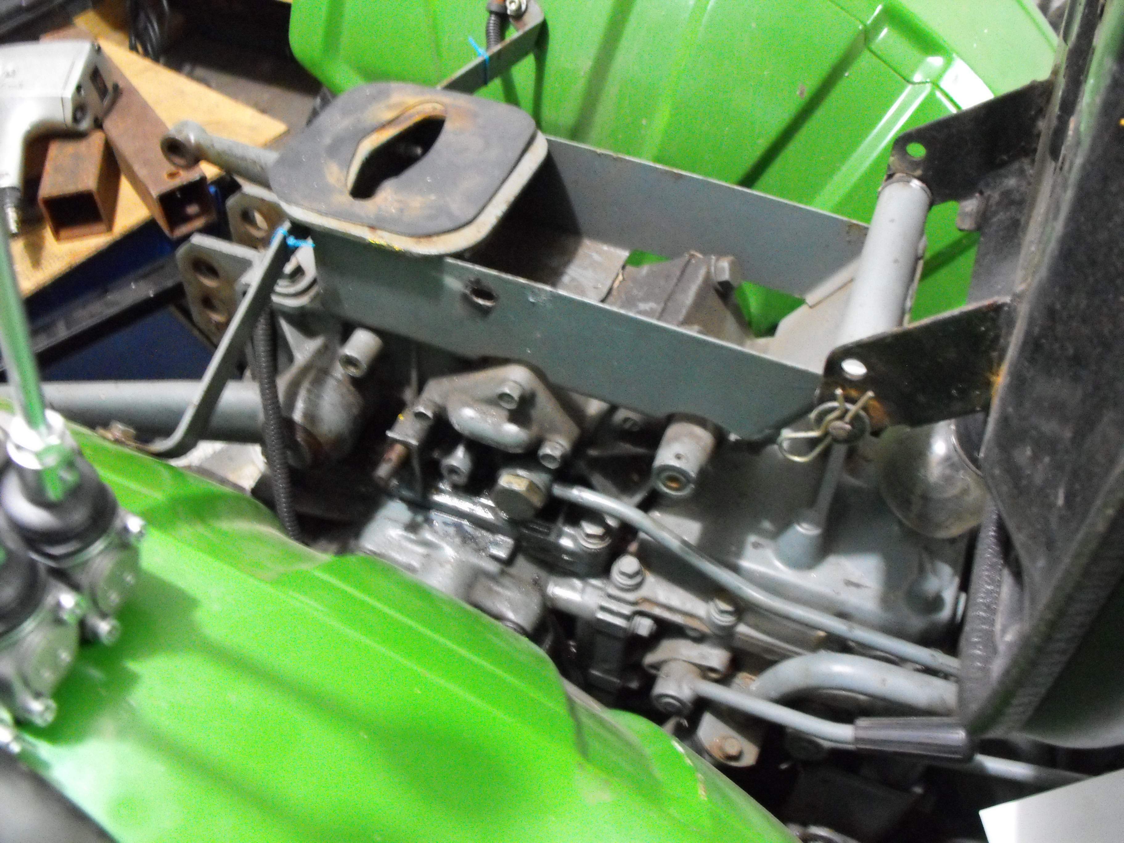

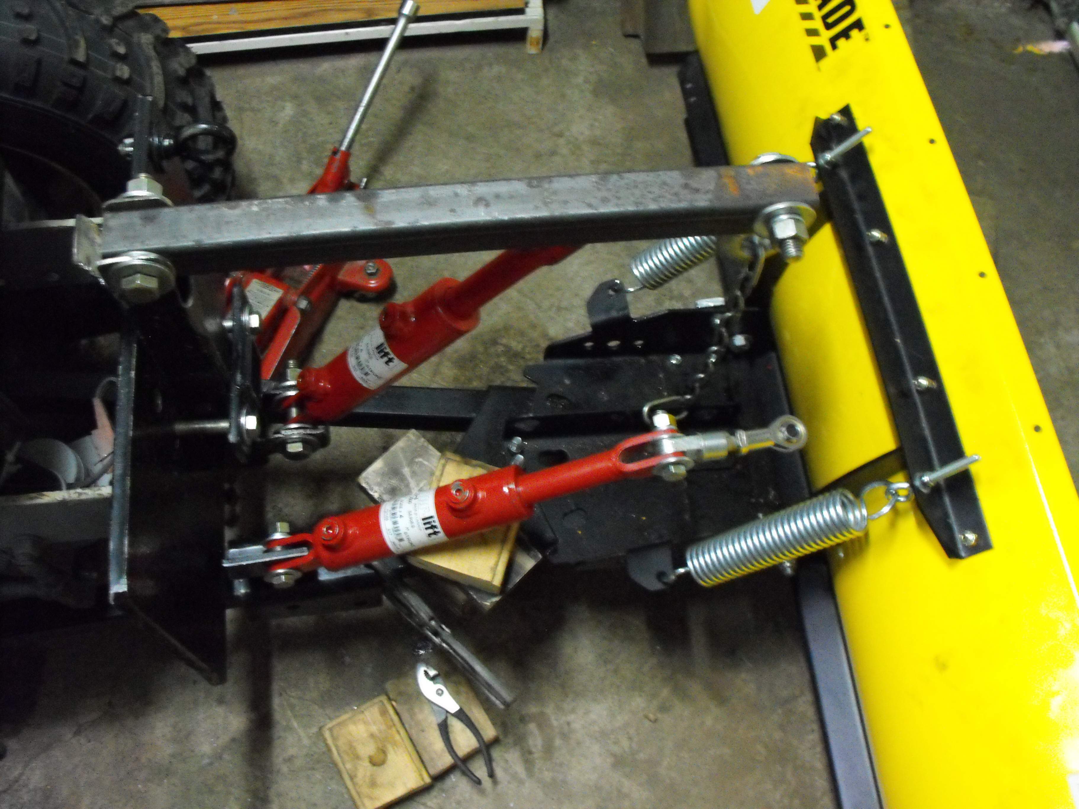

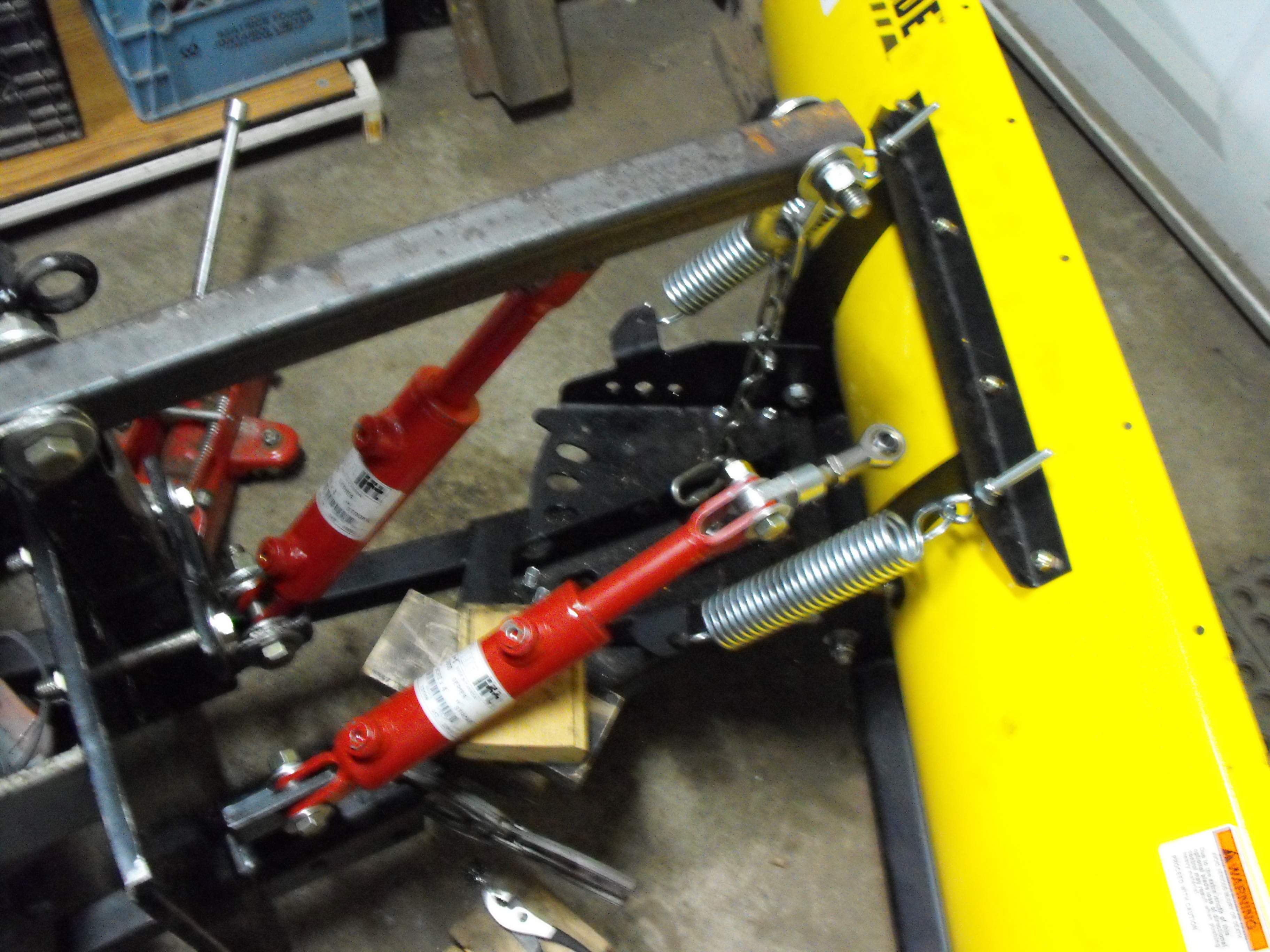

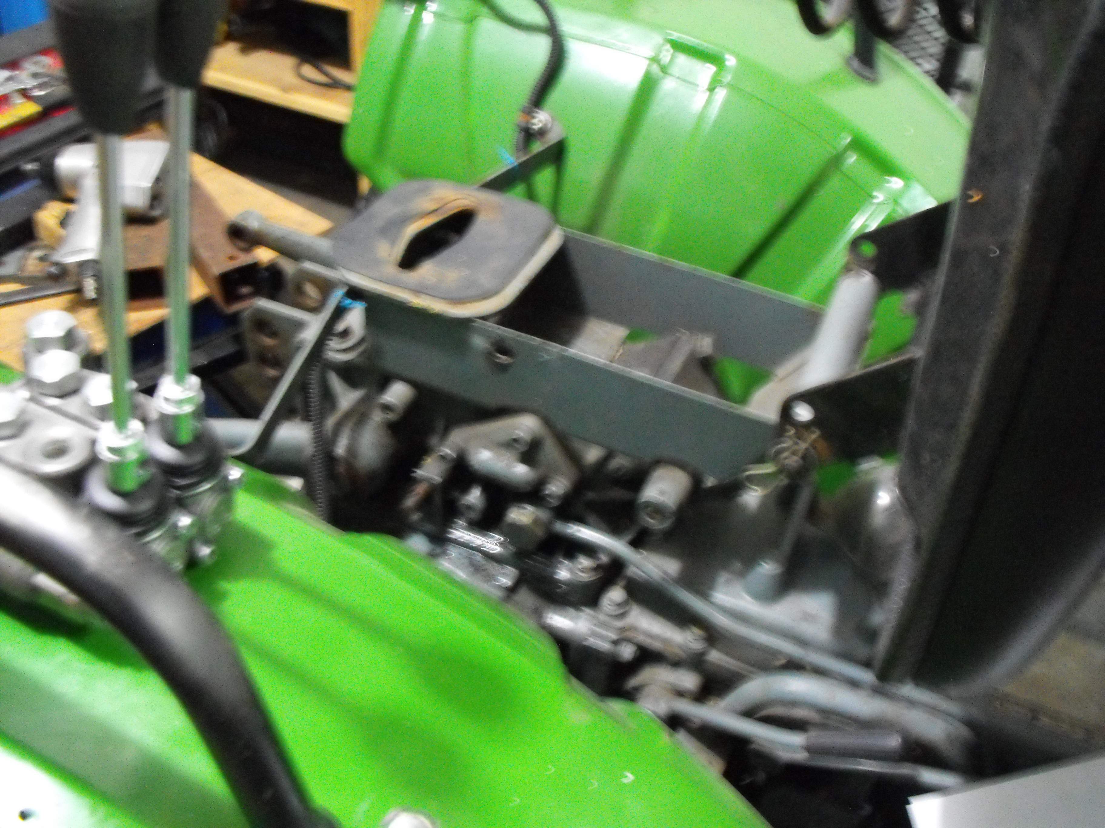

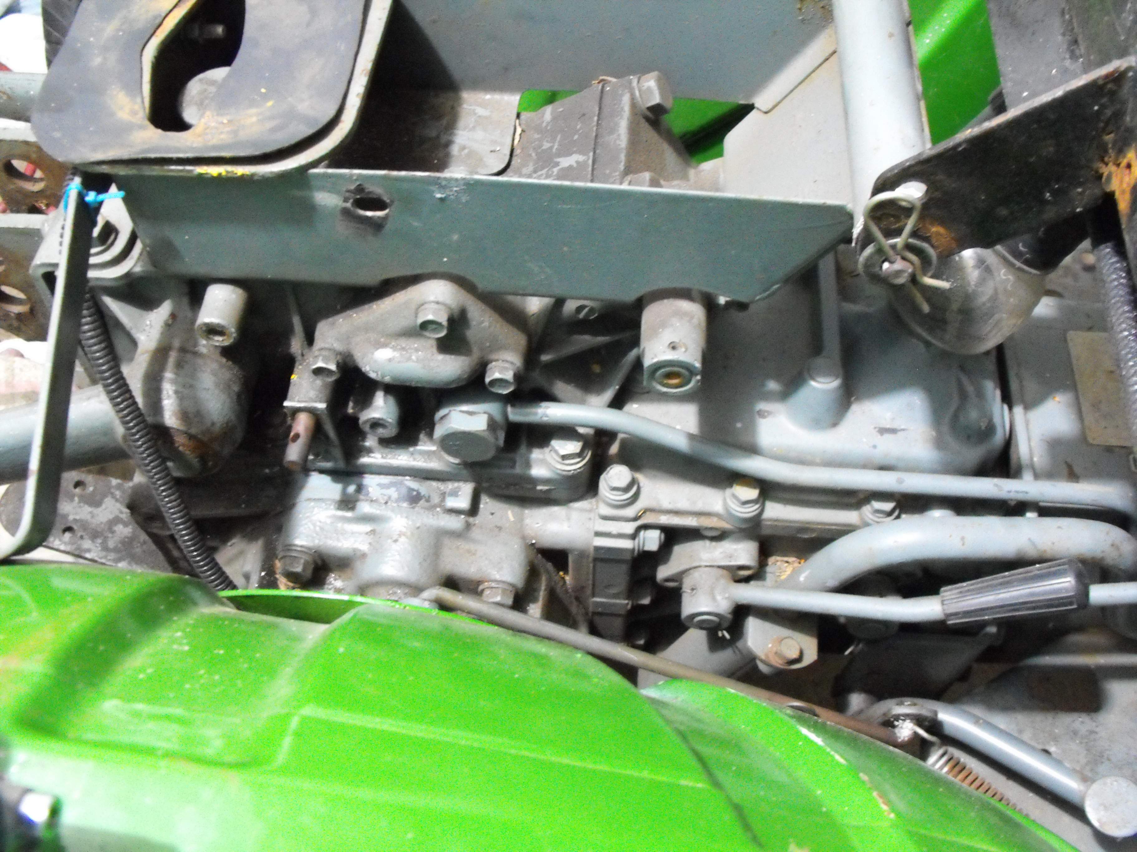

I need to find out something about these ISEKI tractors...I think this be the best place to ask....the repair manual states some G-174 model....only require #90 rearaxle oil...I know my tractor has an internal hydraulic/tank system that operates the hydraulic 3 pt.....what kind of system do the other models have....I'm just curious to find out....cause I'm thinking of just using the exsisting hydraulic pump that runs of the side of the engine and mounting an external tank somewhere on my tractor....It's too confusing with the internal factory hydraulic setup...I'm still having an issue connecting my two hydraulic snowblade cylinders.....thanks in advance<<>>>Ampa
   / ISEKI steel Hydraulic lines Question ?
#13
I know all hydraulic systems all require the use of hydraulic oil...but are your hydraulics part of the trans/axle case/housing...or should I say.... all internal...for example the valve/tank ... my G-174 ISEKI...has an internal system....this is why I 'm havin' issues settin' up a auxillary to run my new front mounted 48" snowblades operational lift and angle using the tractor on line hydraulic system....which to OP don't seem to be much of a problem..
the OP keep referring ther are two high "P" lines....one in and one out as a pressure release on my double valve.... I'm usin' double action cylinders/rams....I'm only using a single double acting cylinder for the angle operation of this ATV type snowblade....there is really no effort on turning it right and left I can turn it with one finger... my setup requires only one single double acting type cylinder/ram....
this is the main reason I posted the question....I've got everyone on the hydraulic section confused because they no very little or nothing about these greymarket ISEKI tractors...I need to find someone who has done this setup correctly so I can find out how it was done...instead of having some guess maybe I should do this or maybe that...not their fault at all and I'm not knocking anyone for it...believe me...
I was told politely from someone here to post my issue on the hydraulic section of TBN...and I did get a lot of help but also caused a lot of confusion because of the brand of tractor I own....so now I'm back to sqauare one....I have a bunch of pics of my project and will post all of them......thank you so much for your input and quick replay....take care....Ampa

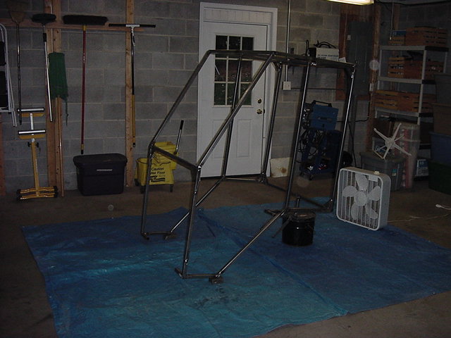

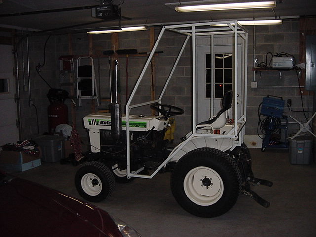

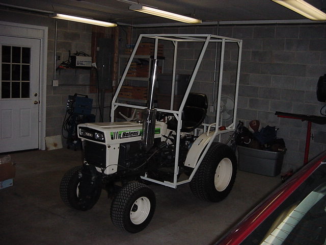

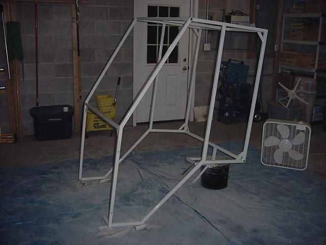

I cant believe I actually found someone in the EXACT same boat as me. I just joined this forum after searching the internet for info on adding hydraulics to my Bolens Iseki G152. Im in the process of purchasing either a plow or snowblower. But im gonna need front hydraulics to raise or lower it. This thread verified exactly what I expected to have to do to add my live hydraulics. I am also in the process of building/designing my own snow cab. Pictures to follow.

<> Hi amanda..... very nice neat lookin' cab frame so far....your tractor looks like brand new as well...soon as I get back to this project of mine..
