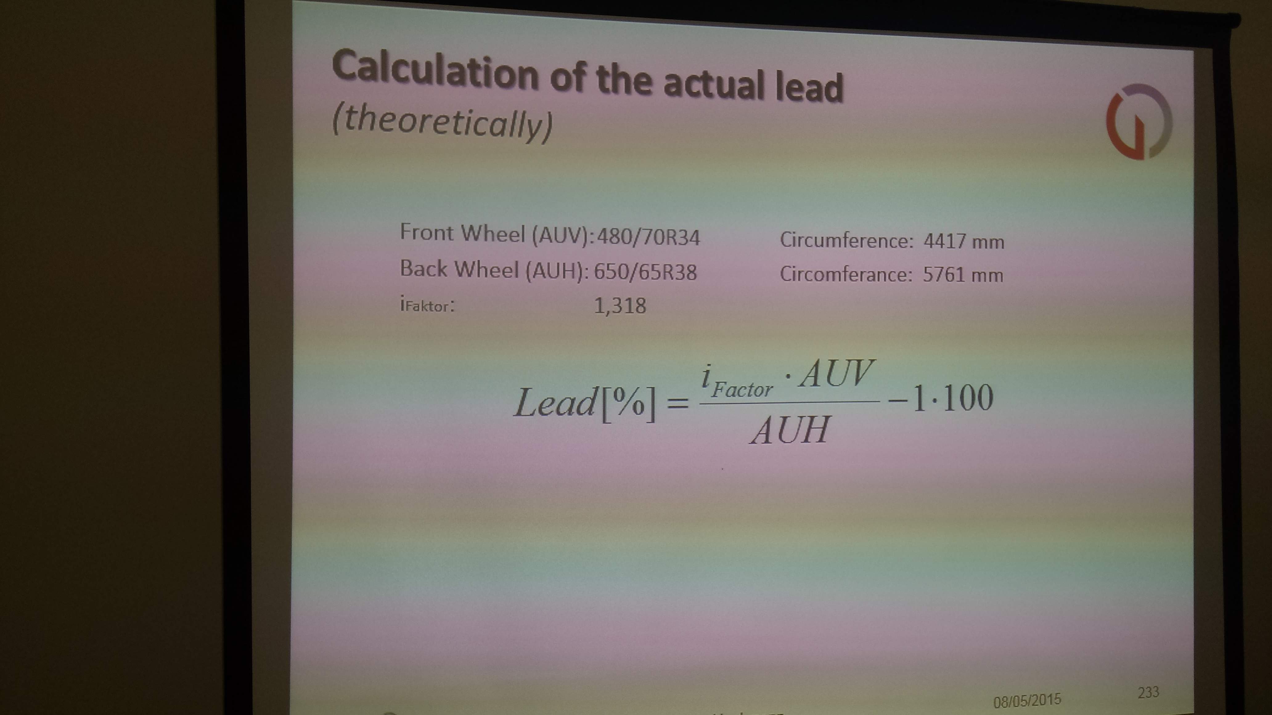

In order to calculate the lead I need to know the "i Factor" of the tractor. Do you know that?
   / ISEKI TA 357 LANDLEADER #24
Here is the formula to calculate the lead.
