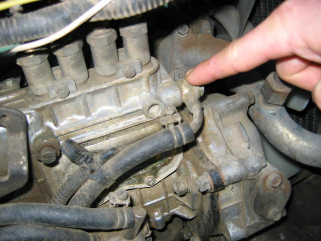

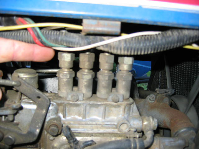

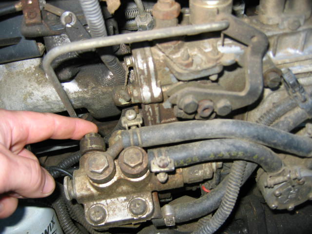

do not take the pump apart!!!!!!!..u have air in yer injector pump!!!!!!!...loosen all injectors top nuts...almost off 1/2 turn left..... bleed to injectr pump real well.....then tighten injector inlet hose....bleed just on top of all injector lines on outgoing side real well...then do the top of injector nuts.....I am a pretty good wrench and have worked on mercedes..westerbeke...cats...detroits...volvopenta's... gm's...volkswagens...fords...jist to mame a few and my iseki tl3201 with a4 cyl isuzu diesel was by far the most difficult to gitt completely bled...cut sat 4... 2 weeks this past winter while i fought with it!!!!! ended puttin rag in fuel tank fill hole..puttin in my blow gun and hittin it with air while bleeding all of the above spots....needed 2 people to do it..pumped the primer pum till blue to ...to no avail...if u still can't git it pm me and i'll give u my telly #.....was a total bear!!!
bleed to fuel pump real well first....intake side...the problem i felt was in th e filter area on my particular iseki...after runnin out of fuel it jist didnt wast to fiil see thru filter agin...hence the air on the tank....then bled to intake side of fuel pump real well..

then i bled to intake of injector pump real well!!

then output side of all 4 injectors !!!!!REAL WELL!!!!!!

THEN i bled to the injector nuts..i actually could'nt reach the back 2 so just did the front 2..but all 4 on the output sid e of the injector pump were givin me fuel!!!..good luck bud !!!!
!!!!I KNOW ONE THING!!!!! WILL NEVER LET MINE RUNOUT OF FUEL AGIN!!! BET U WON'T EITHER!!!!!
