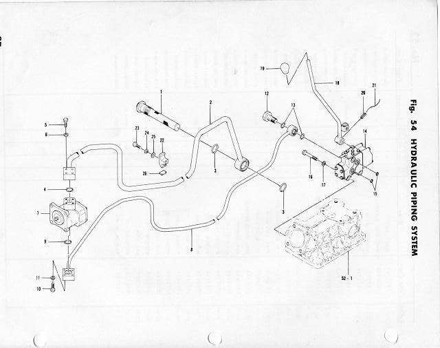

If I recall right its just forward of the rear axle, right side, follow the suction line from the pump back

Hi Marcle!
I'll see if I can find a diagram for you. How have things been across the pond this winter?
Not checked mine as it very wet and windy outside. Is this on the gearbox or the pump?
Thanks :)

Hi Marcle!
Hi Mitch,
Thanks for diagram.
