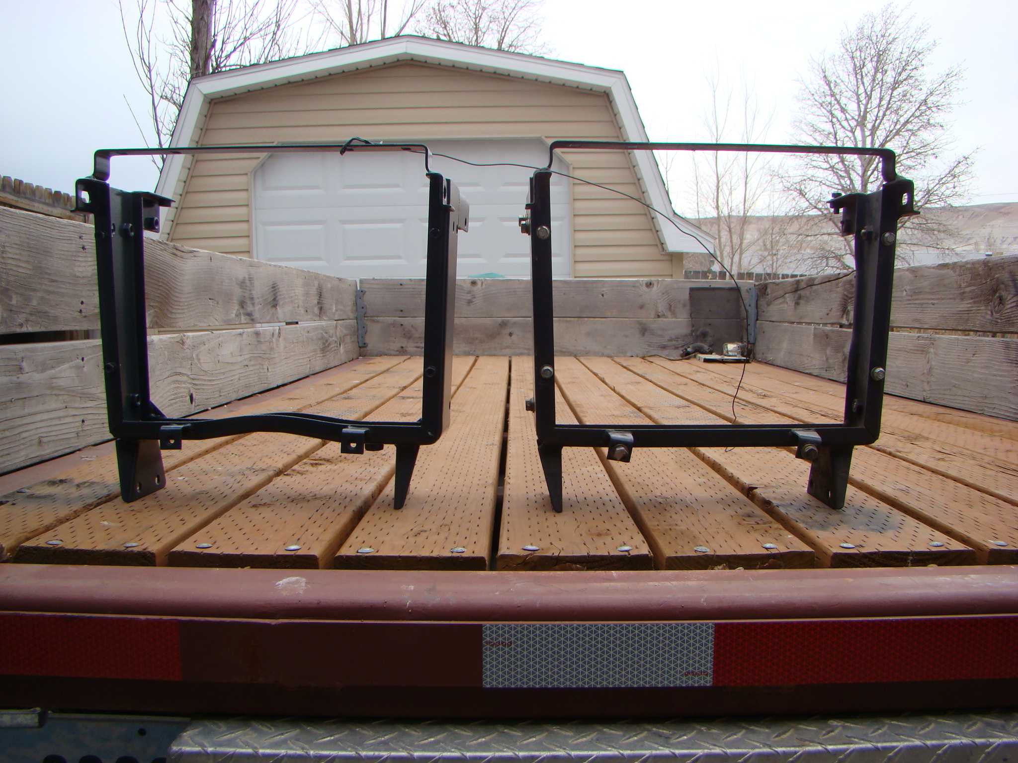

Thought I'd post this for those thinking about installing a front PTO. I ran into a slight problem with the one on the KE75. When I first installed the original radiator and radiator frame from the TX1300 I noticed there wasn't much clearance between the PTO and the frame. Later, I saw it was actually rubbing due to flexing of the frame. After further investigation, I noticed the radiator frame from the G172 had a pressed arch in the bottom to allow for the PTO (see pic). I'm in the process of swapping it now. One other thing, at least in my case - the front bolt pattern that bolts the radiator frame to the front axle/engine frame is closer together on the G172 for some reason. I'll need to drill new holes that are about one diameter wider towards the front of the machine to make them line up with the TX1300 engine frame holes. Please consider these things when adding a front PTO.
