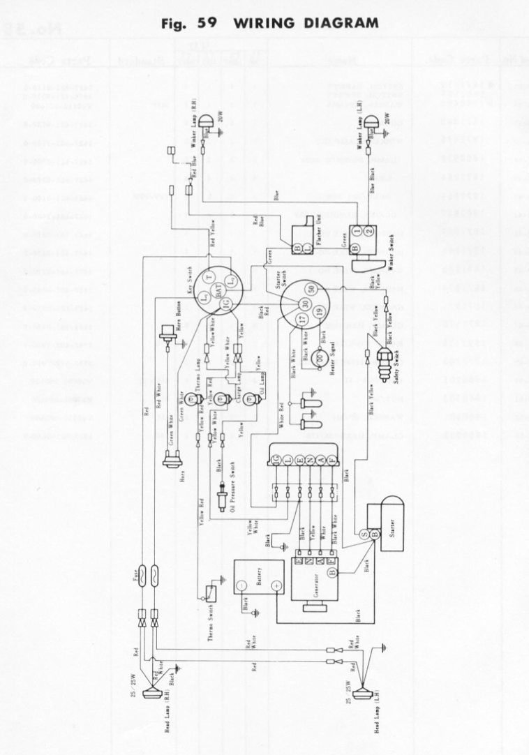

Hi fxrs55 i dont suppose you have a detailed wiring diagram for a tx1500f and tx1510 only when i got my tx1500f tractor off of the "e" action site it had homemade wiring and i have got hold of a tx1510 wiring harness so i need to know the colours and the difference in colours that go to the same places
   / Iseki tx1300f looking for engine repair manual #28
This is what i have on the tx1300F (identical).

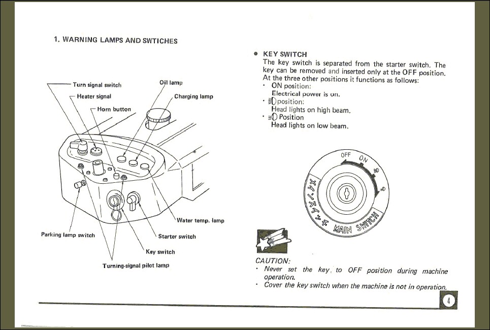

   / Iseki tx1300f looking for engine repair manual #30
here is one with more lights on the dash. turn signal pilot lamp and
parking lamp switch.
