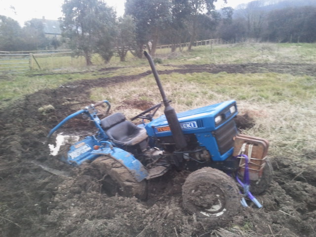

Hi Mitch,
Pulled the tractor out tonight, but ran out of light to get it back to the barn and washed down. Took some pulling to get it out, full two tonne pull didn't do it, so had to do a whole lot of digging and loosening up the mud to get it to pull free, quite amazing how stick deep mud is.
haven't been able to inspect anything yet, it is not the wheel centre pins though, they are still there. Not the clutch as far as can tell so far, plenty of power going to the PTO. The strange thing is the lack of noise from the gearbox or transaxle, I would have expected some grinding noise if the splines or a shaft had sheared - my suspicion is that it is something to do with the diff lock as it had been acting up, but I'm not sure without drawings or pulling it apart whether its even possible for it to disengage both sides of the axle. If I'm really lucky, once the 1/2 tonne of mud comes off it could free something up, but I just can't think of anything that could be affected in this way - there is always hope though!
Will update once its clean! Dan
Photo of the tractor just before I pulled it out - you can see the force of the pull actually bent the front weight rack!
