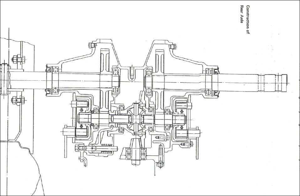

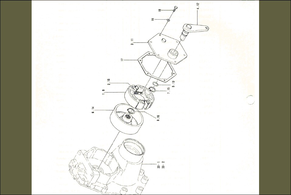

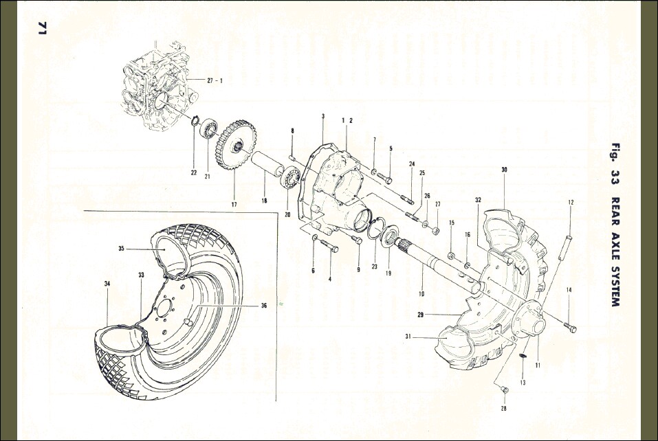

Here are a few schematics for a TX1300F I'm not sure how
close they are to your tractor

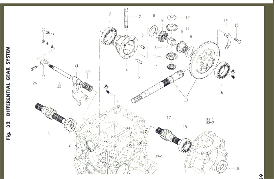

I have been looking at the schematics and it looks like
pinion shafts 1 and 17 go into diff gear #9 which I have
always referred to as spider gears. If you have any
experience with automotive differential Items #1 and #17
would be the same as the axles in a rear wheel drive car.
Item #21 is the diff lock shifter fork and it goes over
item #2 which is what locks the diff. If you look close
at item #2 you will see 2 drive dogs on the side and I
think when the diff lock is on item #2 is engaged to
the end of item #4 which is the diff case. That then
would lock both pinion shafts together. When diff is
not locked then one wheel or other could spin. Part of
how that works is through items #11 which is also
referred to as a pinion gear which I know as spider
gears also. Now you said that you had a bang when
you disengaged the diff and then another
and then no drive. If you drive around with the diff
locked and you make sharp turns you are going to
stress all 4 of those spider gears until they break.
With the diff locked and you go around a sharp
turn the inside tire has to go as fast as the outside
tire or at least it needs to slid or spin but if
both tire have good traction then something will
eventually give out. The item numbers I've referenced
are on fig 32 above in post #12
