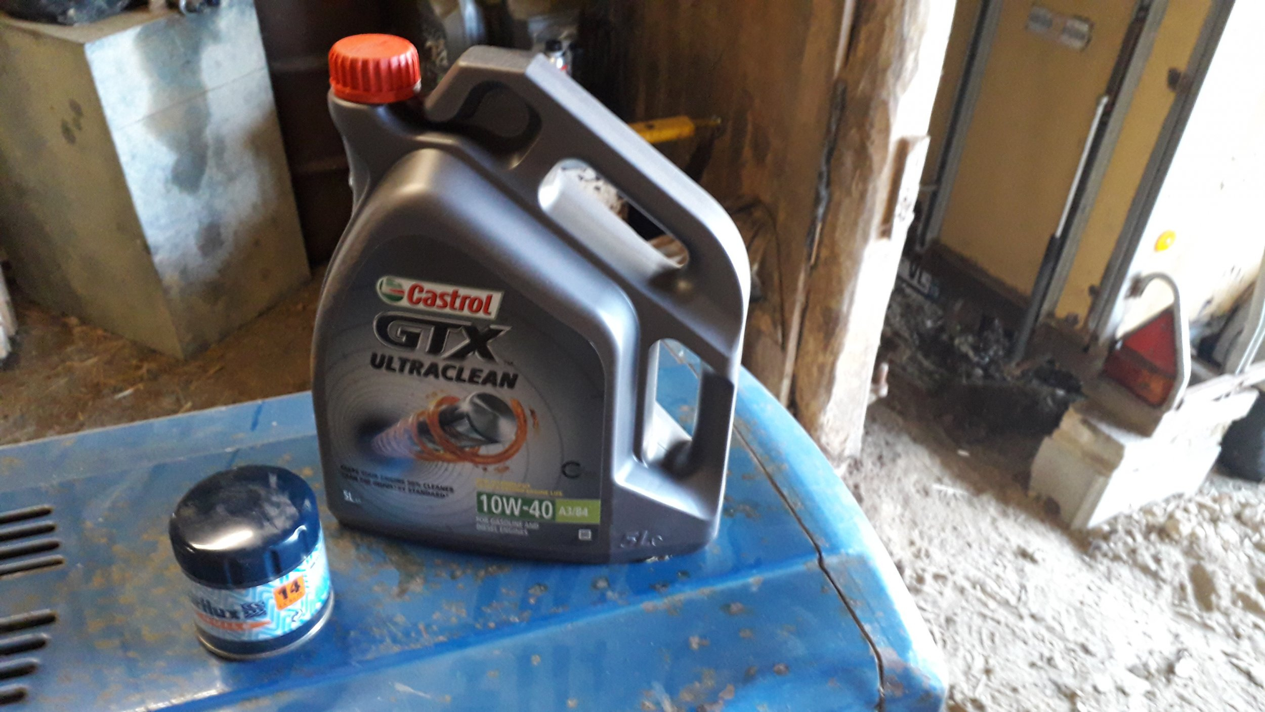

Also switched from low-budget-horse-piss-SAE30 (prejudism) to a solid well paid for 10W40 oil, and for the moment all seems fine again! Did a very long job today for 3 hours in the fields and coming back into the garage, running stationairy as a sunshine without oil pressure light coming on. Wauw. It's been a while :cool:

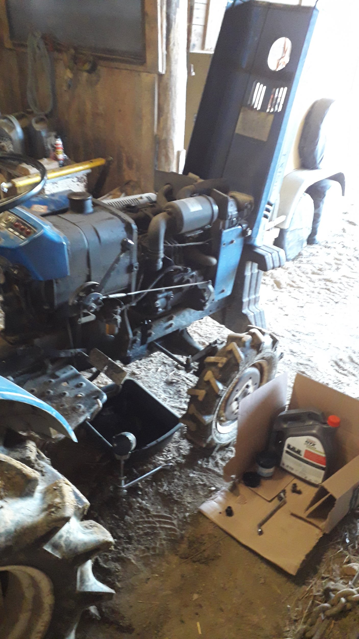

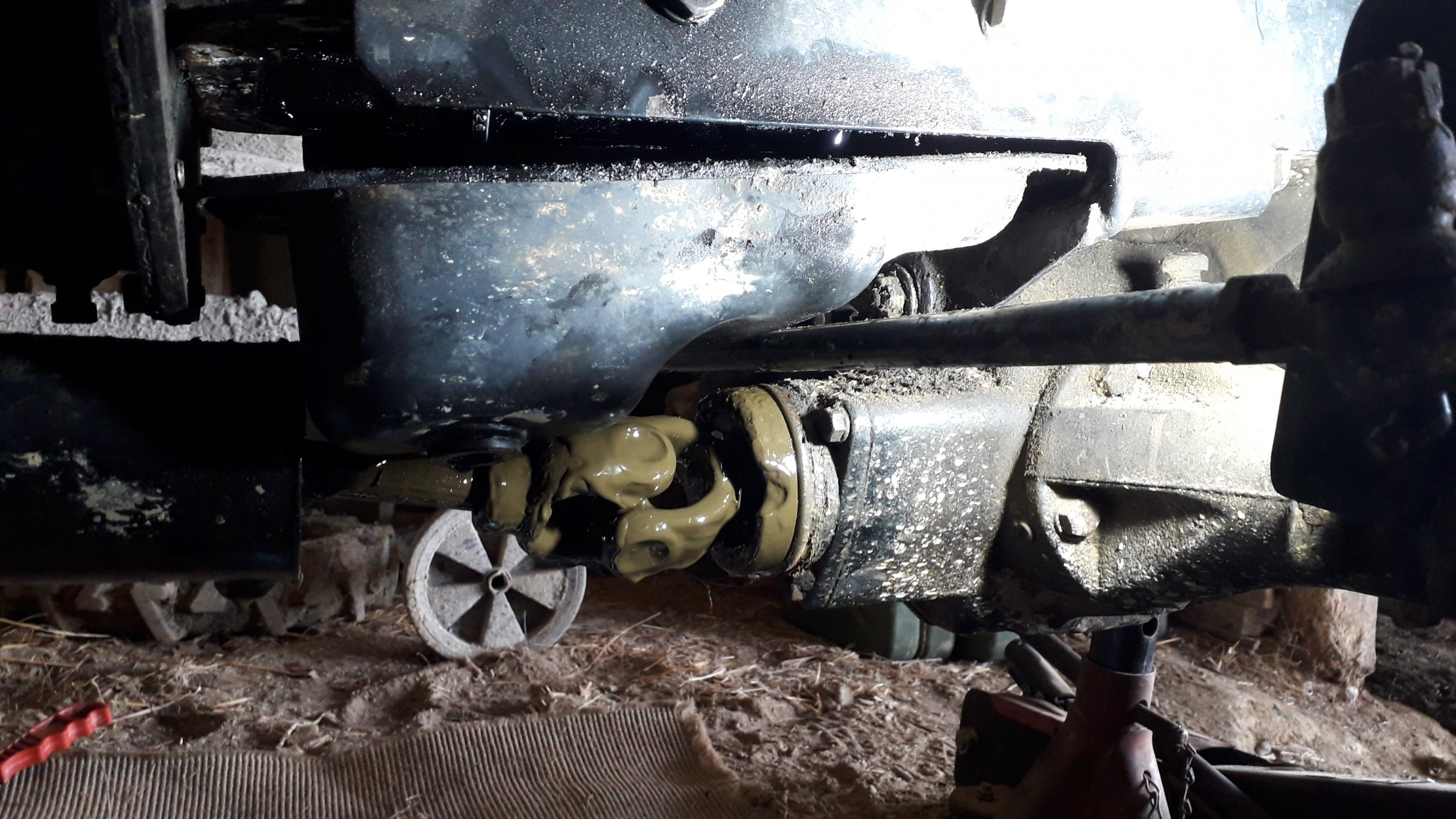

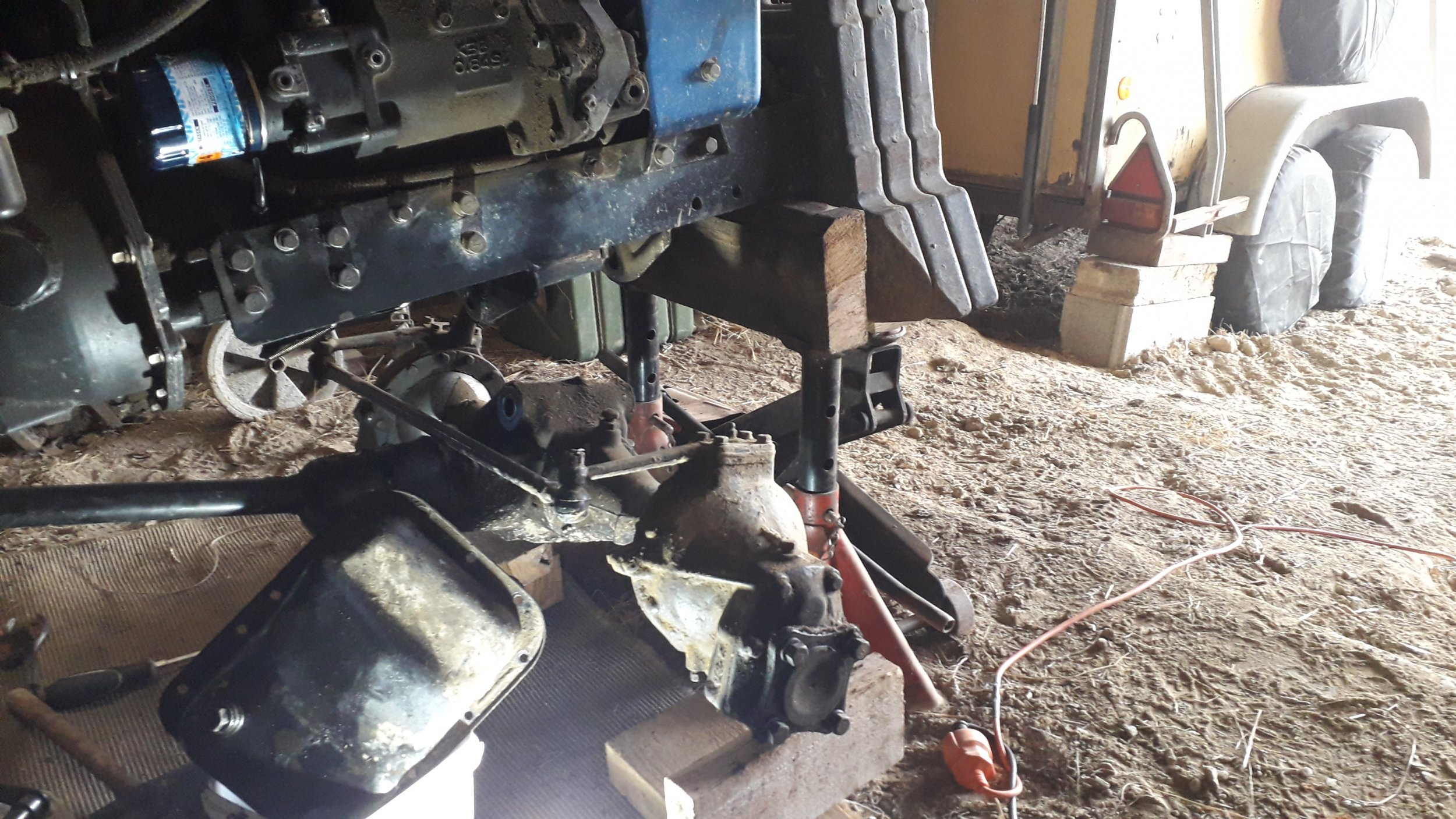

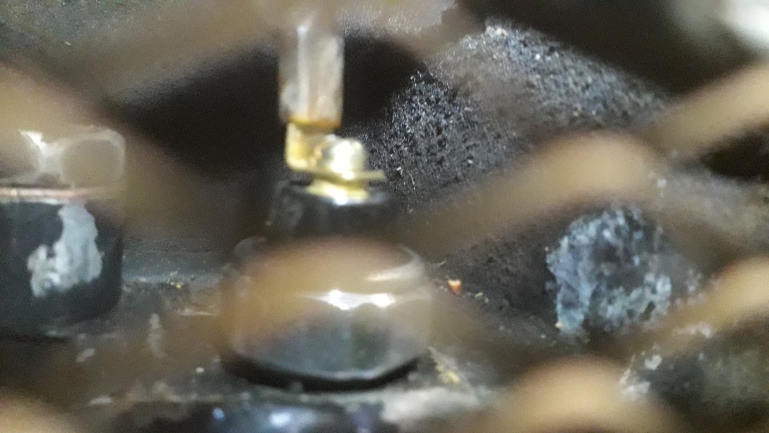

I hope this is my last update on the matter. AGAIN oil pressure light came on now even after 15min of only light work. Took down the front axel in order to remove carter. Inspected oil inlet filter (a spring lightly forced open acts like a filter!) and removed oilfilter and then finally the trochoid-type oil pump. Cleaned outsides thouroughly before taking out the pressure valve.
My theory was that if this valve opens above 7bar but does manage to shut again when pressure drops at low revs and a hot engine, the pressure fails totally.
Could not find anything really wrong so cleaned it and reassembled it with lots of clean oil. Then after blowing clear carefully the pump inlet channel with compressed air, I had no options left and assembled it all. To my big surprise it makes all the difference!!! The problem is gone.
Coming weeks I'll be driving around with an improvised manometer but this is only a precausion not to be emptyhanded if the problem reoccurs.

After weeks monitoring oilpressure I was convinced it was always above 2 bar pressure, even on low revs and very very hot. I put back the original pressure switch and at first things looked okay, until I had some really challenging mowing to do and there the light came on again :-(
So now I finally ordered a new switch (ref. TP13109 at tractorpartz.com for 39€ home delivered) and continued my steep-climbing-while-mowing job and it did not light up.
==>> so in the end I can only draw the conclusion it has been a combined problem of over-pressure release valve not properly returning when hot, and a switch failing when hot. We learn as we go......
