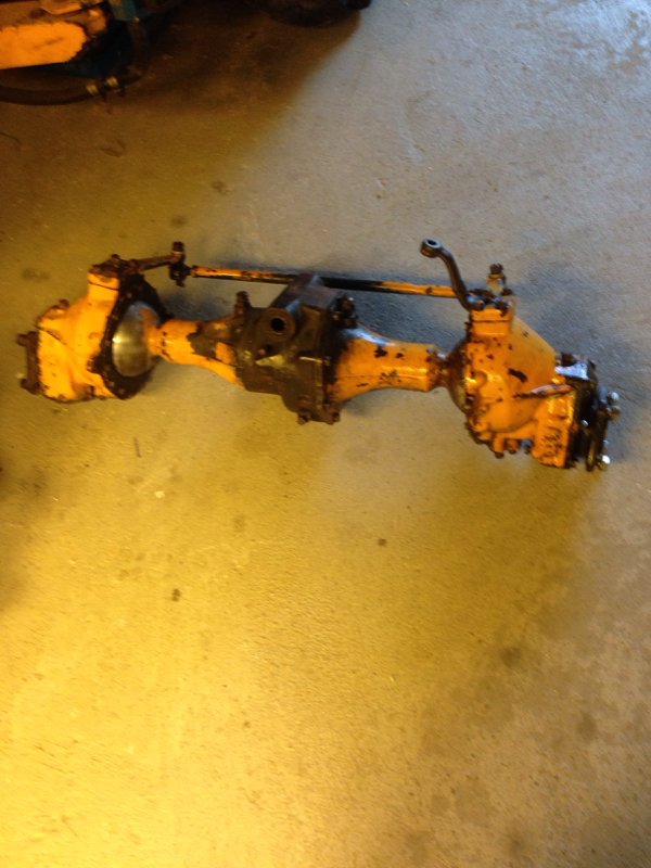

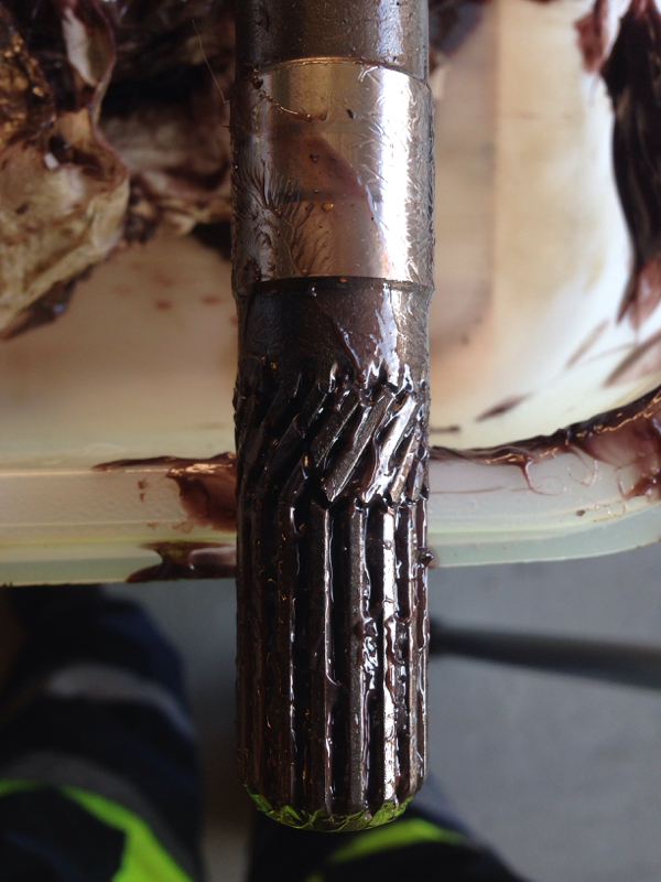

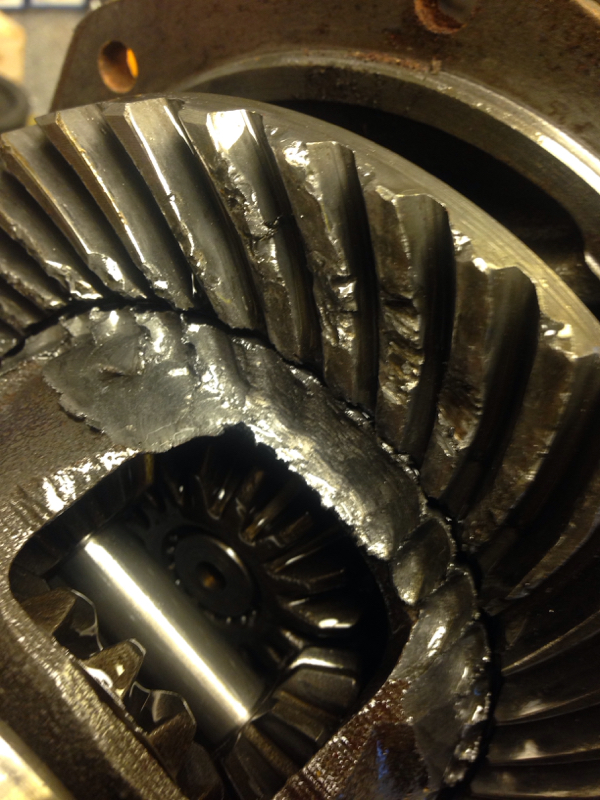

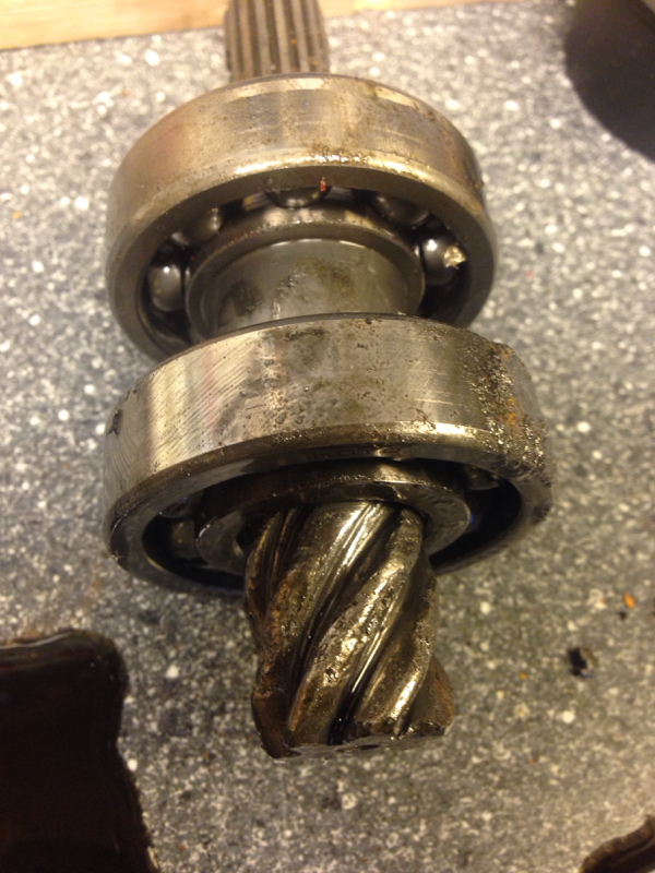

Well, some things take time. Finally opened up the front axle, and almost puked my guts out.

left joint broken, shaft bad, pinion eaten parts of crown wheel. And yes, this made a bad sound. Ripped out all the bad parts, and at the moment i have converted my 4 wd into a 2 wd. The good part of this tragedy, is that i can use the little lady again. Think the parts will be hard to find. Any good suggestions, guys??
