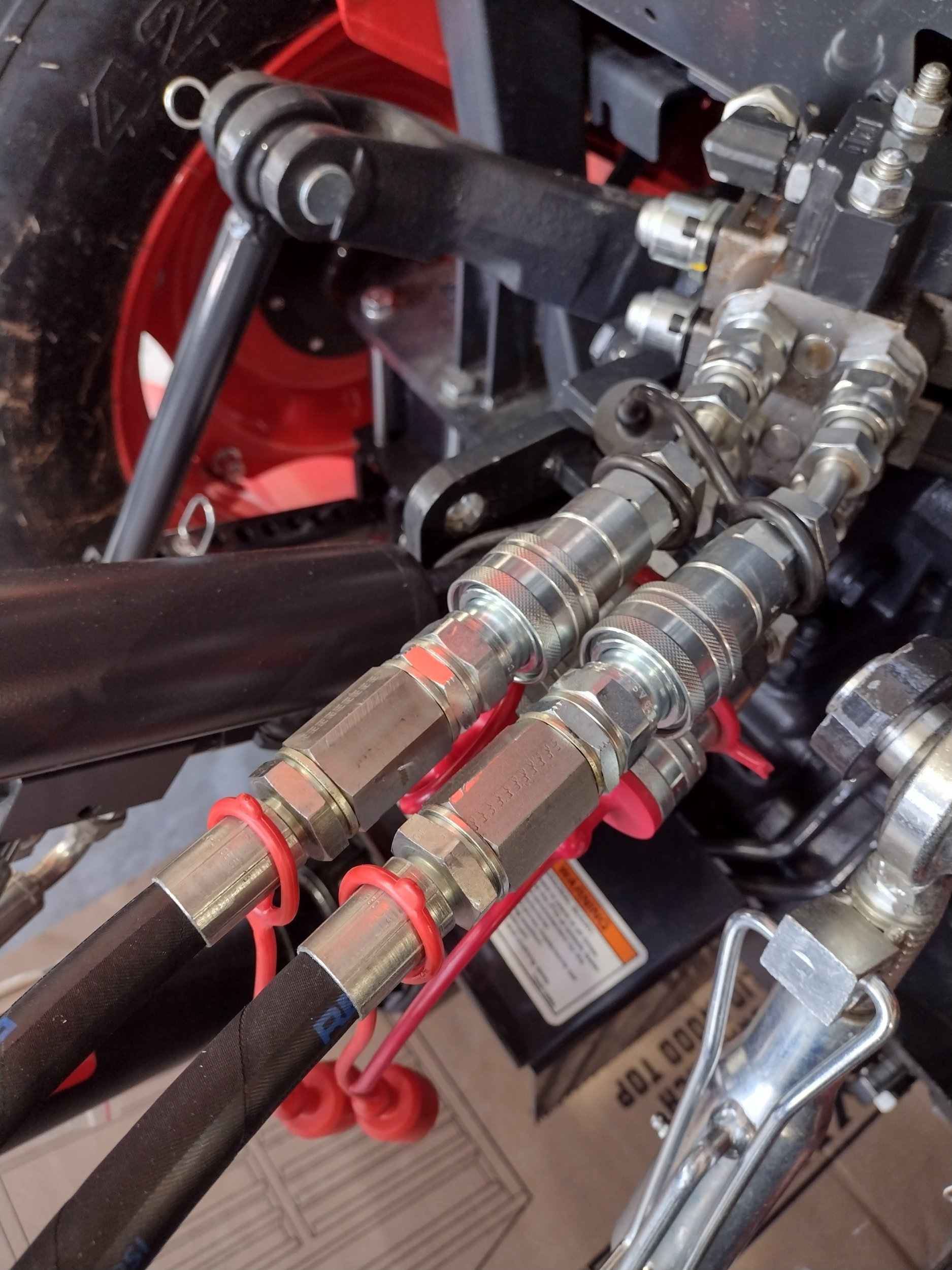

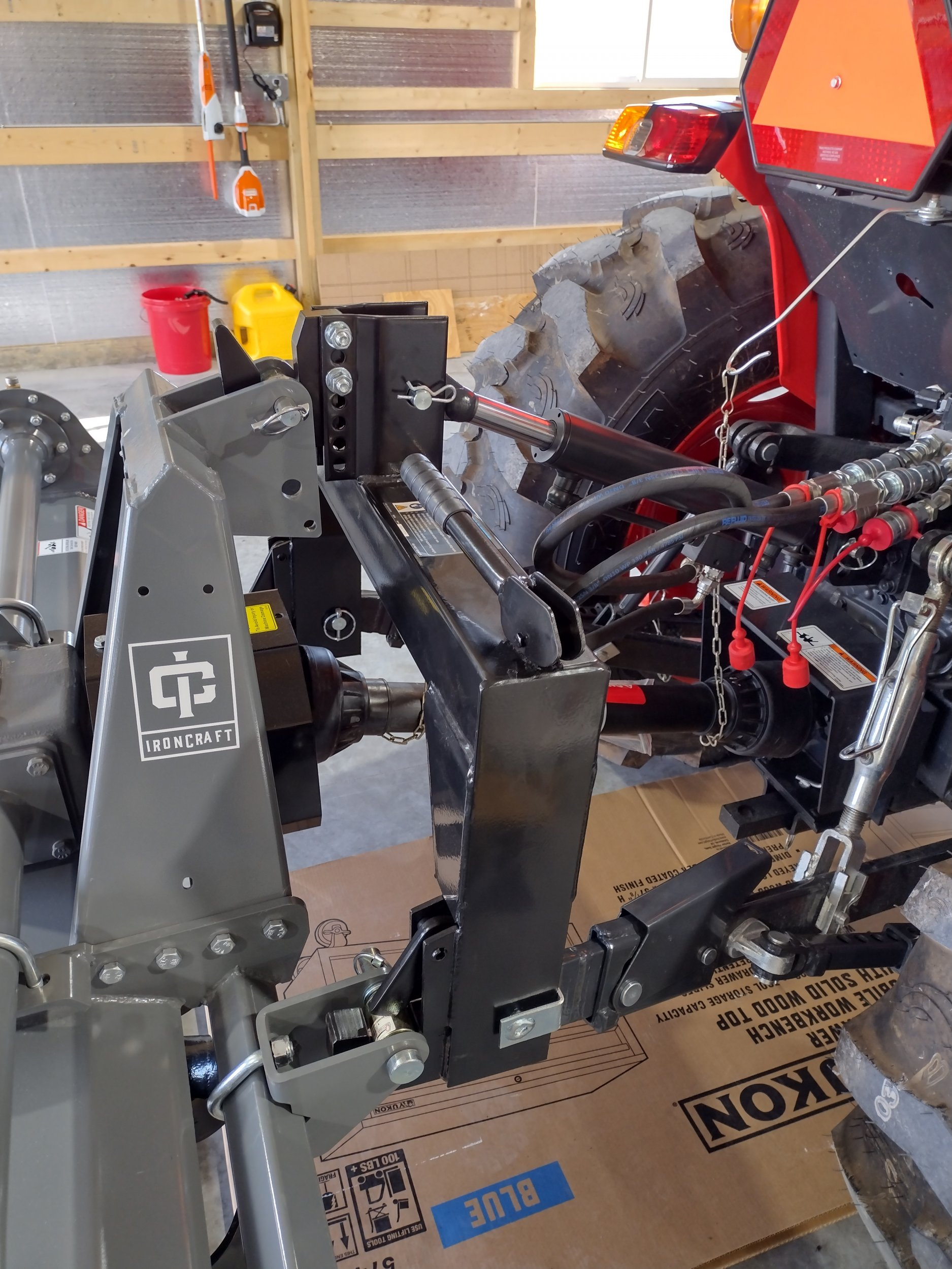

Hoping to get the hydraulic restrictors placed in the top link lines this weekend… maybe even get the QH on

Are we to expect pictures and maybe a brief description of the installation?
Yessir. I’ll need to grab a few copper crush washers to complete the job. Maybe I can get the daughter to take a before and after video as well of the movement/speed

Well I got the hydraulic restrictors installed!!! Amazing performance now. No more jerky action and choppy extension.
I installed a couple 1/2" BSP restrictors with .03125 orifices, new Dowty sealing washers and 1/2" BSP couplers. Such a clean install!
Also got the quick hitch on today!

I can’t post the video here, bummer. It is so smooth and controlled even with the remote lever full deflection
