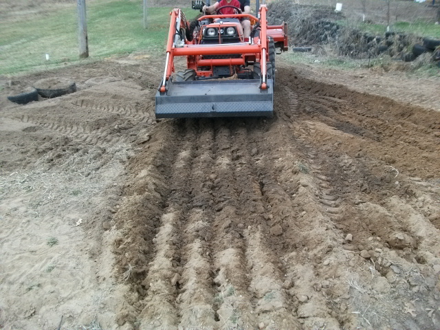

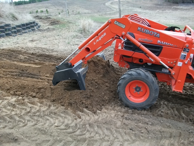

I use my Loader Buddy with the teeth down all the time. For ten years I have done this. I always go in low gear when working in dirt. I use LB on a 45HP tractor and a 30HP tractor with comparable results. The attached pics show the 30HP tractor working in reverse. I feel it is important to know the limits of your machine and techniques of FEL operation. I use just enough throttle to get the work done and maintain the "feel" that one develops with experience. With my Loader Buddy I find this superior to a box blade as I have better dexterity, down pressure, visibility and the ability to target problem areas with surgical precision. Back dragging with the sharp bucket heel produces very level surfaces in the end. I might add that I would NOT do this with a standard bucket because the physics are all wrong for the desired effect.
