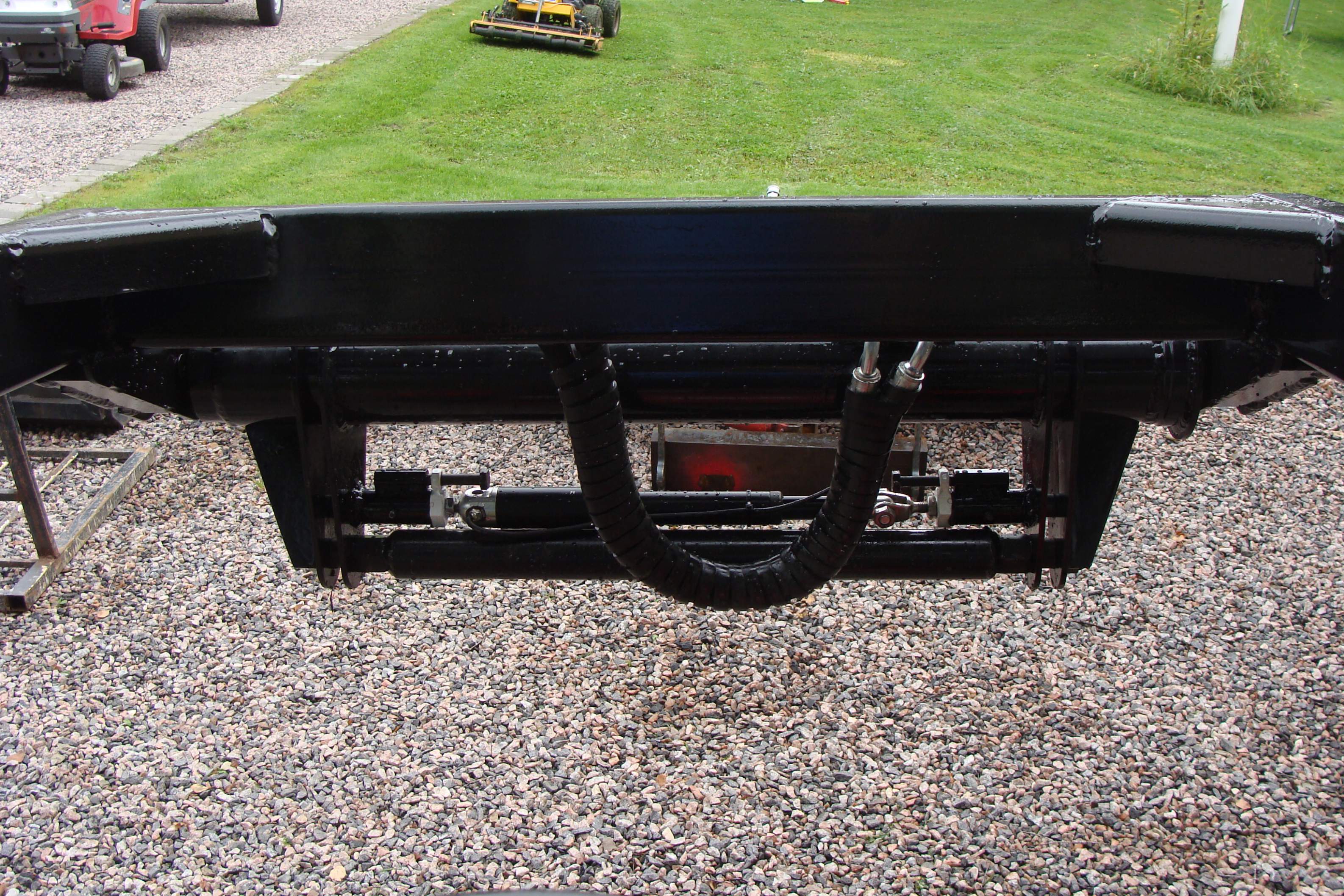

Self leveling? Looks like the dump ram may be tied into the circuit with the second ram on the LH side so that as it lifts, it shifts the amount of fluid in the dump ram??
Aaron Z
   / It was a TORO GROUNDSMASTER 217D
#23

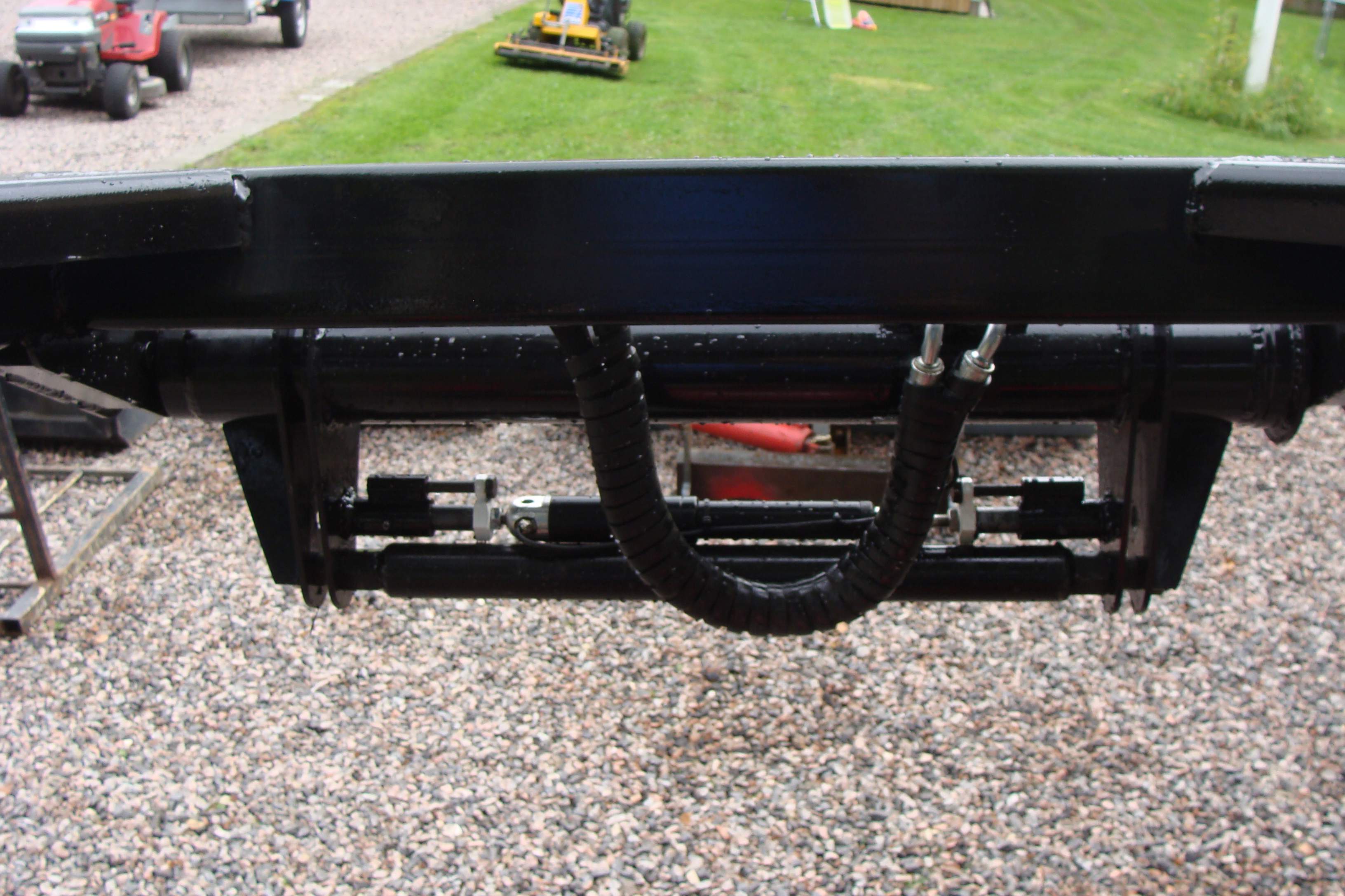

Yes, it is connected to the tilt cylinder. When lifting it will keep the angle of the bucket constant. A good thing when using forks.
This summer I also finished an electric lock using an actuator:
This video shows both the electric locking pins and parallel movement when lifting.

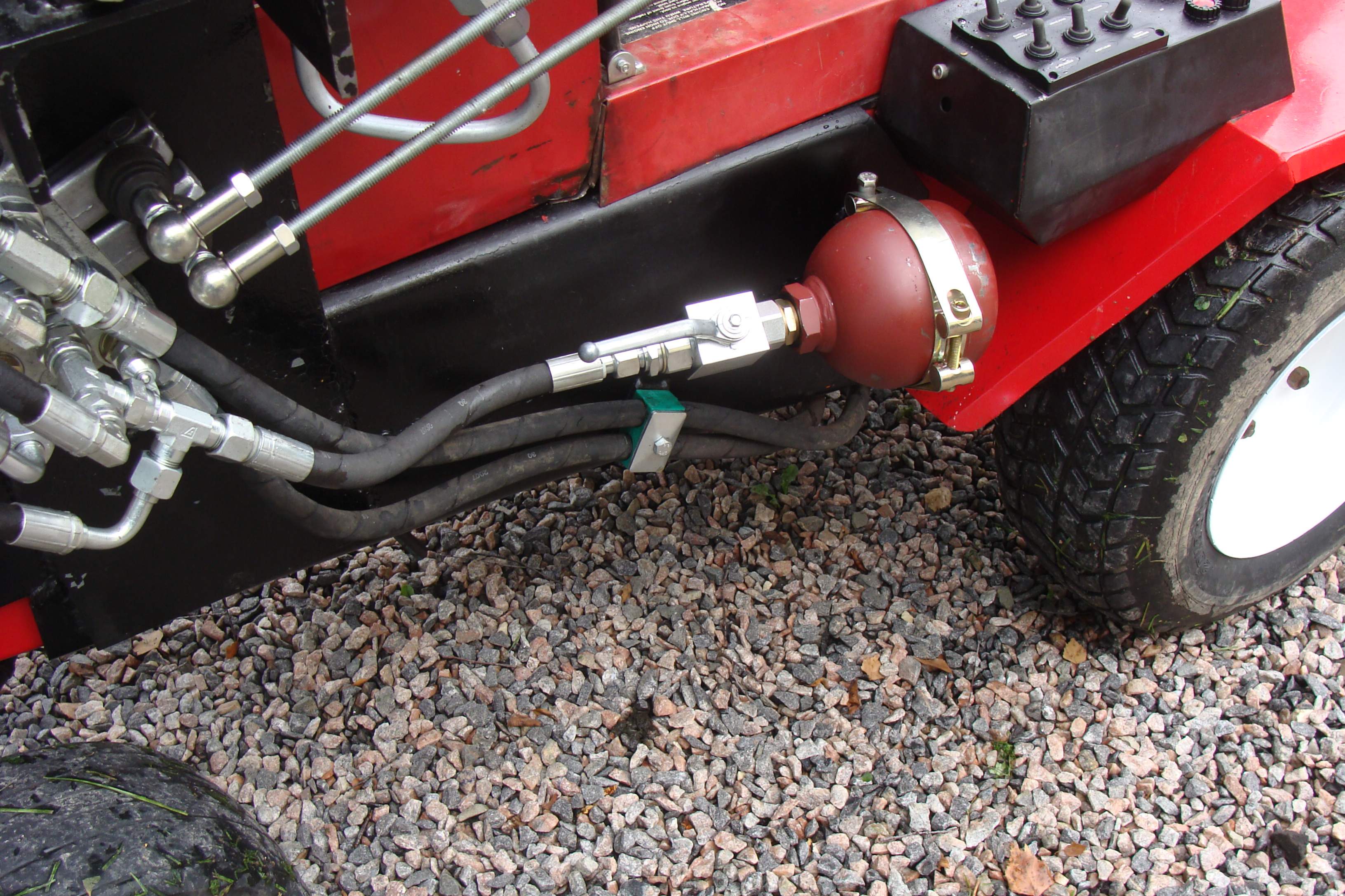

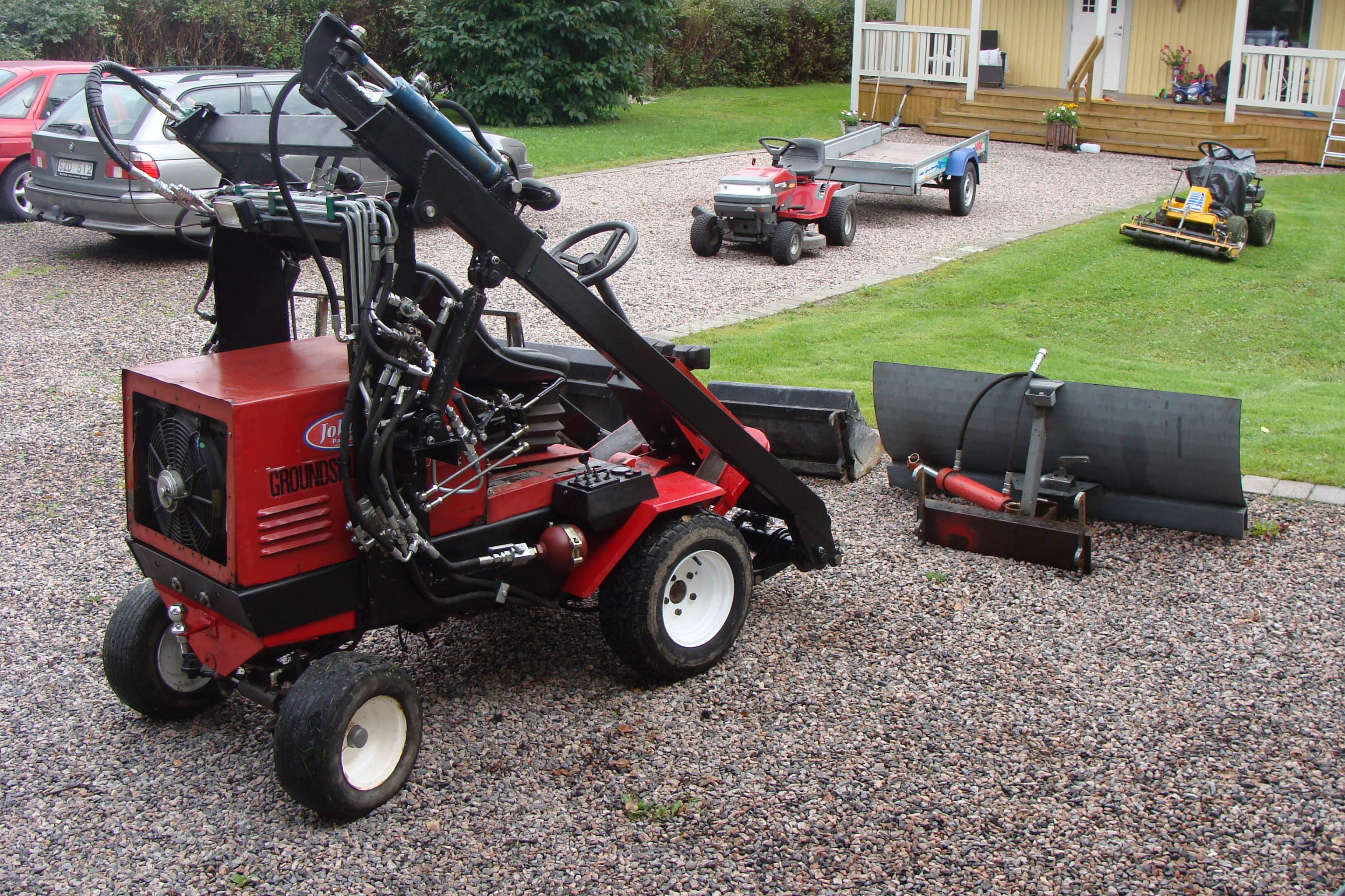

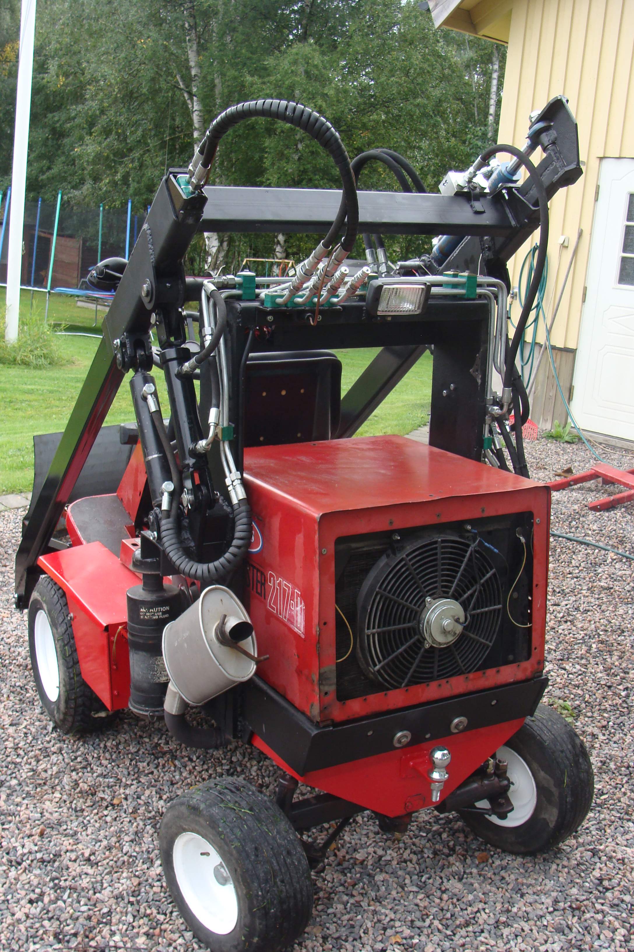

Here on the right side you see all hydraulic controls.
The front lever closest to the seat is the XY-lever controling both lift and tilt.
Just behind is a lever that switch the tilt function over as an external function at the back of the tower. The hoses in the left lifting arm are connected to those ports. I use this to turn the snow blade.
Beside those ports there are two more, one is tank return, and the other is pump pressure after the main valve body for lift and tilt. By moving the hoses I can select functionality of the ports at the front.
Tank and pump ports are 'shorted' with a ball valve located just in front of the lift cylinder. The handle is pointing to the lifting cylinder in the picture. By closing that valve all unused oil is forced to the pump port at the back of the tower and can be used to drive an hydraulic motor without using the tilt lever.
There is one more ball valve behind the lifting cylinder and that handle is pointing up. By opening that valve the lowering side of the lifting cylinders are connected to the tank return line. That makes the lifting cylinders working as lift only and the bucket or snow blade can 'float' on the ground.
The last ball valve is located low on the side behind the red accumulator ball. that is connected to the lifting side of the lifting cylinders and that makes the lifting arms 'float' when driving with lifted load.

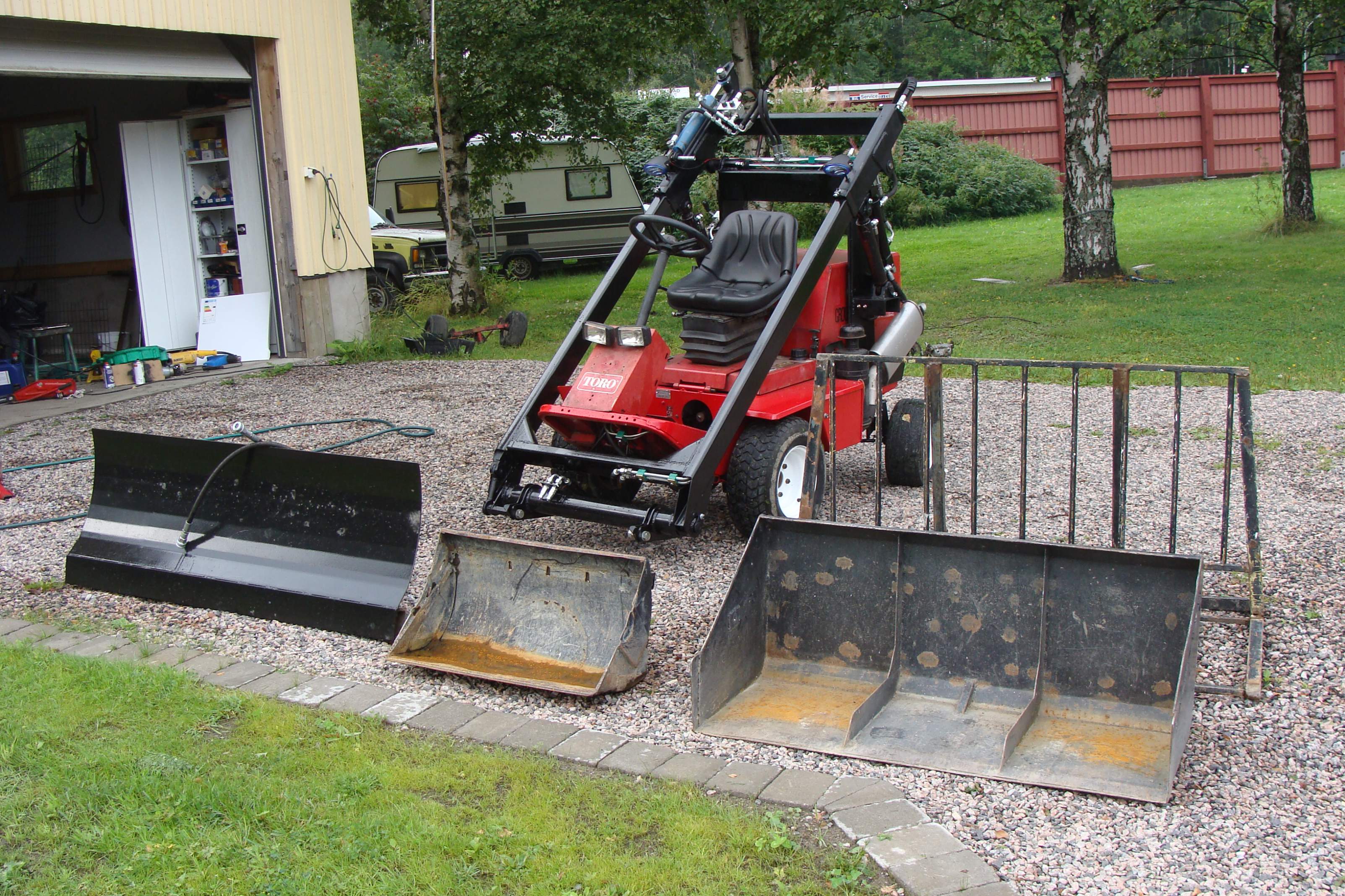

A video using the tilt as external function with the snow blade.

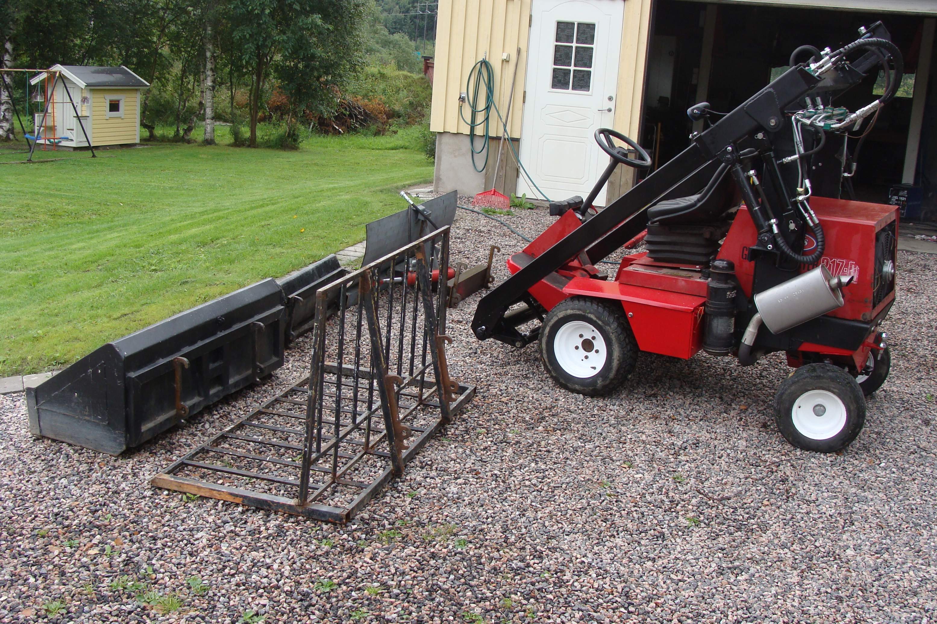

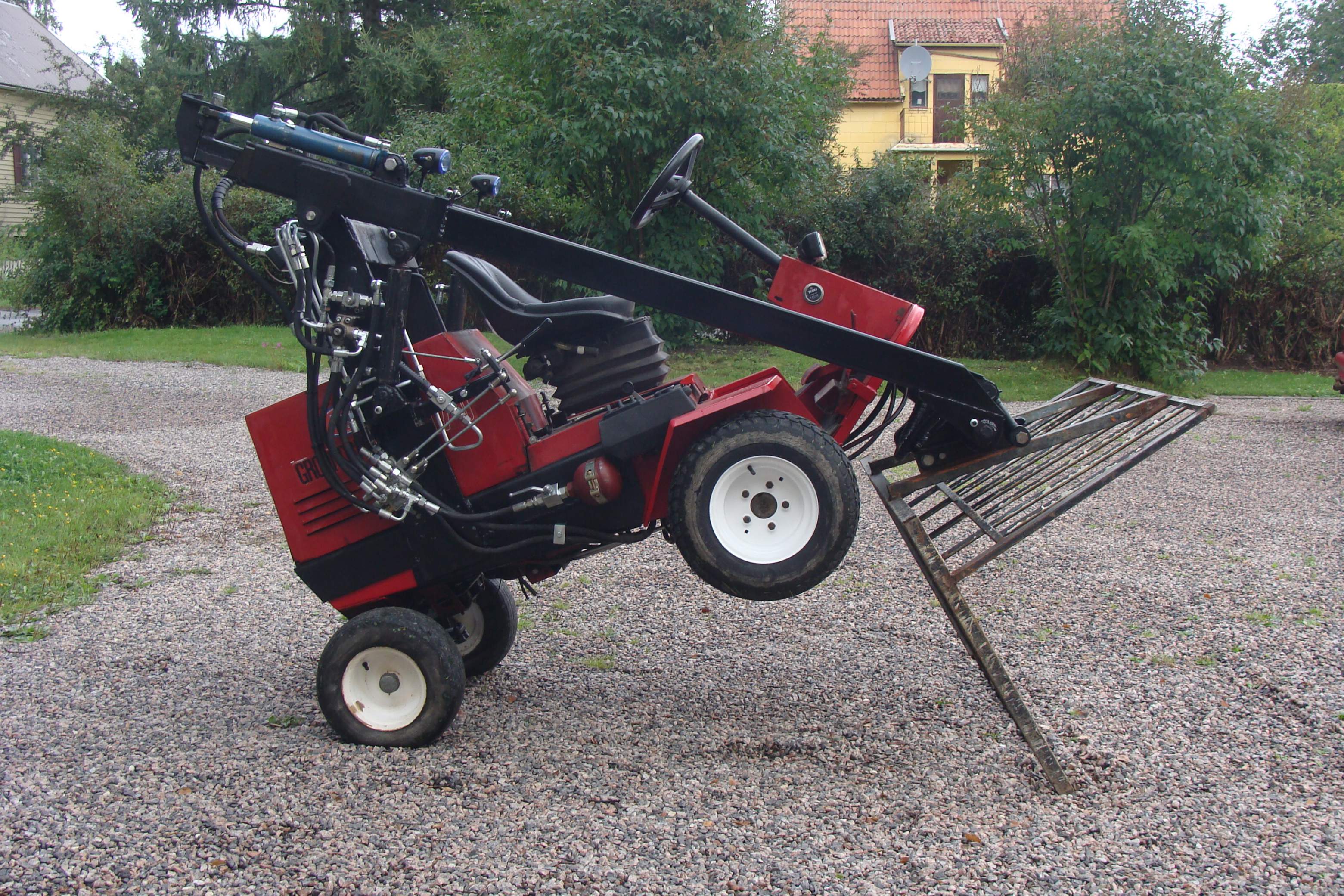

And some more pictures.
