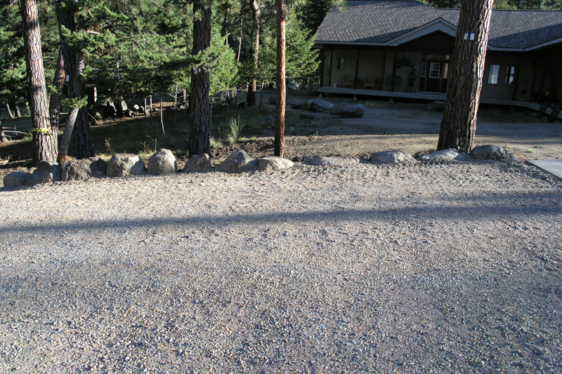

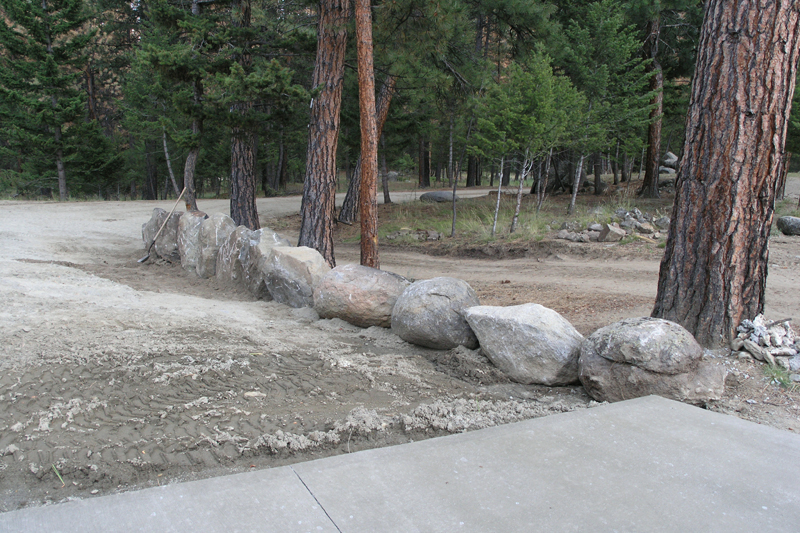

Bigballer - sorry I did not get back to you right away. We took some time off to visit my new grand daughter before the weather turned nasty.
You are right, placing rocks on a "wall" would be tough. My wall was a retaining wall of single big rocks so I could raise the level of my driveway. Here is the before and after pictures. Raising the road made it much nicer to drive on. The grapple was a must have tool for this job.

I'd probably call those small boulders...! And your machine is 100% bad ***. I have no use for anything that hardcore, but I'd like to have it anyway! Sweet.

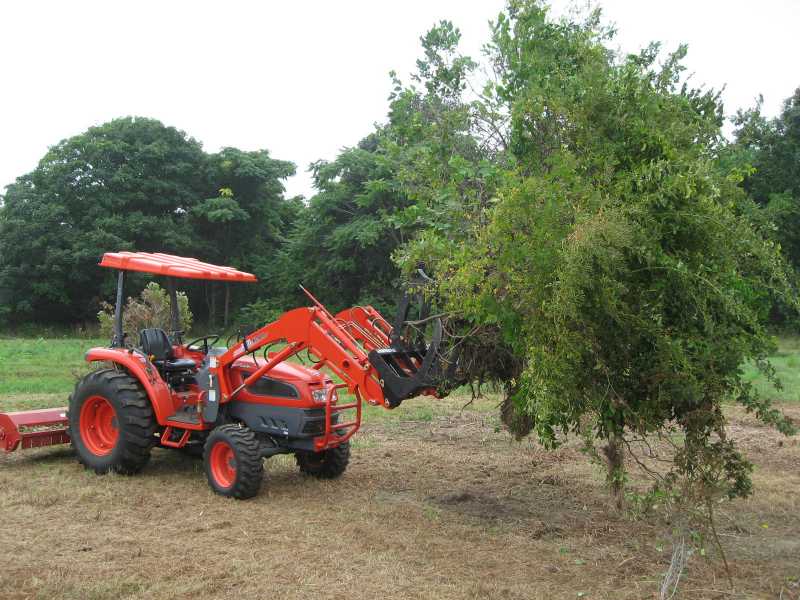

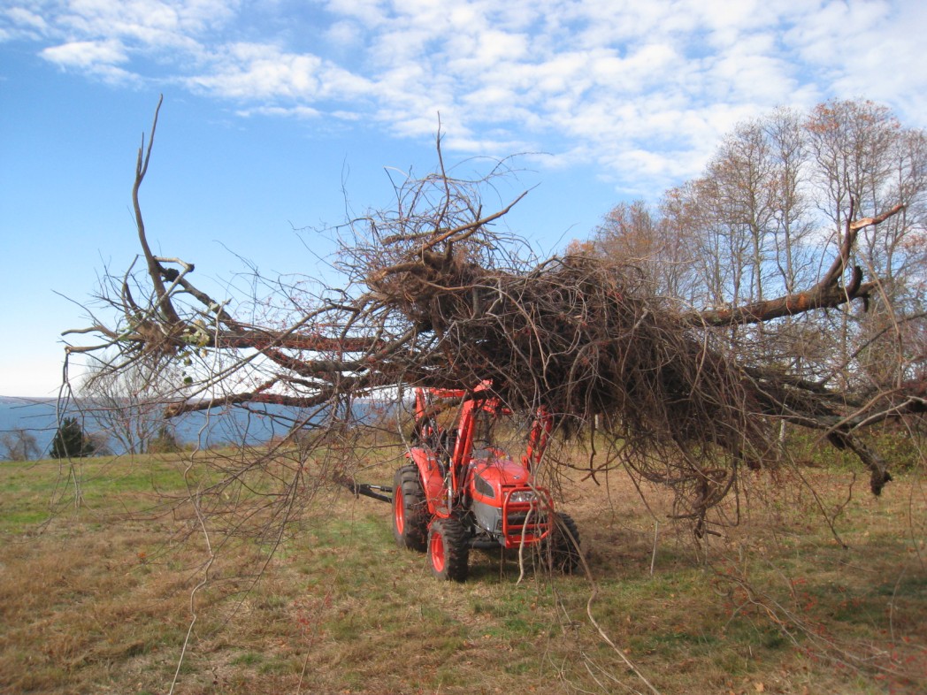

Nice grapple Jim but at the risk of stirring up trouble I will challenge some of your assertions.
You have spent probably close to $3K on a 1000lb grapple for your M59. That means you have reduced your lift capacity by 1000lbs rather than by 300lbs had you chosen a light duty grapple. That means your 4000lb lift capacity is now a net 3000lbs which leaves your significantly bigger tractor not much more lift than mine (2700lb capacity with 300lb grapple). Agreed, the M59 is a bigger heavier tractor and loader to be sure but at least one other TBNer has the same grapple I do on his M59 with no regrets.
The bigger is better or heaviest duty is best philosophy just doesn't fly very well with grapples on CUTs. The grapple you purchased was designed for a big skidsteer with much higher lift capacity (not rating) than yours. If a M59 doesn't destroy a 300lb grapple then what are the extra 700lbs of steel doing?
Width is another thing. I suppose there are some applications like clearing construction debris where a wide grapple would excel as it sweeps up bricks etc but for trees, slash and brush a wider grapple has very little if any advantage in what the grapple can hold. Brush is "sticky" and you can hold a lot wider bolus of brush in your grapple than the grapple is wide. Wider grapples just add weight and block vision when working in the forest as well as reducing manuverablity. A narrow grapple also lets you put more force from your loader on a given spot of soil or root. That means that paradoxically a smaller grapple can uproot a bigger tree or lift a larger rock than a bigger heavier duty grapple on the same loader.
Putting a skidsteer grapple on a CUT is much more expensive, cuts lift capacity and targetted breakout as well as reducing manuverability. I don't even know for sure you gain durability as a bent tine on your grapple is a lot more difficult to fix than the mild steel on a Gator or similar light duty grapple.
Can your rig really grapple more than this $600, 300lb, 48 inch grapple? :

Is that a BH stabilizer arm that I see in the 1 pic. I bet you were only on the flat for the picture. Backhoe stabilizer arms can sure make you feel better at times.
Before I bought my grapple I was convinced that it had to be as wide as my bucket (6'). I never used a grapple before so I decided to read a lot of post on TBN from the pros. It appeared to me that most folks liked the smaller width grapples. One day I found a brand new 5' grapple on Craigs List that I could buy for $700.00. I decided to listen to the TBNers and bought the 5'. After just a few weeks of use and I am so glad that I took the advise. What a difference driving through the woods with 5' compared to 6'. It weighs plenty at 5'. I have yet to wish it were 6' but I have said to myself several times sure am glad I took the advise.
/ It's Grapple Time #15
Is that a BH stabilizer arm that I see in the 1 pic. I bet you were only on the flat for the picture. Backhoe stabilizer arms can sure make you feel better at times. .
Yes, I have my BH with ripper mounted which is why the trees you see have all their roots. Popping them out and carrying them to the brush pile.
I also like leaving the stabilizers open to about one foot off the ground as a safety prayer. I don't travel with the load up as high once I get to the slope I need to decend to the brush pile. I did screw up last week though when I drove the tractor into the barn with the stabilizers like that and nailed both sides with the stabilizers. Luckily I had a can of paint so quickly painted up the damage and banged a couple of boards back into place. SWMBO doesn't know and if I have any luck she'll never figure it out.:laughing: If things go as usual however she'll spot it the next time she is around the barn despite my clever repairs.:(
