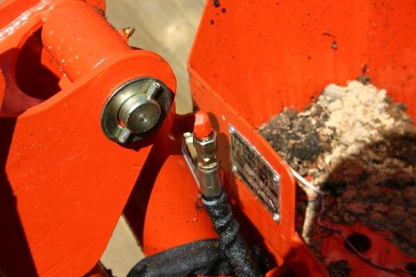

She arrived on a rollback about noon on Friday the 8th and after a quick review of the manuals I set about striking things off of my "to do" list. First to work on some of the stumps poking up in the new parking area. Started picking at a stump from one side and got as far as I could until it was time to reposition. Up with the right outrigger. Up with the left outrigger... where's this shower of hydro fluid coming from??? /forums/images/graemlins/confused.gif A quick look reveals a pinching of the lift hose and fitting between the cylinder and the BH foot well, exactly like broke hydrolic /forums/images/graemlins/mad.gif
A quick call to Carver equipment and they are sending a new cylinder and hose straight away /forums/images/graemlins/smile.gif
So it's only FEL work until Monday when UPS arrives with the parts. I can handle that.
Monday and all is right, UPS has my goodies and everything goes off without a hitch. Back to backhoeing stumps. All is going well until this afternoon (Wednesday) and the wife is watching (from a safe distance) while I "play". As I am finishing up with one stump and moving on to another she says "Did you know you're dripping something?"
Shut down and start crawling all over this baby to find the leak. The leak is coming from the top fitting of the hydro pump (slow, but enough to start leaving puddles). /forums/images/graemlins/mad.gif
Another call to Carver and Terry (sp) suggests tightening the three bolts on the hose on top of the pump. Give that a shot, and the bolts just continue to spin, not tighten. The pump is still weeping hydro. He's going to call Kioti in the A.M. as they are already closed (it's 4:45 EDT) and get back with me tomorrow on parts order status.

Sorry to hear you joined my little club /forums/images/graemlins/frown.gif but happy to hear your dealer is taking care of you. I plan to attach a length of rubber hose on the stabilizer to "cushion" the blow. I found some red rubber hose at HDepot that ought to work.

David, when you and your baby are reunited in Hawaii, look at the bracket where the stabilizer hits. I think there's a hole already there that you can put a bolt and a couple of nuts on that will keep the stabilizer from hitting the fitting. If not, find a location where you can drill a hole and put something like this in it, maybe with a rubberized end on it to cushion the blow, but protect the fitting. My dealer has done this on one of the models, but I can't remember it it's the same one you have or another.

What I am thinking of doing is finding a hood alignment bumper (similar to the side panel bumper on the LK3054) so that I can 1. mount something more permanently than I could with adhesive alone, 2, afford adjustability for a final fit, and 3. have some cushion so I can still hook the arms with the transport locks.

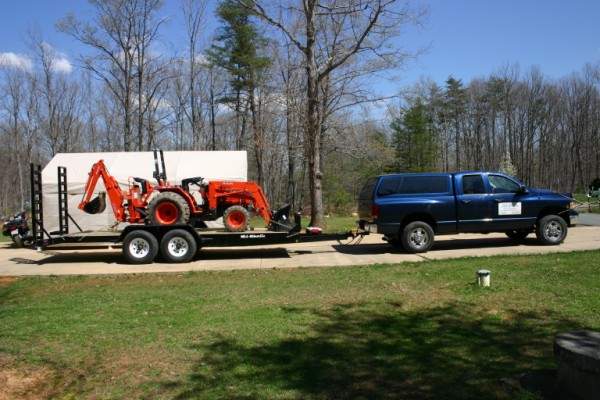

I promised some pics once things settled down and here they are. This is one of the tractor on my 20' 12k trailer behind the Ram 2500 Cummins. It tows okay, but I'm going to get the weight distribution setup working so I have some peace of mind.

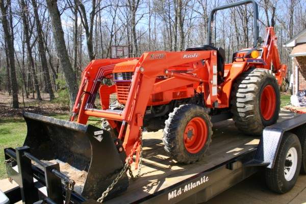

Here's another of the tractor on the trailer.

Here's one of the busted hydraulic line /forums/images/graemlins/frown.gif
