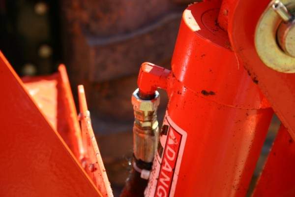

And another of the hydraulic line from a different angle
   / It's here, and broken, again... #12
Re: It\'s here, and broken, again...
I have to say, that looks all too familiar. /forums/images/graemlins/frown.gif Seems if the cylinder were rotated just slightly, there wouldn't be a problem.
David
   / It's here, and broken, again... #13
</font><font color="blue" class="small">( Sorry to hear you joined my little club /forums/images/graemlins/frown.gif but happy to hear your dealer is taking care of you. I plan to attach a length of rubber hose on the stabilizer to "cushion" the blow. I found some red rubber hose at HDepot that ought to work.
David )</font>
This seems to be a design flaw that is so obvious it's not funny. Why Kioti has been so slow on the "fix" I don't know. DePratt sent me some bumpers that come from land pride that work really well.
Of course, that was after an eye full of hydro fluid when I lowered the leg while
trying to spot the leak.
While tightening the fittings seems to have worked, I don't know or not if there is long term damage to the cylinders or fittings..
   / It's here, and broken, again... #14
</font><font color="blue" class="small">( While tightening the fittings seems to have worked, I don't know or not if there is long term damage to the cylinders or fittings.. )</font>
You would most likely know if there was any permanent damage as you would probably not be able to stop the leaks.
Next time, remember to use a large piece of cardboard to catch the leaks instead of using your eyes! /forums/images/graemlins/grin.gif /forums/images/graemlins/grin.gif
Sorry, couldn't resist! J
