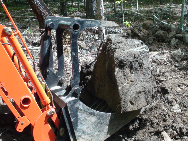

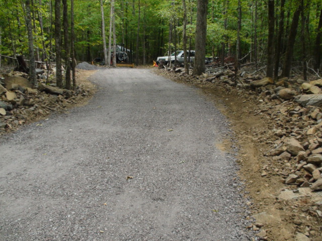

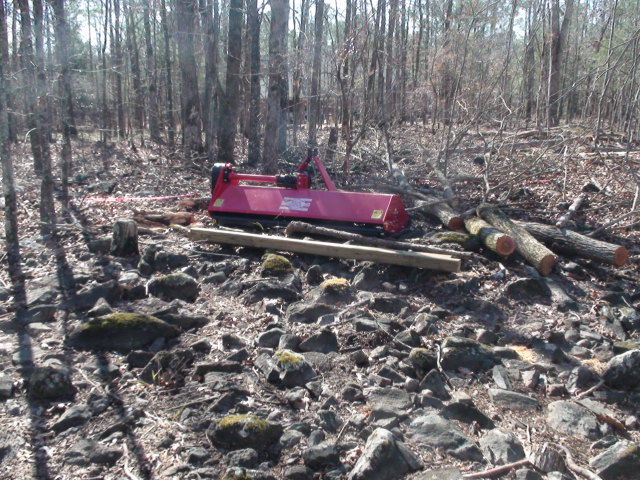

Sure. Will post if I can actually get any meaningful data. However, I believe the vast majority of my FEL digging has been completed as my driveway is now built. I still have to clear 1.5 acres of trees/stumps for the home site area, but have decided to hire a mini-x and operator to dig the stumps out- well, anything larger than 4" or so. I have very large rocks the tree roots seem to love to grow in between. And I have had to dig around those to even get to any meaningful stump removing. Has really been a trying and time consuming project, so far. Example of rocks others have seen in various posts- just so you can get an ideas of what I am speaking of. The front tires were in the air all of the many hours of digging time.
View attachment 394331View attachment 394332View attachment 394333
Yup, I would say your digging is much tougher than what I've subjected my DK to. Pretty impressive though. Good to know my machine could do something like that if needed. BTW - your driveway looks great.
