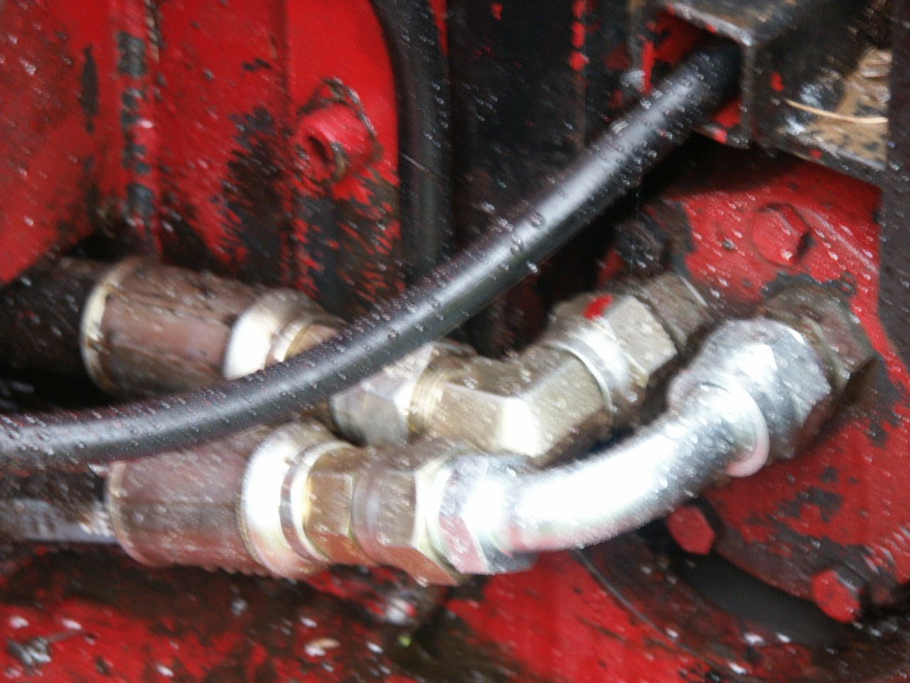

It is DONE. And thanks to all of you for all the advice.
First, I have to get over psyching myself out of projects. I have a college degree, I am handy and I have friends who will help me out as much as I hate calling in favors.
This said. I learned a lot.
Outside of all of this advice I have a few other notes.
yes, 4 wire hose is stiff. Maybe too stiff. I took everyones advice and decided to pull the hoses connected to other hoses (use the old to pull the new). To do this, I had to have straight ends on both sides. I deemed it easier to have someone (wife) push from the engine side while I pulled from the cab side.
I found that if you pull the hose into the cab (from the front wheel well) it will move fairly easy by using your foot (grab the hose, bend it back and put your foot on the crimp and push... 6" at a time but it gets through.
I found that no matter how clean things are there still is dirt everywhere. Keeping everything clean was a trial.
Finally, and this i big. On my 1850... Since I put straight connectors on the front end, I needed to get angled pipes that screw on. Problem is that this whole rig is much thicker than the original. I could not attach the pipes. I had to go back and but a hard 90 degree and that got one in closer to the wheel than the other allowing things to attach.
I will get pictures of this end result shortly.
I also have to do this to the other side but as it is not leaking at the moment I am going to hold off and regroup.
Thanks again to everyone for advice.

I cleaned as best I could but the tunnel shot the whole keeping clean idea. It was caked in crud. I did not use or need lube.
I am going to replace the other wheel hoses as they are definitly dead soldiers. I will use 3 wire hoses and see if that makes a difference in the pull.
I have not put in the leak detection stuff cause once I cut the tunnel cover open it was clear where the leak was.
I will take some pix tomorrow of the wheel connectors.
Carl

I just wanted to show you guys how I dealt with the hose ends. Because of the way the wheels set up I could not get the nice long bent 90 degree adapters on. So one is a short hard 90 and the other is long...
