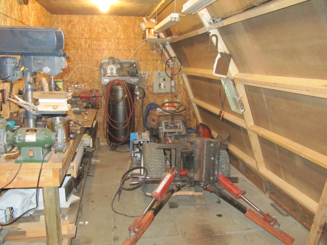

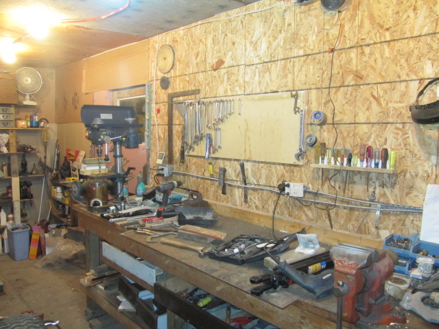

Hi Folks.:eek: Remember me?:) I was building a mini back hoe last year in summer.:cool::p I wimped out when the weather I like to work in went South - literally!:laughing::laughing:. That's when I began to winterize my "Summer shop". I'm happy to report that I have that done and am able to work in relative comfort. It is a temporary setup and not meant to be anything more than a heated shelter from the elements till time and money allow for nicer digs.:licking::thumbsup:

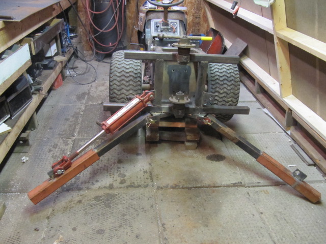

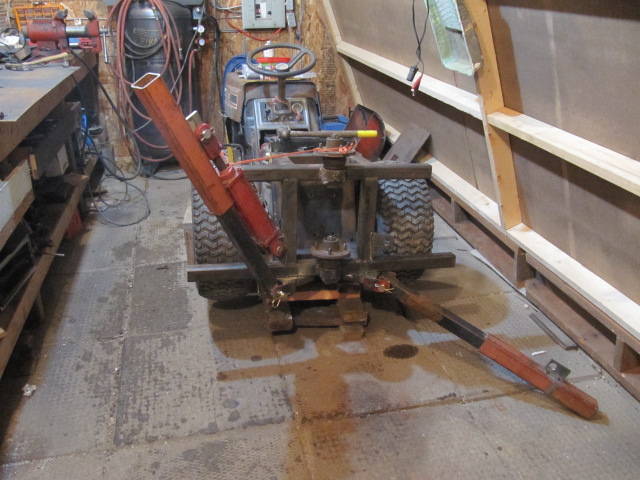

I have resumed working on the BH recently and now I'm concerned about the outriggers. You will see them in one of the photos. I made them similar to what I've seen in photos of trailer type BHs. What has me worried is that they seem a little too close in to where I'll be trenching. When I am swinging a bucket full of diggin's to the side I'm wondering if it will be tippy. I guess I can make them longer. If I do that, I wonder how springy those things might get.:confused: The reason to have them swept away from the rear of the tractor is to keep the other end from getting too light when I'm digging. I'm hoping for some feedback on this.

Well, it might be better to add weight to the front of your tractor and have your outriggers be at 90 degrees - now that you already have them welded in place... You will find that they will always be in the way, having them splayed out the back.

I may try to move them away from the swing path tomorrow. Like you said, they are welded in place at this point. But if this ain't workin' it ain't stayin'!:(:ashamed:

I've rotated the outrigger mounts a few degrees and just tacked them this time. Even without lengthening the arms I have gained a fair amount of width for it's stance. If that is still not enough, I can add a few inches on each side to widen the stance of the machine some more.

Good to see your industrious side but having spent a lot of time on a backhoe I would not recommend splaying the stabilizers to the rear. You will find that they will get in your way. If you are concerned with tilting the machine while digging I would adjust the weight on the front of the machine.
Usually what happens when learning to operate a backhoe is that while crowding the dipper without adjusting the boom you tend to lift the tractor and slide towards the bucket.
I would also recommend you compare the forces on your machine to other backhoes of similar weight, there are lots of reasons why the manufacturers have similar design specs.

Thankyou for your insight and advice.:thumbsup: I do not have a FEL for this tractor so the weight in front will be less. I have been positioning the stabilizers rearward behind the pivot, thinking it would help with the front to rear balance. The dozer blade which is going on there will help but will still not equal the weight that a FEL would provide. From what you are saying, I take it you recommend extending the stabilizers (outriggers) at right angles from the pivot. I can still do that at this point. If I go that route I'm wondering how much weight I'll have to add to the dozer to help hold the front of the tractor down.:confused2:
