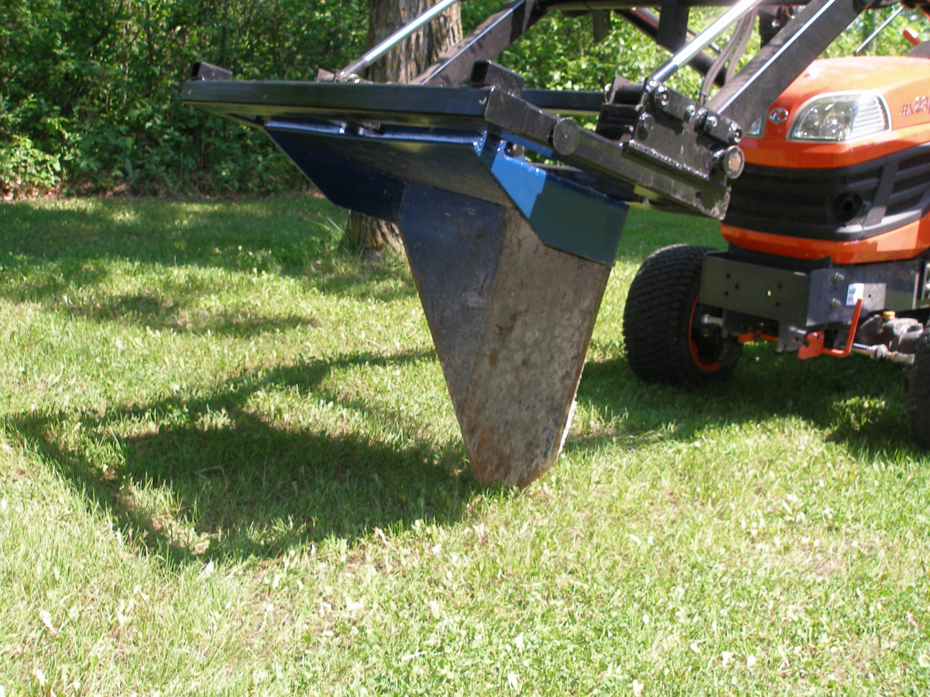

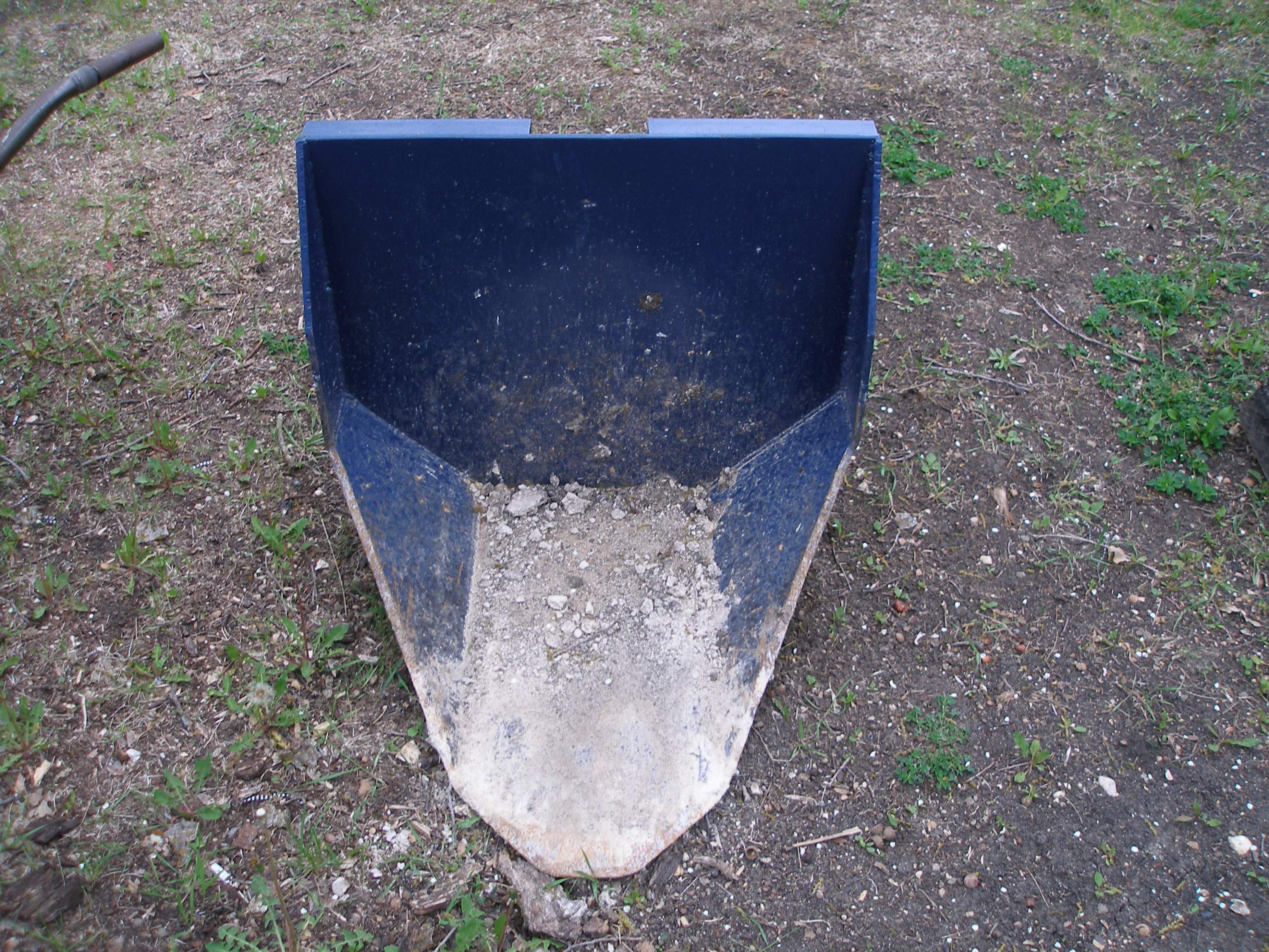

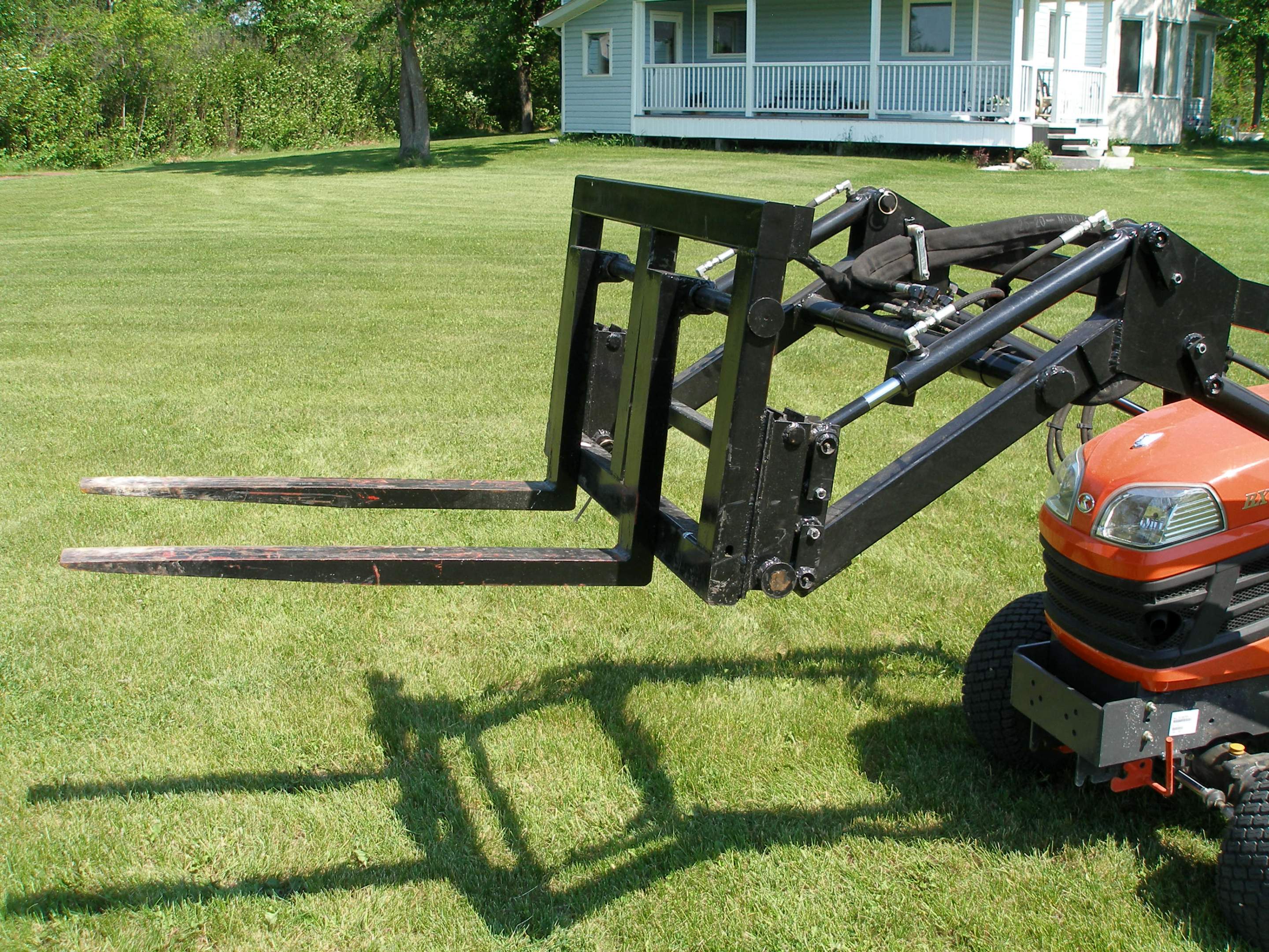

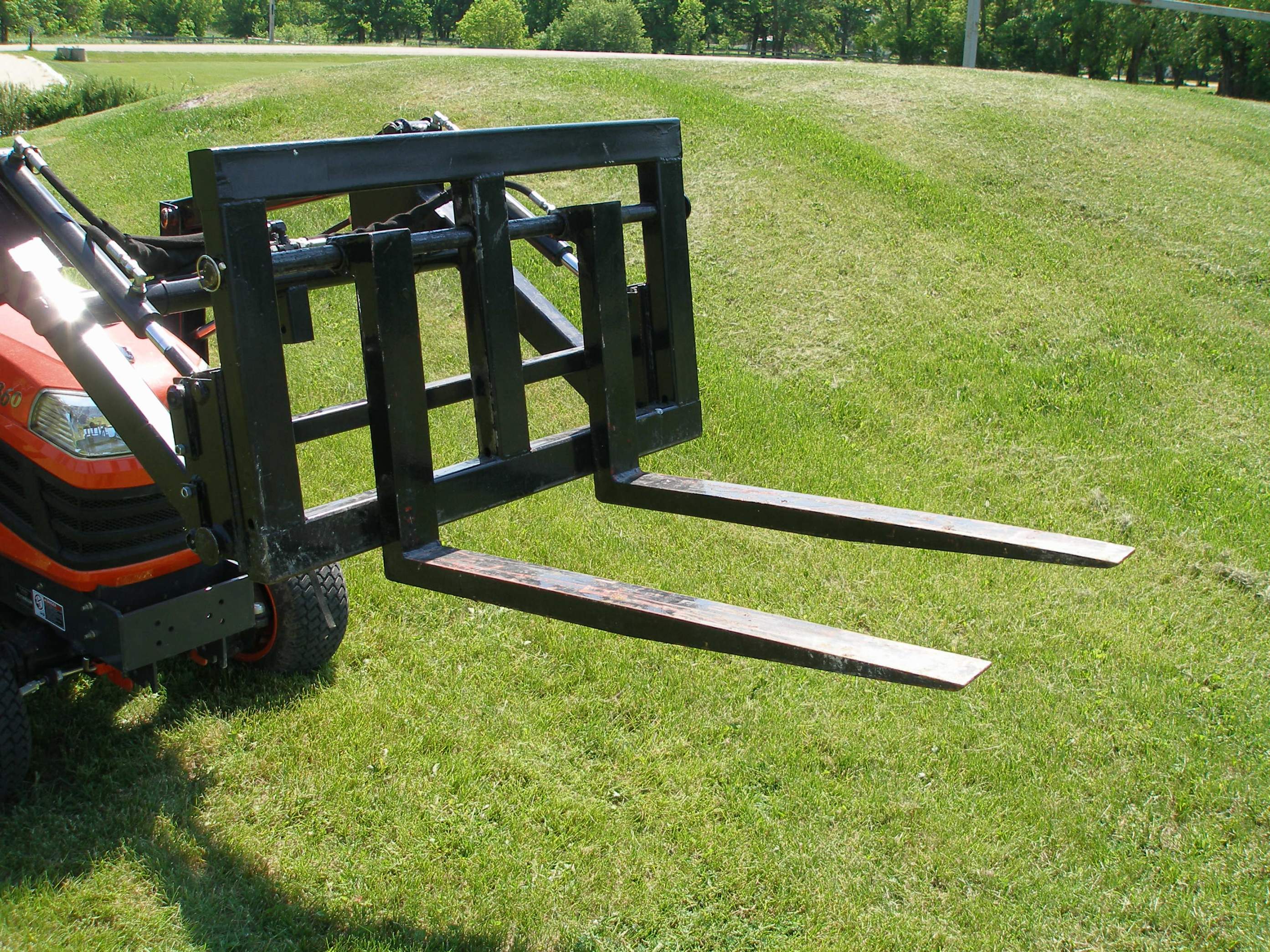

I believe in long weekends (april 5 to july 2). I have finished the Pallet forks, and the Quick spade, and the interchangable mounting bracket as well as a Ripper, Power boxrake, and Quick hitch i have pictures of everything and i dread the wait time to upload them but alas here they are starting with the quick spade.
now while i wait i would like to say that i have copied and thrown my own twist on my fellow tractor by net compatriotes own attachments and i could not have done it without you. the rest of the pictures will be uploaded tomorrow

Looks like You,ve been busy :D . Great looking work there garnet , Thanks for showing & looking forward to the rest.
Any chance of seeing some pics of that tree spade doing its job , I,d be curious as to how good it works ? looks like something that would come in very handy for Me . Bob
   / Ive been a busy little beaver #3
Very nice builds! What type of downforce do you get with your tree spade? Seems like your ride is a little light to get a good scoop. Once again nice builds.

Nice work! I would have loved to have had that quick spade last year when I dug 20' trench by hand (my neighbor with the BH was too busy for too long, and I had to git 'er done).

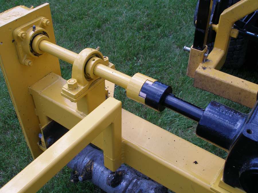

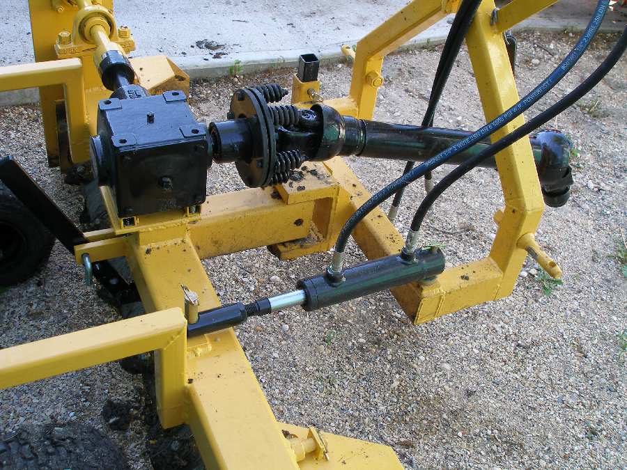

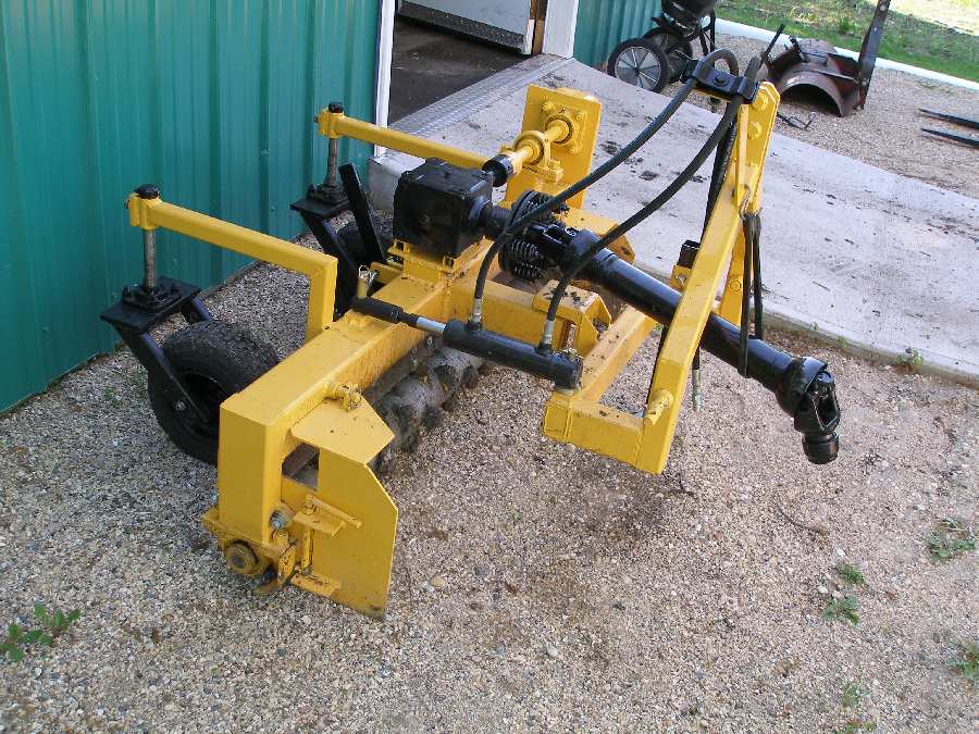

I thank all of you, the advise was very helpful. And bladerunner (Dave) your resizing idea was very helpful. We were very busy with work putting in very long days so I haven't been able to get online. And it seems uploading pictures is more difficult than my projects. These are of my power rake (box rake). As you may notice from the accumulation of dirt that I've used it extensively and I must say it works very well! Although I do need improvements. Such as some form of a shield or guard to protect the operator from flying debris. I've nearly been hit a few times. I was considering simply slowing down my machine by 1/3 or 1/4. 540 is tooo fast! My bullet holders are only 3/16 and should be heavier in general for whatever you are using it for. They stretch and my bullets fall out. Every time I use it I need to replace a few.

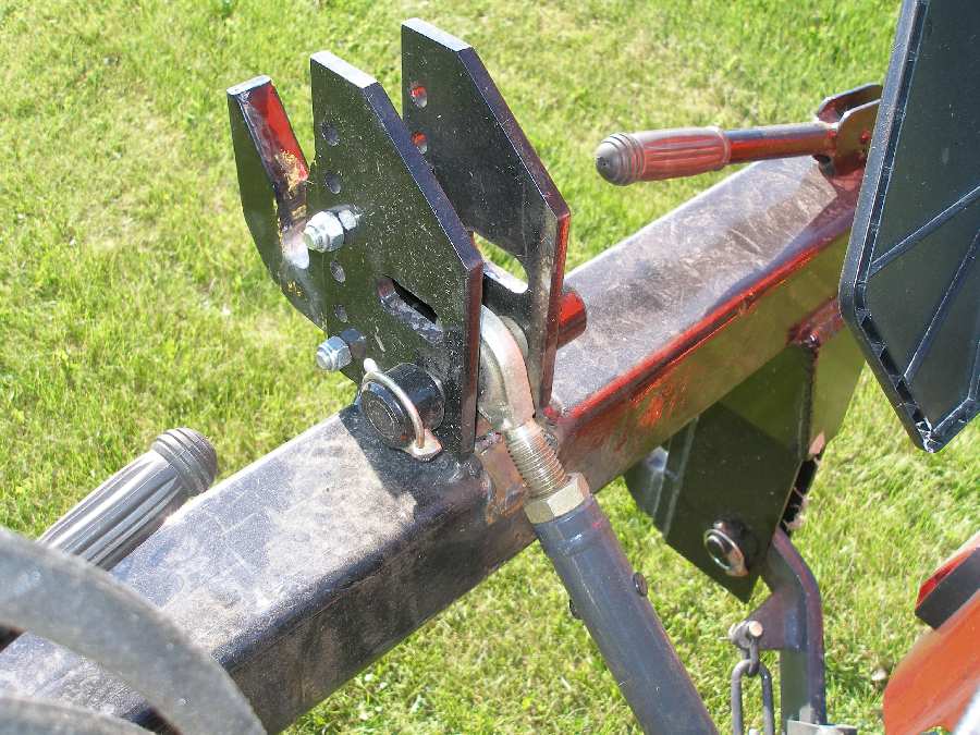

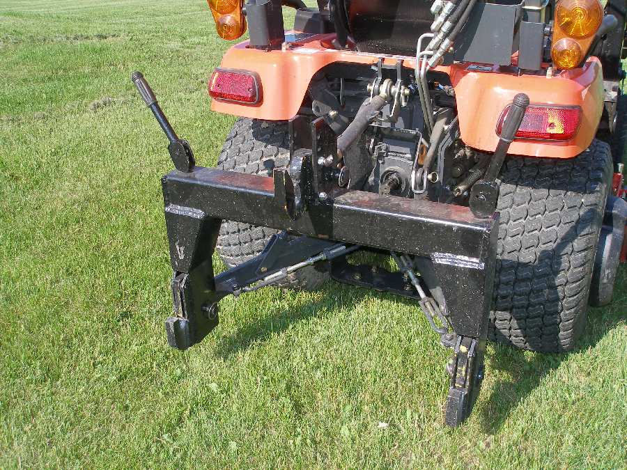

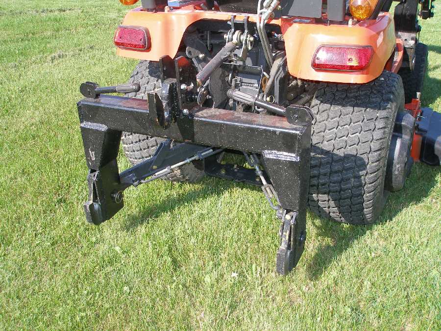

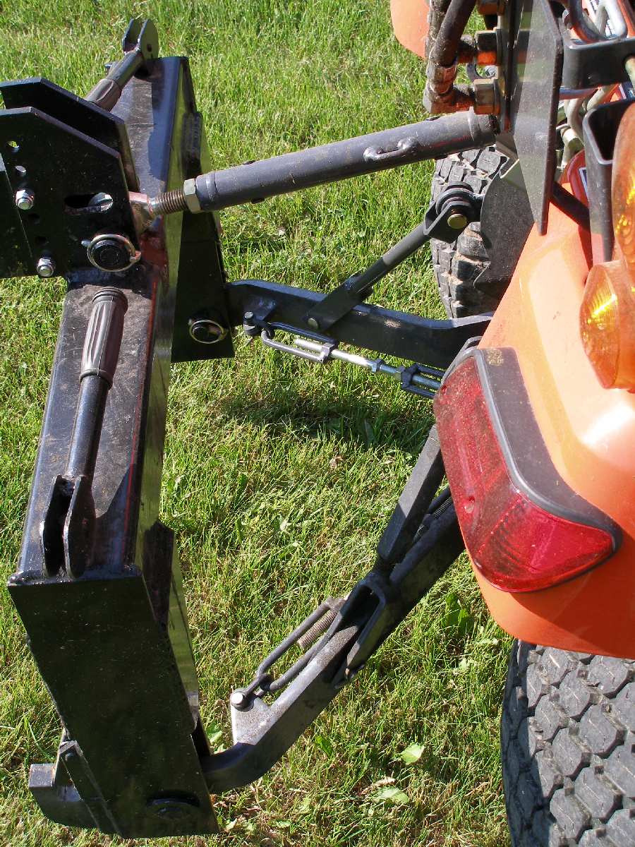

Here are some pics of my quickhitch. This piece of machinery has made my life so much easier these past few months. Note the slot at the top of my quickhitch. it was put in for my power rake, for floatation. The hardest thing about building the quick hitch was finding the springs!
