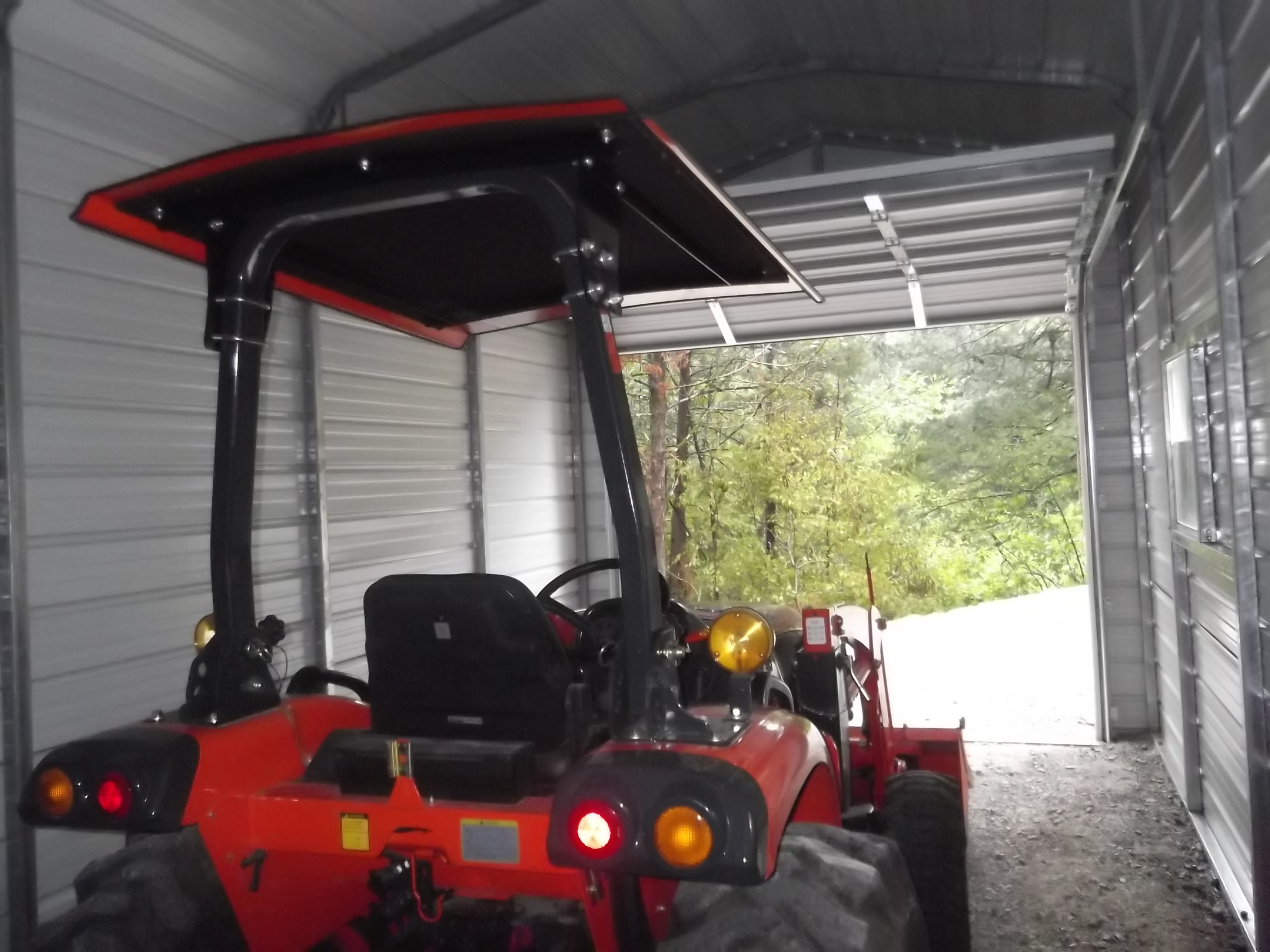

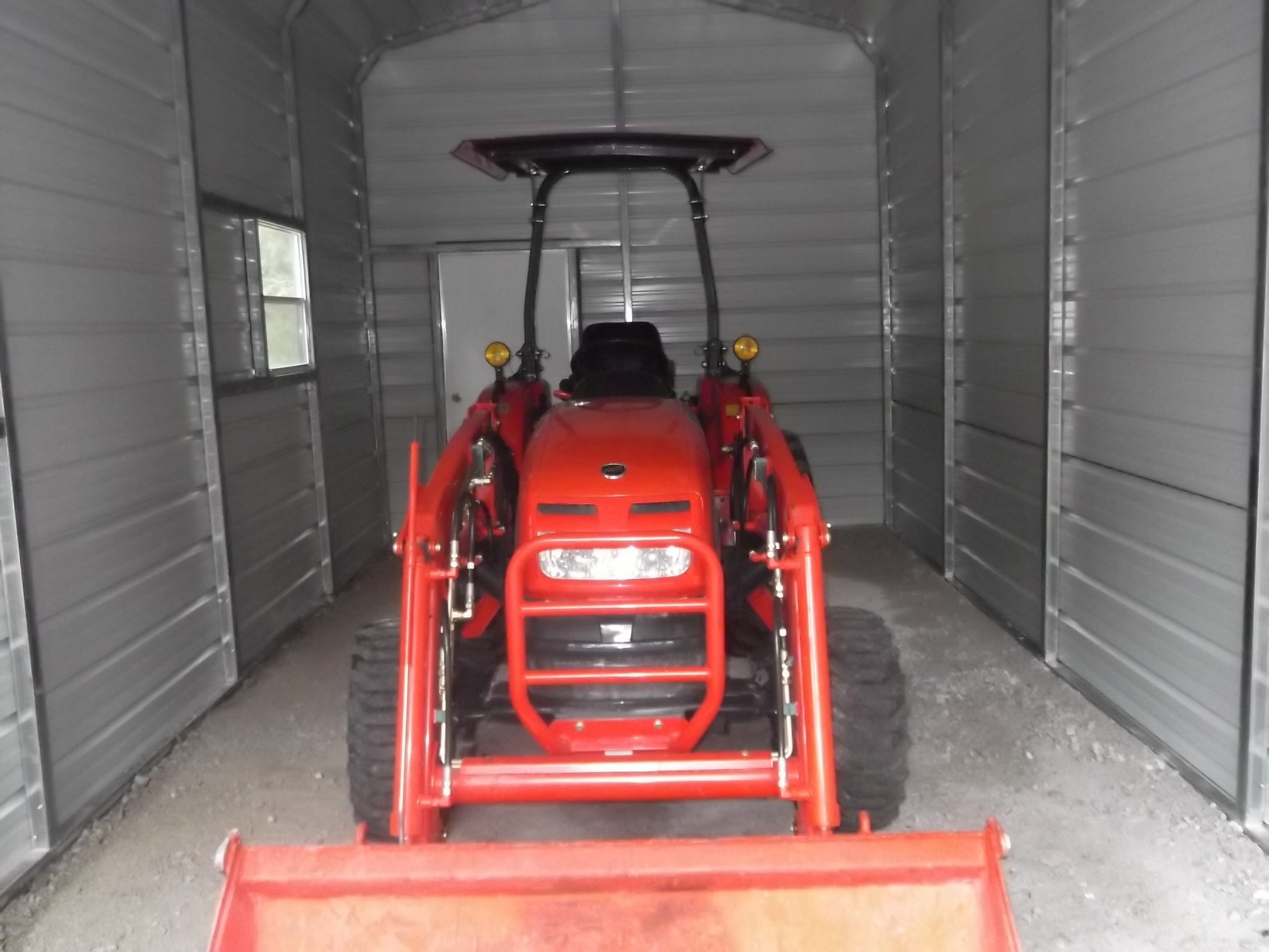

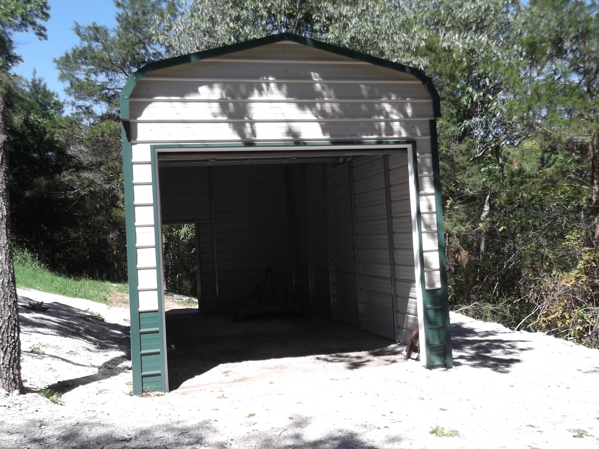

My thoughts:. Yes some other tractor use pins not the threaded bolts..Yes the bolts/nuts get easier after using them a bit. On my old L3400hst I had to put the rops down/up ever time I used it. It became a simple habit, and did not really take all that long to do. I did use a spray on lube of course (fluid film) to help make it easier. I did think about grinding off the threads at first, but after a while, it just didn't seem like a big deal and I left it stock.
I built a barn with an overhead door my tractor (Kioti now) clears with ease, and put on a canopy (really worthwhile to have) problem solved.:)
