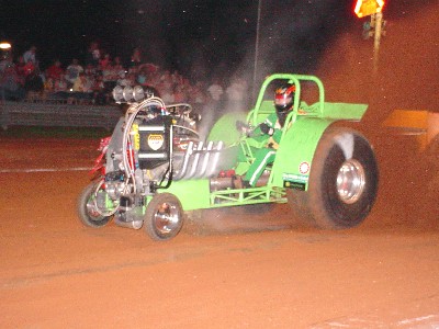

Well here's a 2600hp one i'd take 35K for if u realy want some power lol i haven't been able to plow the garden with it but sure makes the yard rutted out and ticks the neighbors off /forums/images/graemlins/smile.gif my weekend hobbie..lol
