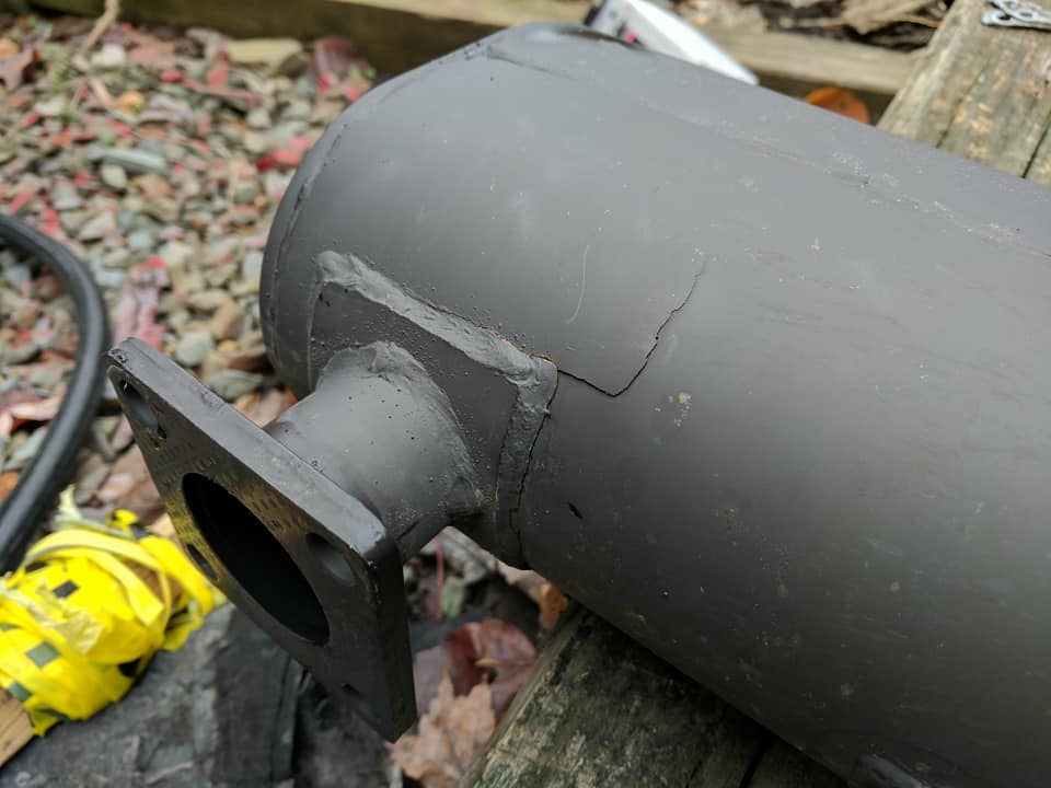

Been hearing a rattling under the hood so when I went looking I found this...anyone else seen this happen?
Ive owned the tractor for just about 3 years now (only 94 hours on it though) so I think its safe to assume the 5-year factory warranty will cover this? Planning to load it up and trailer it over to the dealer on Monday. Pretty sad to see the muffler is made cheaply enough to crack like this...if it werent covered under warranty its about $180 (plus shipping) to order.

I had it happen on my xj2025h. The weld on mine had broke where the pipe was welded to the muffler. The dealer covered it under warranty.
/ J2023 cracked muffler #3
Same thing happened to mine, but it was from the mounting bolt vibrating lose. Check the mounting bolt down by the power steering pump. I welded it back & my dealer sent me a check for my time. It has held up fine for 3 years.

There really should be some gussets on that, from the base out to a cradle strap on the bottom. Even it if was built from twice as thick material, the vibrations will cause stress cracks in the weakest area, which appears to be the feed tube. Pretty small area to be supporting all that muffler.

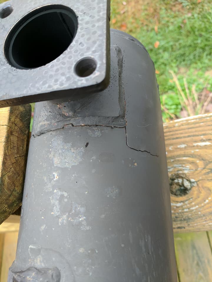

Looking for some advice from the folks that have had this happen. I have been noticing a rattle at a certain RPM for the last few months. Today I opened up the hood and found that the muffler was cracked just like you described above. My tractor is a New Holland Boomer 20......same tractor as the LS 2023 I'm pretty sure. So I call the dealer and its not covered. A new one was 108$ plus shipping but he told me that they know its a problem and the new ones are beefed up. The new one arrived today and it looks exactly like the cracked one, no additional gussets anywhere that I can see. I am planning to get my broken one welded for a spare. I was thinking of adding a rubber washer on the downtube mount but really don't know if that will help, Any thoughts or just bolt the new one on and hope for the best?

I would think adding some support to the new one would be better then welding up the old one for a spare. Even just adding a 1"x1/4" strap from the flange to the far side of the muffler will take the wiggle out of the muffler at low RPMs. Beefing it up might just be a thicker gauge steel for the muffler can but the thicker metal will still work harden over time if there is any flex.

The mechanic that fixed it told me whats happening is the lower support bolt is loosening/backing out and when that lower support comes loose it allows excess vibration which = cracked muffler.

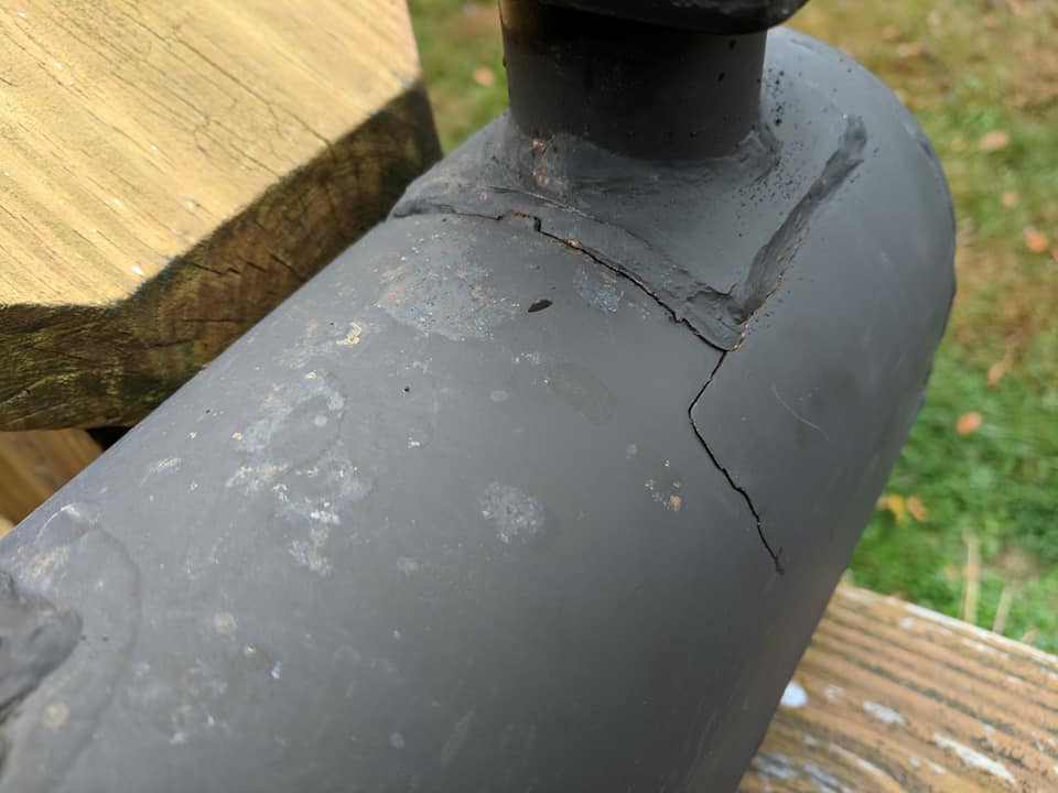

I was looking at the muffler a bit more yesterday and with the engine stopped, the muffler seems solid. If you hit it hard enough, you can feel a tiny bit of vibration in it. With the engine Idling it seems like its vibrating a bunch but its just the whole engine vibrating. I'm wondering if this failure is more related to heat, rather than just vibrations. I thought it was the vibration because my last tractor had a Mitsubishi 4cyl engine that didn't vibrate much at all and the muffler on that tractor didn't even have a second support, just bolted to the manifold.
/ J2023 cracked muffler #15
Jdom84, I have been thinking about the vibration angle and I can't help but believe that a proper weld should hold regardless of the amount of vibration.
/ J2023 cracked muffler #16
I don't think the weld is what is failing, from what I've seen of what others have posted, its the steel on the muffler can right next to the weld that has cracked. As melmark said... there apeared to be torque on the muffler when he loosened the second mount. Maybe the torqued system plus the thermal expansion of the steel is what is causing it to fail eventually.

I'd still recommend making a cradle out of some flat stock and using some round stock from the mounting plate to support the far end. The cradle would just need to be tacked to the muffler at the ends and a couple places in the middle. That would prevent any movement and direct harmonics back into the base, which looks to be quite substantial for the rest of the muffler.
