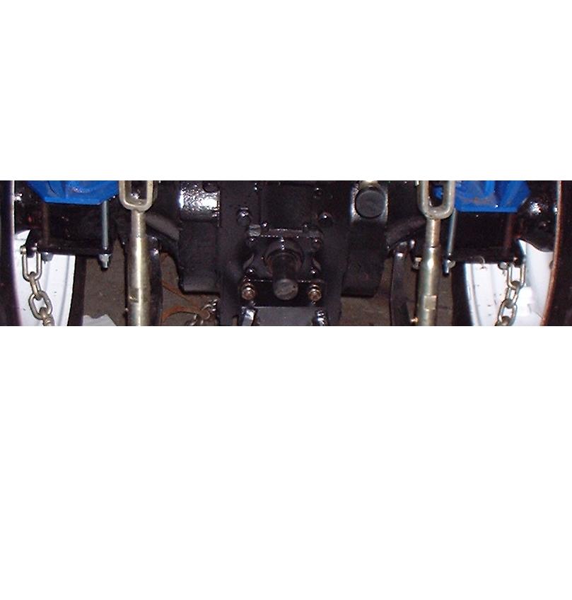

Bill,
Attached is a pic of a 354 I recently built. The black plates hold the long bolts that you use to mount your fenders. The pic is not the greatest to explain this but if you zoom in on the lower left side of the tractor you will see want I mean. The L brackets go towards the tire and are pointed down.

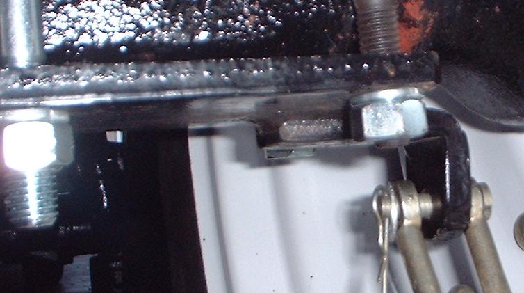

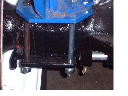

here is some pics of a jm 354 from nelson equipment showing how the plates should be installed. you should also have some large bolts that match the ones in the picture

   / J354 arrived - Parts left over, identify please #14
pic 2
   / J354 arrived - Parts left over, identify please #15
pic 3

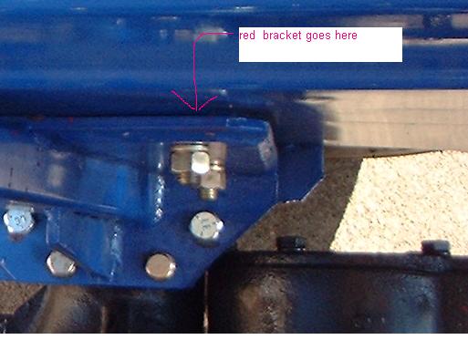

   / J354 arrived - Parts left over, identify please #16
pic 4 i haven't got my tractor yet, but i think i know where the red bracket goes just check it out on your tractor and see if the holes align

GOT IT! Thanks for all the help! I didn't see those long bolts in the tool box before. When I saw the pictures I went looking for the bolts and sure enough..... They are installed now. Thanks again!
