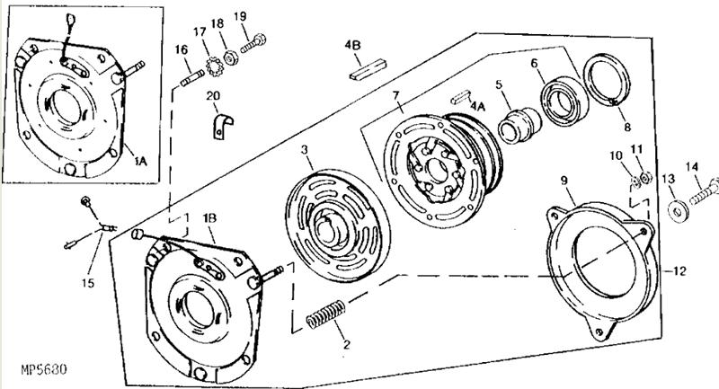

Sounds like you fragged the electromagnetic clutch.

I expected I did a job on the clutch, but I dont know what I need to do to replace it, and what parts I need.

This is the pulley im interested in:

That is the electromagnetic clutch between that pulley and the Onan engine...right?
Does that clutch wind up slowly when engaged?
Did you see this clutch on jdparts? or not?
Here is breakdown of electromagnetic clutch
