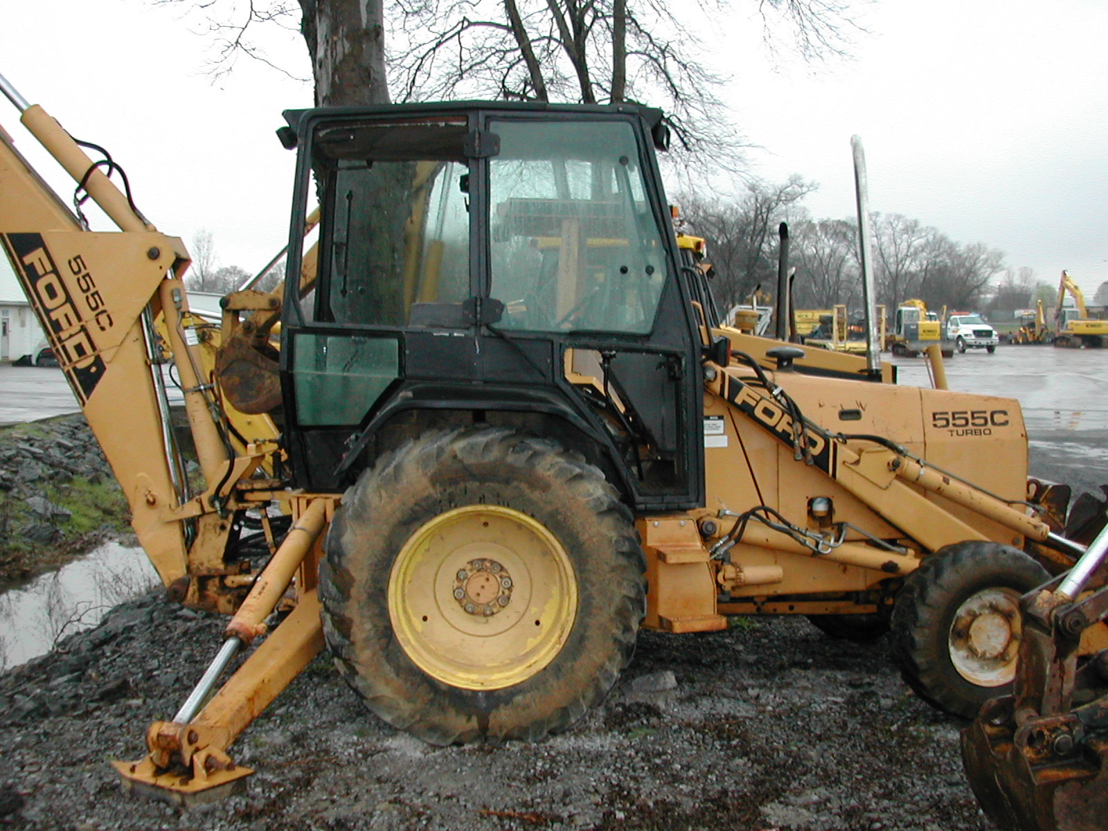

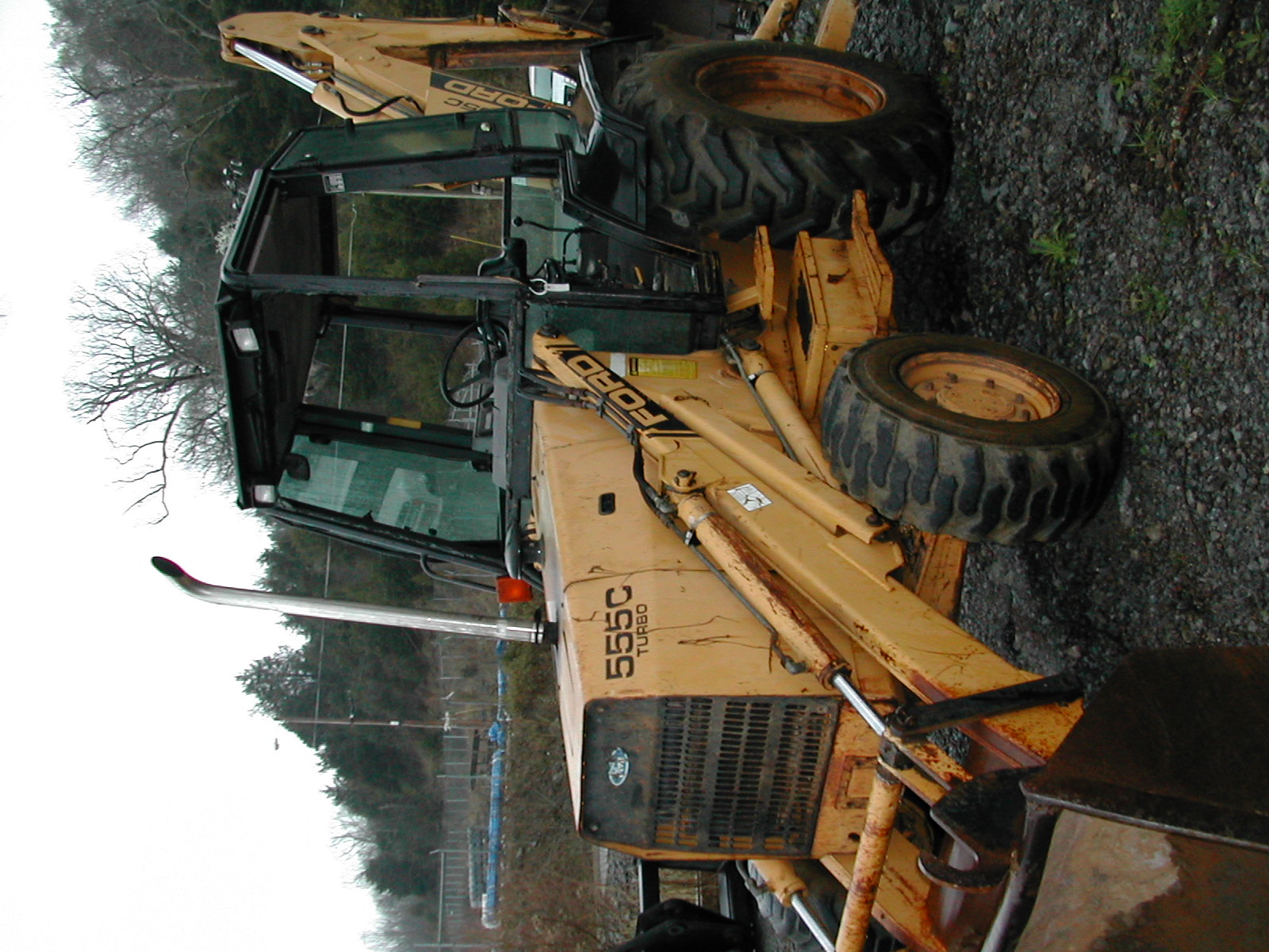

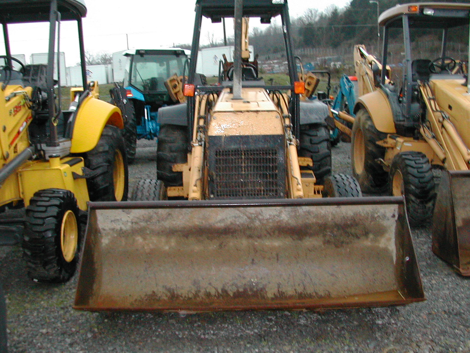

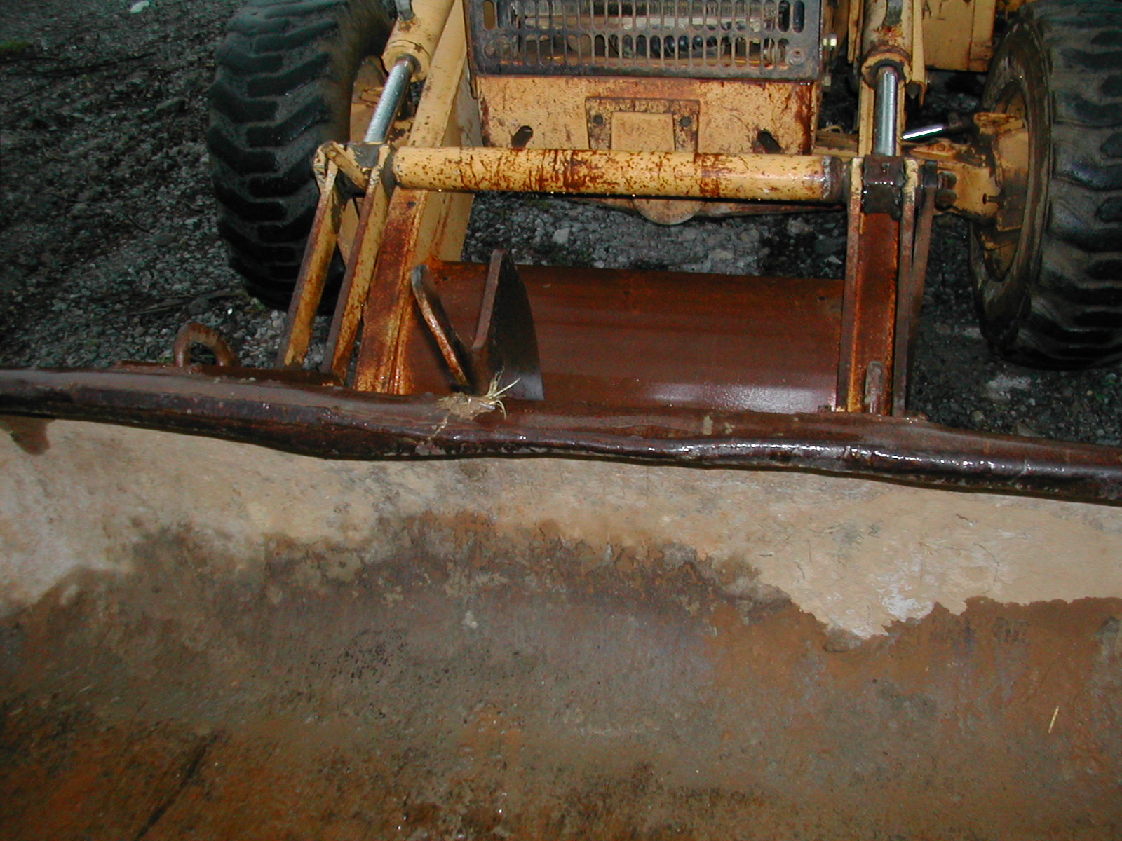

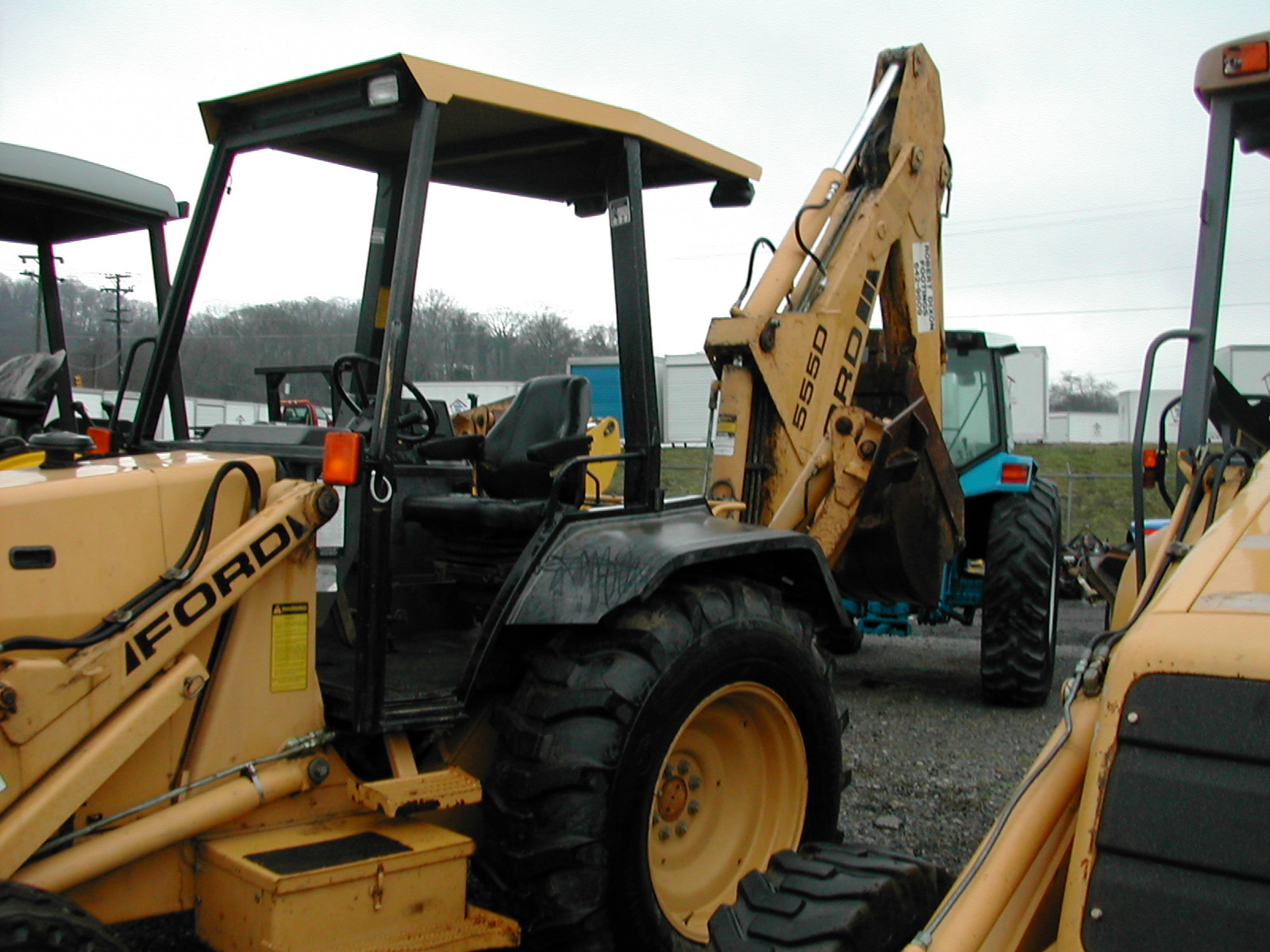

OK, went and looked at the Fords, these look the best of anything I have seen.
Going to buy one tomorrow unless something really weird happens.
Machine 1
555D, 2wd, 45XX hrs. VERY clean looking, used by a foundation contractor, the front bucket looks relatively unused. This is the cleanest machine I have seen in the price range. Open ROPS $13500
Machine 2
555C, 4wd, 67XX hrs, more beat then machine 1, yet cleaner then the other machines I have looked at, no, scabs, ugly welds jackleg looking repairs that I can see. Machine obviously had some time, several things are "loose" but functional, shifter, tie rods etc. Front bucket is ugly, but I could fix it easily / free. Cab machine, with several windows broken out. $14000
Bout too flip a coin I think.
General thoughts,
I will be less likely to get stuck and have to stick out with the 4wd.
4wd has darn near twice the hour's / wear of the 2wd.
2wd is a newer model (but judging from the earlier posts, this may be a good or bad thing)
4wd has the cab there, I can add glass a piece at a time if desired.
2wd front bucket is NICE, 4wd bucket has fork points, and I want forks.
I get stuck in my 2wd trucks,,,,, My next truck will be 4wd..
Resale on a 4wd unit is easier, and as they get older together, the 4wd is more likely to hold value.
Wheres that coin at :)
Quick thoughts appreciated. #1 or #2 and why appreciated most, all though all opinions and input is truly sincerly appreciated.
I also am just very comfortable with the Ford Machine and the local dealer network.
Thanks guys.

Alan,
My backhoe is a 1998 555E. It's a 1998 with 1,800 hours on it when I bought it three years ago for $18,000.
I know a bit about my machine, but don't have a clue on the D or C models. A few things I'd be concerned about from your description is the hours. Both machines have allot of hours on them, but the C is well past time for a rebuild. 5,000 hours is really a milestone and anything you get out of a construction diesel engine after that is just a bonus. Has the engine been rebuilt?
You just found two more machines. Neither seem like something I'd want. If I had to absolutely choose one over the other, I'd go for the few hours every time. 4WD isn't worth anything is it's all wore out or about to have issues.
Some things to look for in a machine.
Start it up and let it warm up. Then work the heck out of all the hydraulics. When running the hoe stick, have the RPM's up and get the most hydraulic preasure you can to the clinders. Try to snap the hoe stick from side to side, plus up and down and all other directions. The snap will tell you if you have worn out bushings.
Next pick up the back end of the machine with your hoe stick. Your front tires should already be off the ground from the front bucket being down. With all the tires off the ground and the outriggers not touching either, lower the RPM's. Don't get too high in the air, the idea is to just get the machine in the air with the front bucket and hoe bucket being all thats supporting it. If it stays up there at idle, turn off the machine and sit for ten minutes. Does it lower? If it stays up, that's a very good sign.
Start it up again and lower it back to the outriggers. Get off the machine with the motor still running at high RPM's and loot at each cylinder for leaks. They can be easy, or a total nightmare to rebuild.
One thing that New Holland has done that realy sucks is to standardize there cylinder rebuild kits on older machines to be the same as new machines. Parts can be very, very expensive because of this. I've now found a hydraulic rebuild shop to get my parts at a HUGE savings. I rebuild all my cylinders myself.
Look under it and check the hoses. Leaks can mean allot of things. Some are easy to fix, others can cost you thousands and stop your machine until you fix it.
Look for any sign of welds. Cracks mean trouble and most repairs are quick fixes to sell the machine and get rid of it.
Pull the dip stick on the engine while it running. Is there allot of preasue coming out of it? Is there any oil splashing out? Too much backpreasue can mean your ready for a rebuild.
