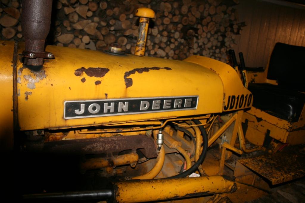

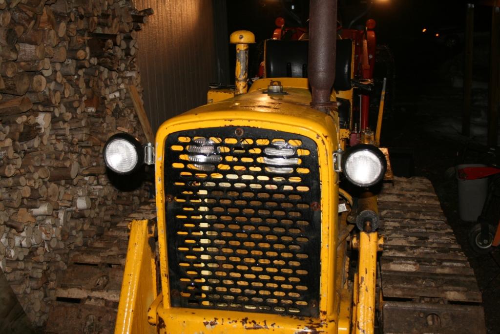

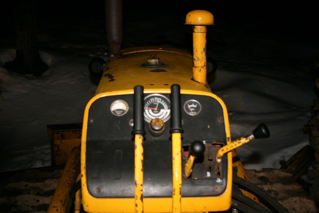

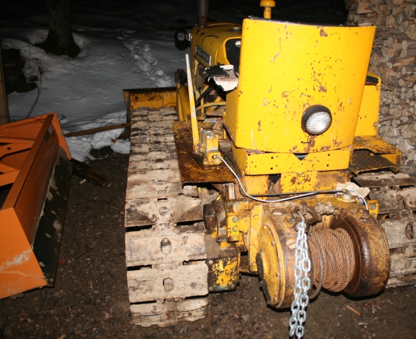

I purchased a 1010c about three years ago with a gearmatic winch. I used it to put in a rock wall, build up and fix my road, skid out trees, move stumps, multiple landscape projects and push back snowbanks, etc....I had to replace a front idler and few "wear" items such as a starter and generator but for the most part it has been very reliable for a forty year old piece of equipment...it will push and pull pretty much what I put in front or back of it. I paid $5500.00 for it three years ago and it owes me nothing!
Check to see how the tractor steers and how it goes into gear especially reverse. Take a close look at the front idlers and make sure that there is plenty of meat on the rails to keep the tracks in place. Be sure the track tensioner is operational and that there is no broken springs also look at the overall condition of the rollers /track.
I've had good luck with my 1010C, its a real work horse. If yours is in a well maintained condition as you stated, you should have no problem getting $3500.00 worth of work out of her.
