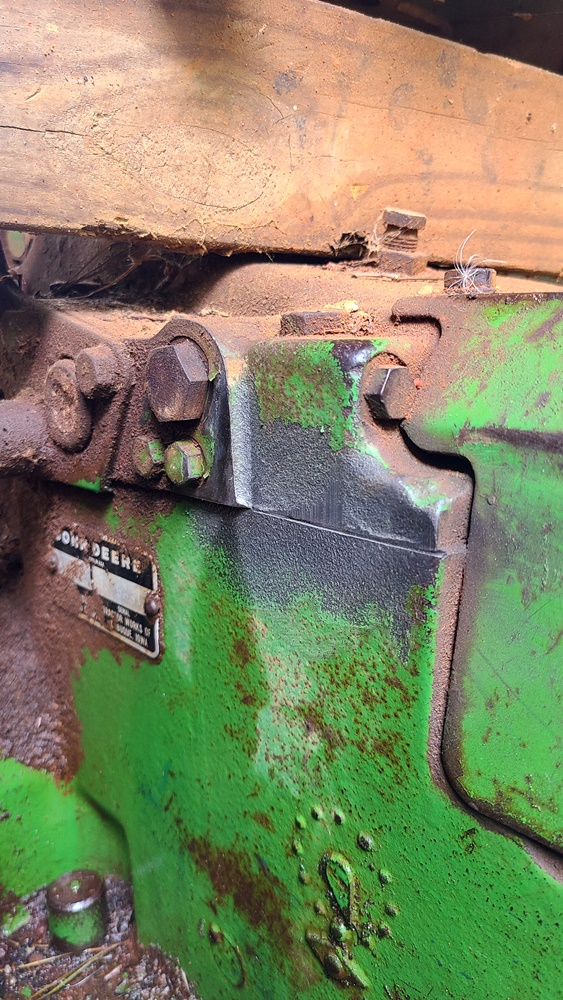

Hey guys. Our 1972 JD 1020 (gas) hunt club tractor, which is a running testimony to the durability of a JD, started spraying hydraulic fluid about a week ago at the "cleaned off" spot on the rockshaft cover in the pic. We're in the middle of season prep work and tried to patch it with some JB weld just to get by for another day or two. I've done a coupla searches and read a thread or 2 about something similar I think. Seems there was mention of these having issues with seals and there being a seal kit for it. Anyways, it was doing ok, the JB slowed the flow from a spray to a slow leach. But now a seal on an old FEL connection has blown out.
Kinda wondering if this is all from the same problem.
Is there s'posed to be pressure in the HF reservoir? It's also pretty hot to the touch on the side of the reservoir when it's been running.
We're gonna try to work on it after it cools off a bit. Would like to get some ideas about where to start.
Thanks much for any help.. d:^)

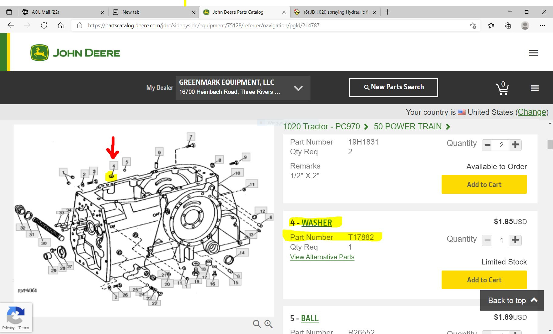

From your picture, I think the leak is in the passage from the transmission case to the rockshaft cover. JD uses a "washer" P/N T17882 to seal this passage.

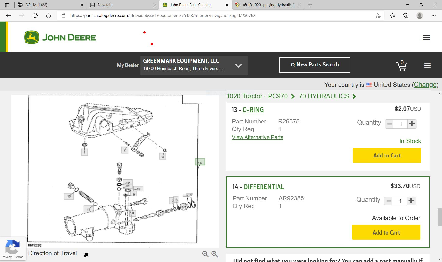

Before pulling the rockshaft housing, look in the transmission fill hole for oil spraying internally. A sign your rockshaft valve is leaking and needs to be resealed. Seal kit is P/N AR92385

I agree that the T17882 packing is blown out, as well as mounting gasket T21641. You can try looking in the fill hole with hitch up and down both, although since the T17882 is blown, it is probably spraying inside also which will make it difficult to tell if spraying oil is coming from blown orings on valves or piston as well. The AR92385 kit is no longer furnished. It substitutes now to individual orings. The parts prices are pretty minimal, so it would be worth resealing valve and cylinder while you have it off to replace gasket and packing. The excess heat you are feeling may be those seals leaking or internal leaks in steering, or scv as well.
