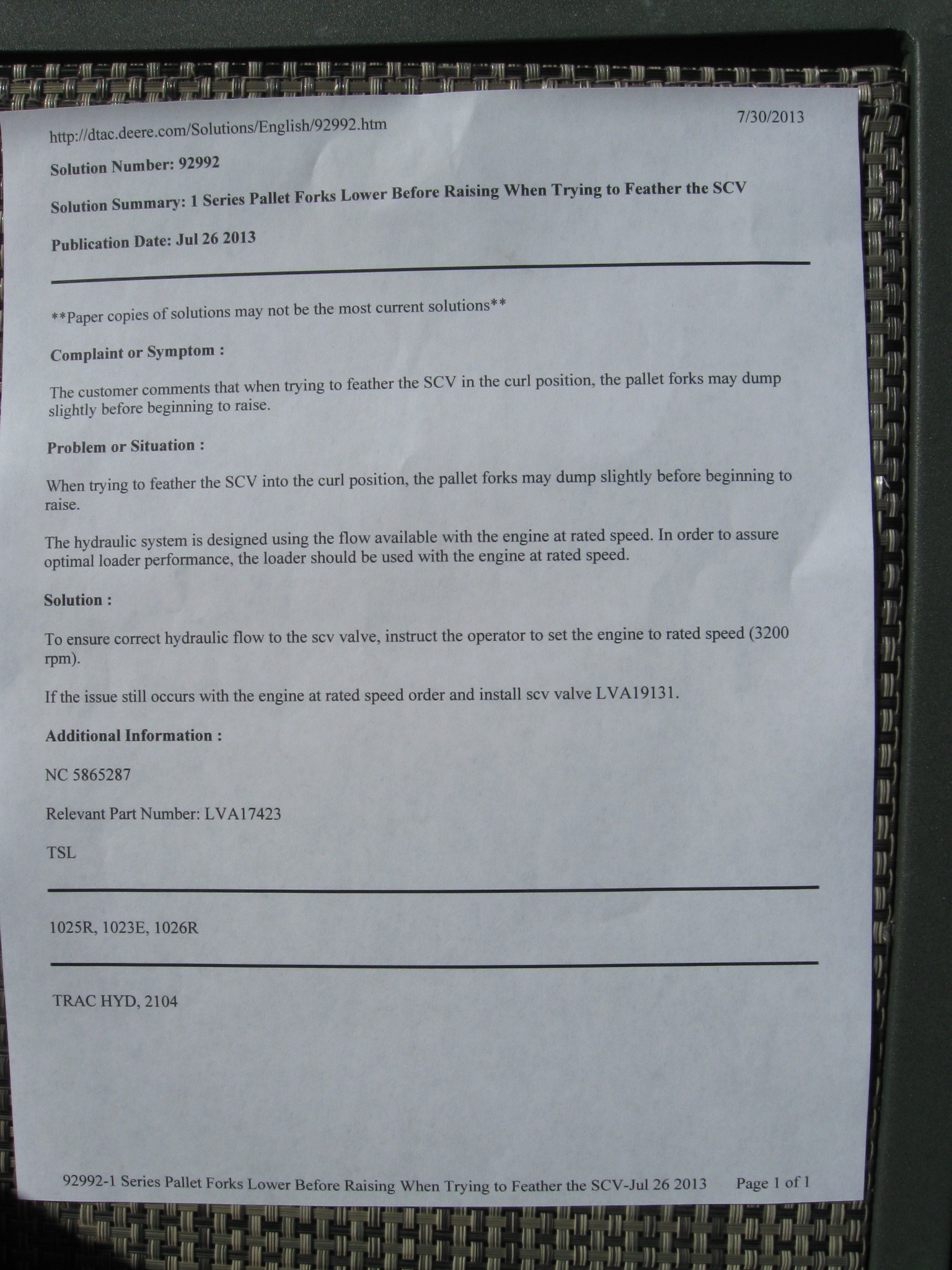

It would be a good idea to go ahead and let him know. He can probably find out if the new tractors have the new SCV in them. I am still waiting on the fix. I have gotten some what used to the drop when curling. However, it is a problem when you have a heavy load on.

It's been 5 months or so since my 1026R was delivered. During that time I never had any problem with the bucket drop issue. Last week a set of pallet forks was delivered and I had my first real need to use them earlier this week when unloading a pallet containing 64 gallon containers of chlorine from the back of the pickup. This was the first time I experienced the bucket drop issue when trying to feather a curl of the load. Lucky I had cleared the tailgate or that might have been nasty. Also lucky I caught it in time so I didn't dump the load on the driveway. Would've been bad for driveway and grass.
I'd already provided my dealer with links to discussions on this and the green tractor forum a few months ago so when I told him he said no problem.
If it wasn't for folks like those here sharing I would not have been prepared. Thanks!

Your Welcome. They do have a fix out for this now. It is under warranty. They have to replace the SCV.
