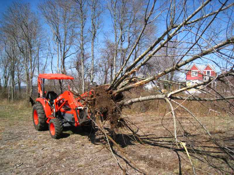

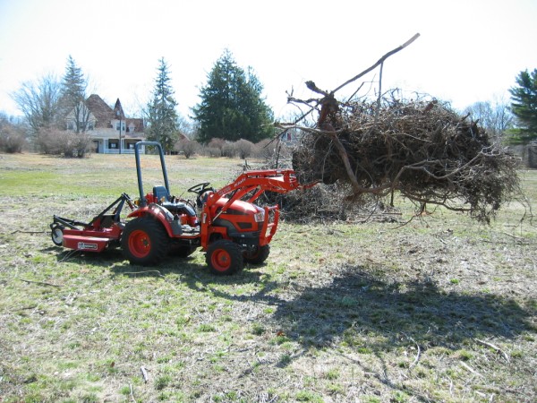

I own both grapple and forks. Love the forks and I agree that you could indeed carry a bunch of logs or carefully stacked small trees/branches with the forks but nothing beats a grapple for being able to uproot, load and crush brush as well as whole trees and tree stumps without needing to get off the tractor. Additionally, while one can cradle a loose load with forks, it is a lot safer to contain it between the upper and lower grapple arms when traveling.

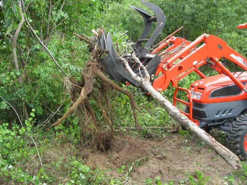

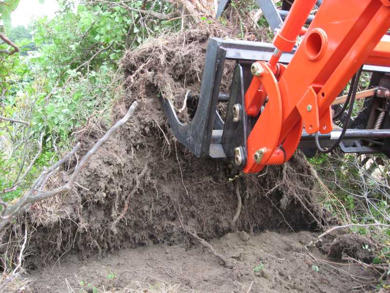

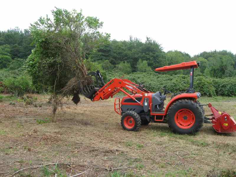

Grapples work pretty well for roots. I would not suggest just putting the grapple tines into the ground and driving forward on a fishing expedition but when you know there are roots in an area you can easily dig them out with a grapple.
I agree. I don't cruise around with the grapple in the ground just "fishin" for roots - I go to where they're bunched up..
And they're not a "cure-all", either. They're meant for grabbin' onto stuff and rootin' up and tearin' out small trees, roots, vines, brush and haulin' it to a burn pile and dumpin' it on! If that's the work you have in mind - they'll do it!
There are some things to watch out for when you're using 'em, too. Carefully pick your battles... big stumps and thick roots can unbalance the load onto one loader arm and bend or twist your loader. Either the loader arm or one of the base stancions. As well, when picking up trees - with or without the root wad - try to balance the load. The longer the tree, the longer the lever. And there are significant twisting loads exerted upon the loader arms that can quickly make one arm "a poor cousin" to the other loader arm..
Many times, I will cut the root wad off and/or cut the trees up into shorter lengths.
