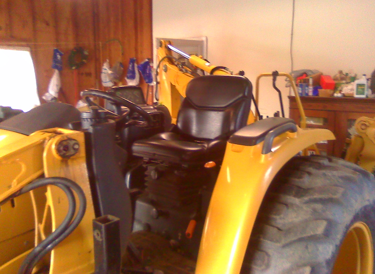

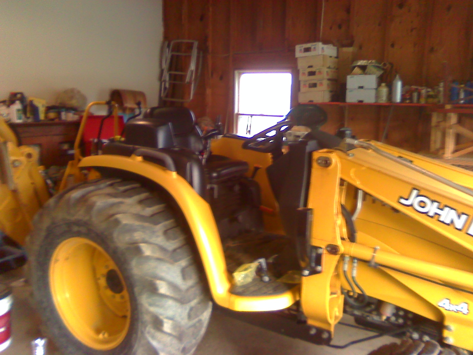

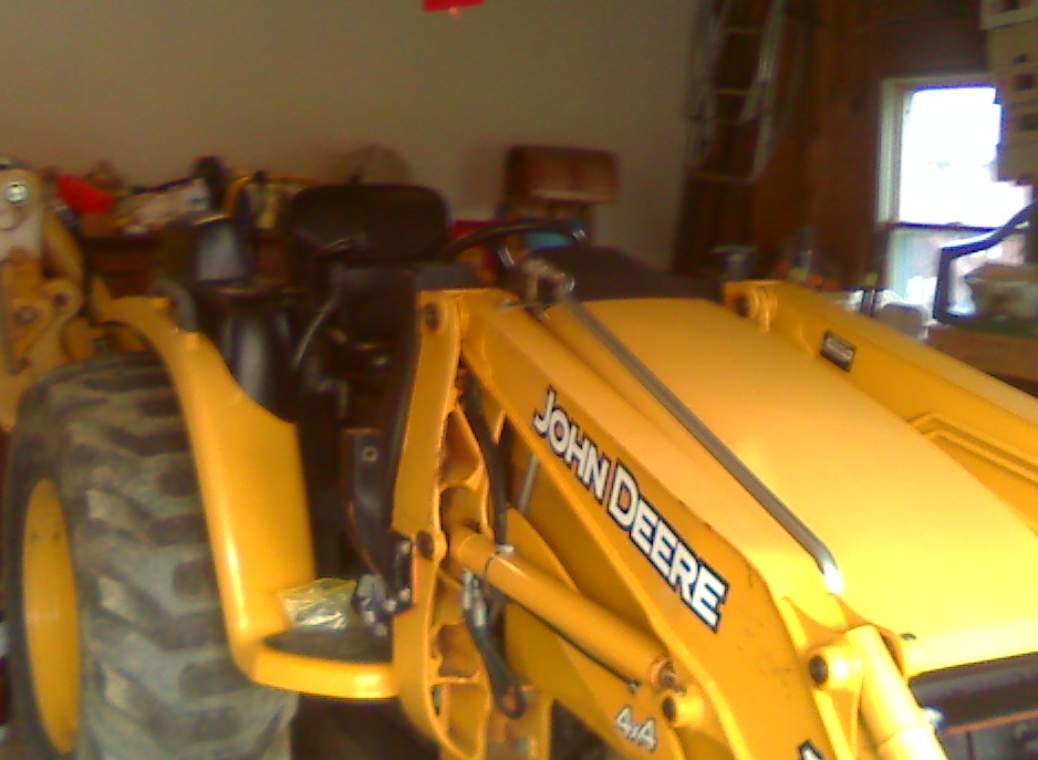

Naked JD 110!!!! Not difficult to take off but not easy either. Reccomend that you build a new building or least one with a 10ft high door. I will be building one this next summer.

The wiring runs inside the ROPS post on right rear(as you sit on tractor). There are 3 quick disconnects for the wiring on right rear of tractor just a head of the rear axle. Per murphy's law the connectors will catch on things as you pull the ROPS/canopy up & off. The bolts on the rear ROPS were rusted and needed lots of PB blaster. Getting a socket on them and leverage was a chore too. That's why I recommend building a shop with 10 ft high doors or put a 10 ft high door in if you have a building already.

I understand totally. ROPS / canopy is heavy. Need 3 good men. I used a strap to lift it off!!!! Good luck!!!
