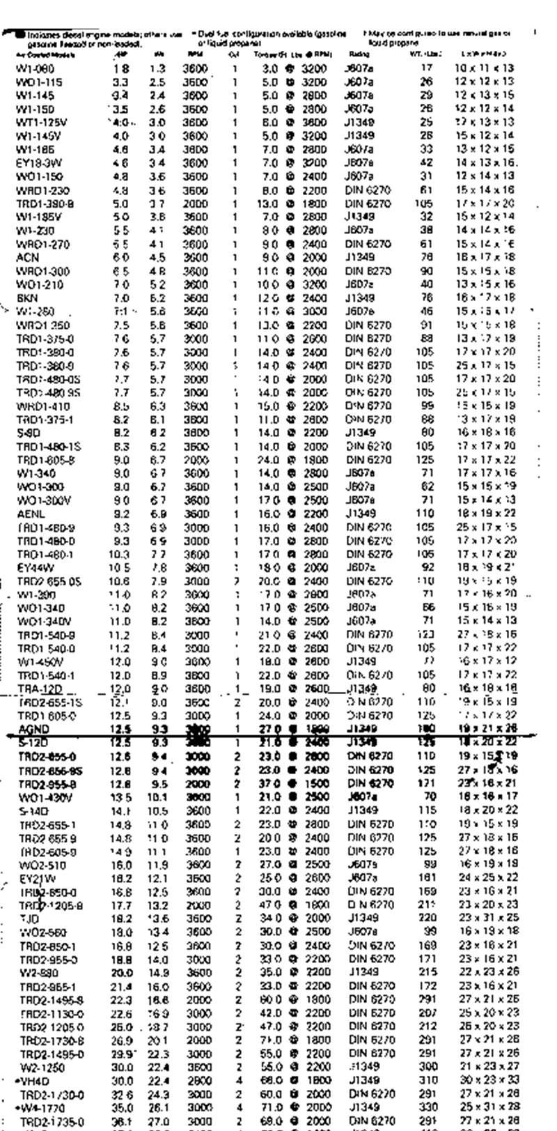

I am looking at a JD125 skid loader wit a 40hp Teledyne engine. The engine has issues. I am having a hard time finding much info on Teledyne engines. Can someone point me in the right direction.

See attached .gif file.
