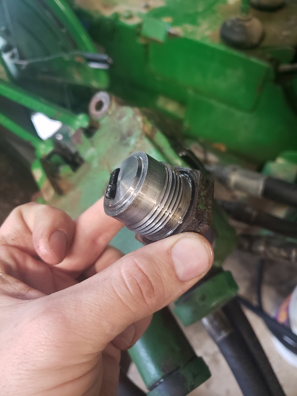

If your control valve resembles valve in photo check for failed seal(item 10).
I still remember locating that same seal that had failed on a tractor with a model 48 loader that I was attempting to diagnose a hyd problem about 50 yrs ago
Yes, I agree with that. It might be that he has the correct control valve for the closed hydraulic system and it has a failed seal. But I would have thought that the hydraulic shop he took it to would have caught that with the test they did.

#15
Took the valve out.
It appears to be the correct one only missing most of the oring.
Now I will have to wait until Tuesday to go to hydraulic shop after the holiday unless Oreilly would carry a square oring box.
John Deere can get the part but its not in stock.
   / JD 1530 _ FEL & 3pt issue #16
Yepper reminds me of a similar failed o-ring I finally located many yrs back when I first started diagnosing closed center hyd system problems. Replace that seal with a good seal & you'll be amazed how much better your tractors hyd system will operate.
United Ag & Turf in Magnolia Ar. shows to have 3 ea-U30255 in stock
