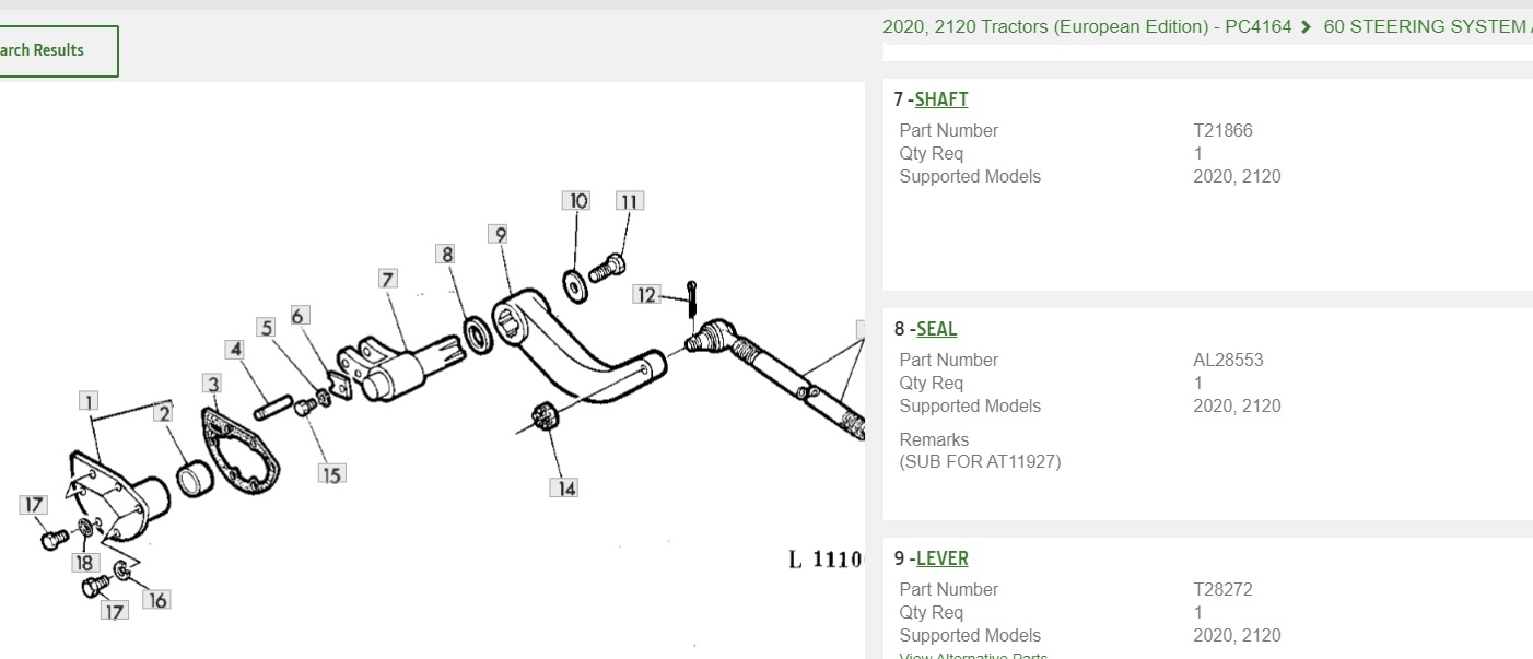

My JD 2020 started leaking profusely from behind the Steering Shaft Arm recently. Thanks to this forum I was able to isolate the fault to the seal, I thought… I replaced the seal which did appear damaged and not a JD part.
When I started it it appeared fixed until I used it a bit. Then it started leaking again, this time coming around the cap screw from the seal area surrounding the Steering and Yoke Shaft? I’m pretty sure I didn’t damage the seal and it is a JD part. The leaking seems to be only as I turn the steering wheel. Is it possible the pressure is too high?

Find a way to determine what the pressure is so you have more info. I'd suspect the seal may still be the problem.
What is the part number for the seal?

Did you replace the adjustor when you replaced the seal?
Does this link to a power steering rebuild help any?
   / JD 2020 Power Steering Leaks
The seal number was AL28553 and I also replaced the gasket on the cover on the other side. I’m not sure where the “adjuster” would be but I didn’t replace anything else other than the cap screws on both sides. I read down through the thread but it seems to more of a steering column rebuild than the problem I am having?

   / JD 2020 Power Steering Leaks #7
Yes, is it possible that it’s in backwards?
