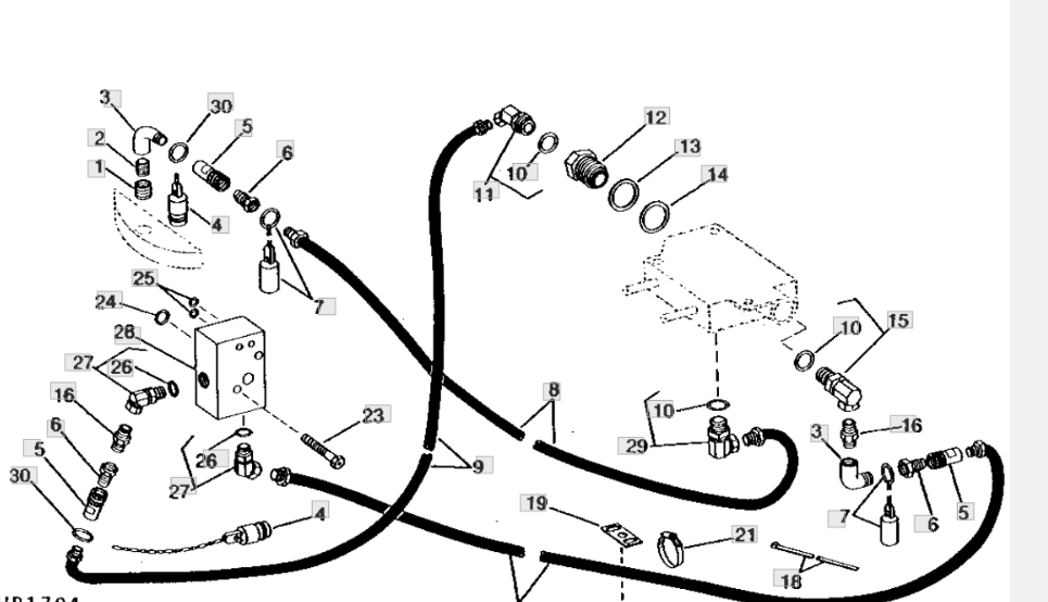

If your 2040 has a 3 cyl engine then according to your serial # it has open-center hyd system. I suggest to contact tractor salvage yards inquiring about an open center scv kit. Another option would be to install a 2 spool similar to valve used to control frt end loader similar to photo below. To install loader control valve one would need block (item 28) part # W21205

Great info. Where can I get a schematic for installation of the scv kit or fel connections?
