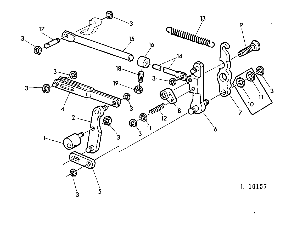

Check rate of drop screw under the seat to be sure it's not completely closed. Do other hyd functions operate properly? Check frt hyd coupler to be sure it's intact. It's remotely possible that some of the linkage in photo has become loose. Where is L/D control lever adjusted? Put it in "D" if mot already there.

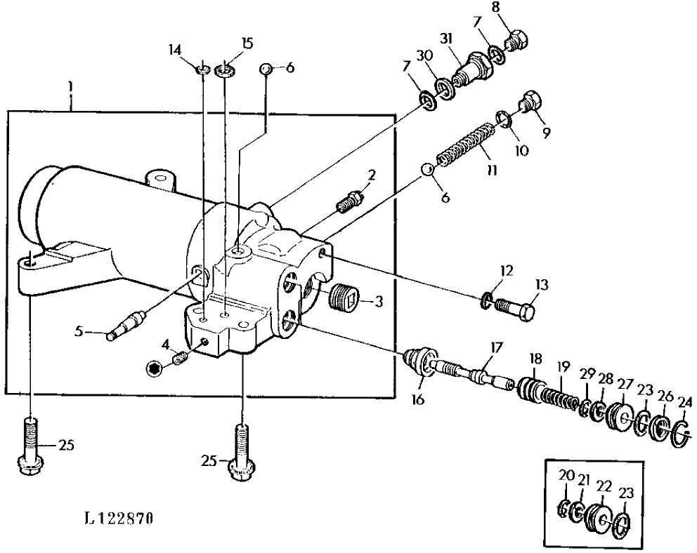

The whole drop rate control was loose. The whole unit comes out when turned. I take it only the top threaded screw is suppose to turn? Would that cause air to get into the system?
   / JD 2120 3 pt won't lower #10
On rate of drop screw bolt(parts key #8) screws down against the ball(parts key #6) to block(partially or complete) the return oil port in the piston housing. Air normally enters hyd system from a leaking suction tube on trans pump. I'll ask again: where is the draft control lever setting?? If it's setting anywhere else but "D" then set it in "D".
