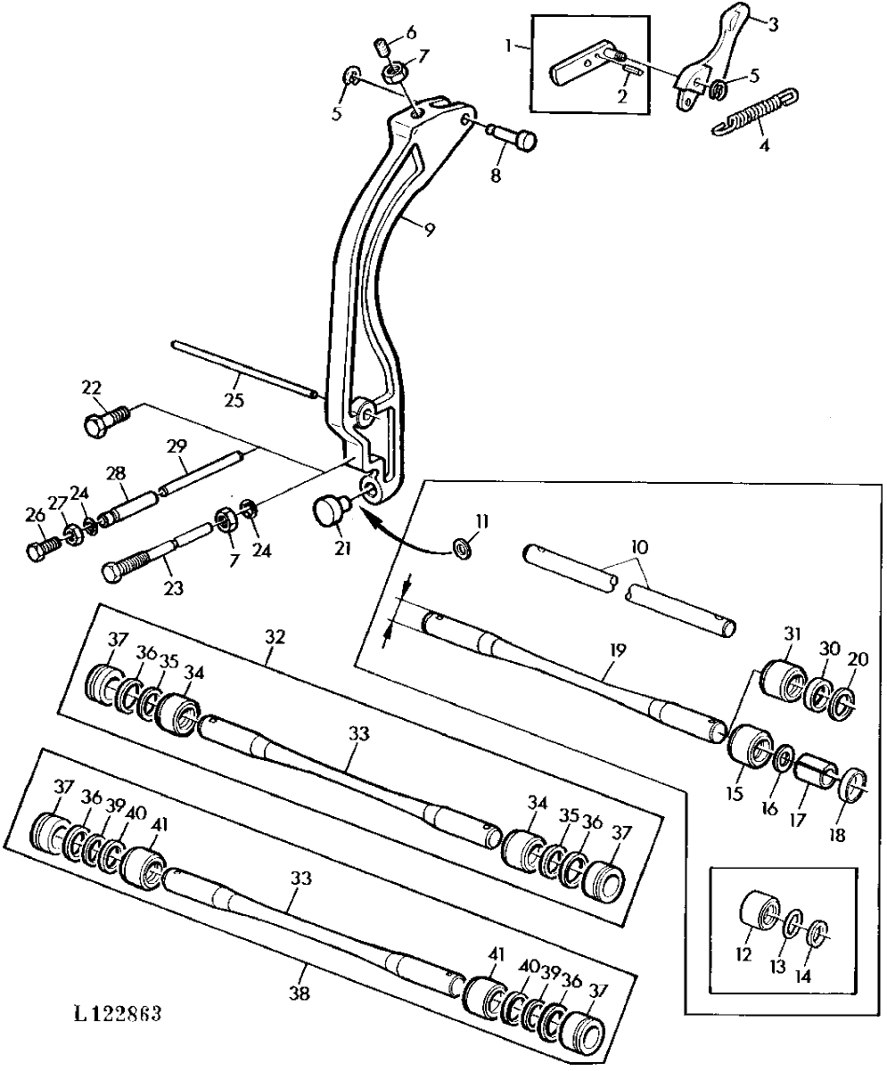

JD 2120 3 pt won't lower
   / JD 2120 3 pt won't lower
#11
It was in load L position
   / JD 2120 3 pt won't lower #12
Did you move the lever to "D" and if so did that change anything?
#14
No change almost like the lever is not connected to anything inside.
   / JD 2120 3 pt won't lower #15
I'll bet the spring(parts key #4) or the follower(parts Key#3) broke
#16
I bet your right. I'll look where I drove yesterday. Not too far luckily
   / JD 2120 3 pt won't lower #17
Both items I mentioned although on rare occasions have had a history of breaking. Bad side is one needs to R&R RS housing to see. Is you tractor open station or cab model?
   / JD 2120 3 pt won't lower #19
R&R of RS housing is fairly easy on an open station. If you decide to R&R RS housing I would advise to R&R 3 pt control valve o-rings while housing is off as the o-rings have a long history of leaking.
#20
Is the spring on the outside hooked to level and the draft selector
