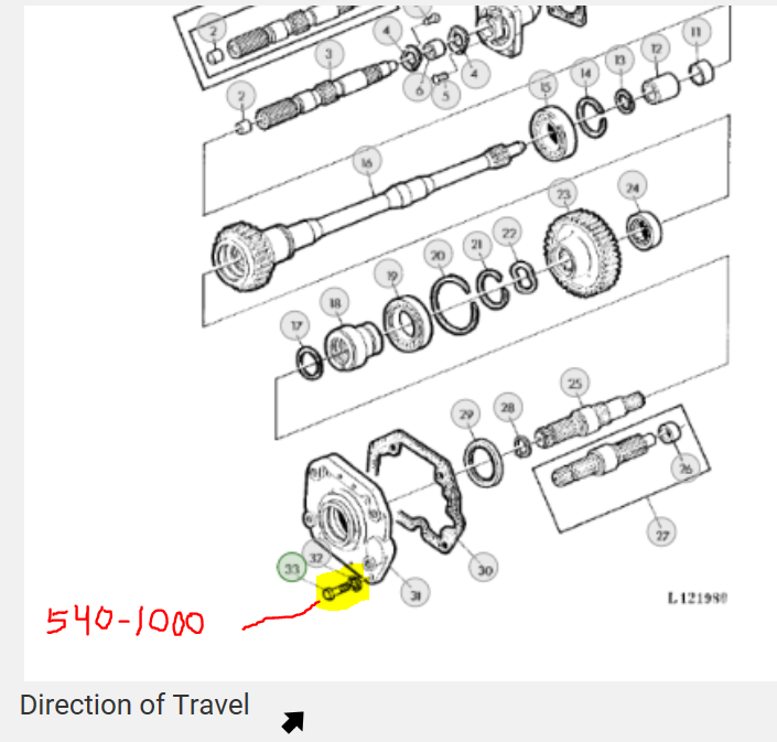

I would install the load shaft without the seals. You can then slide the shaft in enough to install the seal on one side then slide the shaft back out. So for each side slide the shaft in far enough to clear the seal groove of the bushing, install the seal, then slide the shaft back out, but do not remove the shaft.

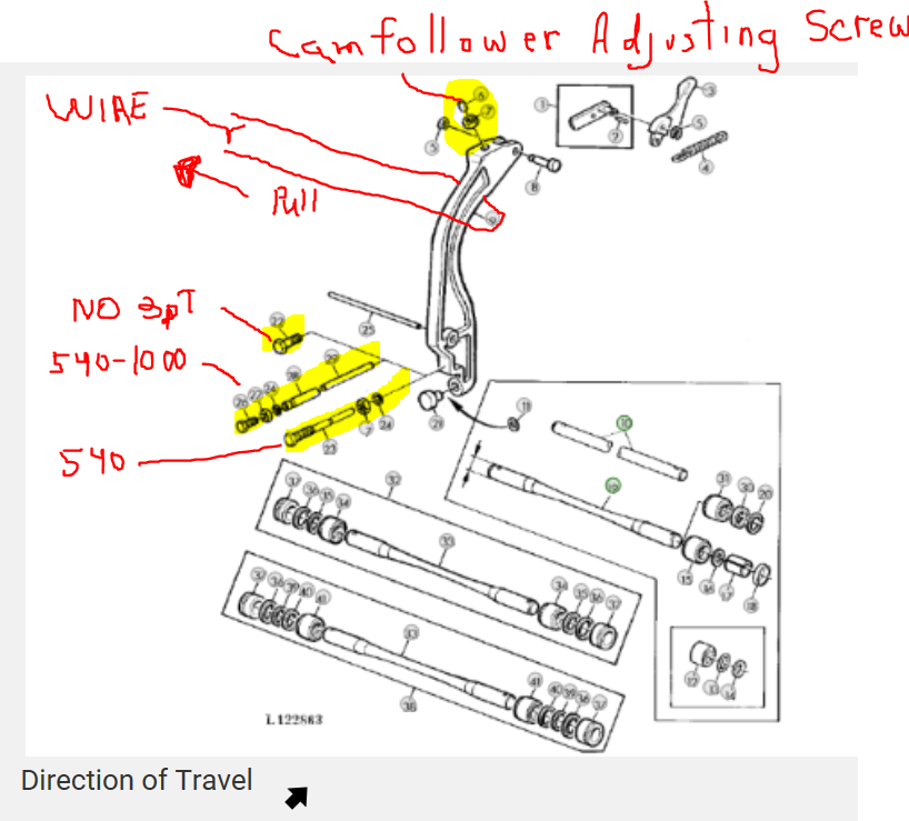

I know you are having trouble finding the negative stop screw. The drawing shows three possibilities. See first drawing from JD parts
One is no 3pt hitch (just plugging the hole, and not yours)
Next is for two speed (540-1000rpm ) PTO.
Third is for 540rpm PTO.
Note both of the last two options have lock nut on the screw to hold it's adjustment. So look on the back of the tractor for hex head cap screw with a lock nut.
540-1000 will be at bottom of the rear cover that has the PTO shaft coming out. See second drawing from JD parts
For the 540rpm PTO, look at the rear and forwards of the sway block.
I also know you are having trouble getting the load shaft in
Now for a different idea, than trying to move the Lever key 9 with the negative stop screw, see if you can get a wire around the lever (through the hydraulic oil fill hole) and pull back on the lever with the wire. See first drawing :confused3: May or may not work :confused3:

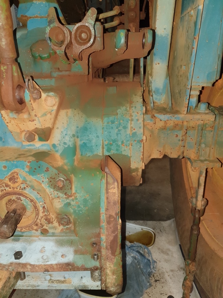

So this is what the back of the 2130 looks like. Can't seem to find anything with a lock nut on the bolt, different to the you tube video I watched. Might try the wire trick....

Hmmm. Very interesting. I guess that is the difference between a German and American machine. In my research I have been looking at mostly 2030 models. Made in Iowa and everything lines up. Drawings, parts etc. 9 times out of 10 I will search 2030 then relate it to my tractor and use that info.
