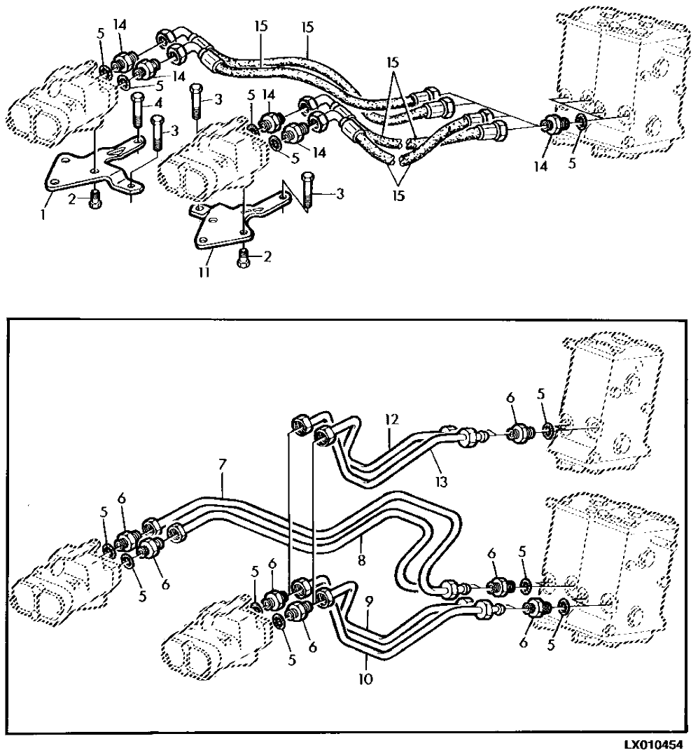

Is the box an enclosure for a loader valve? Does it have hydraulic couplers. Might want to pay a JD mechanic to check it out for you before you buy.
   / JD 2155 Leaks..Please explain to a newbie! #5

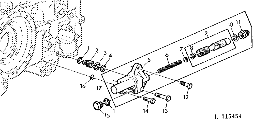

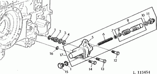

Is the tractors leak either one of these parts schematics??

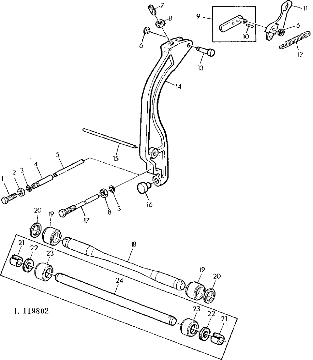

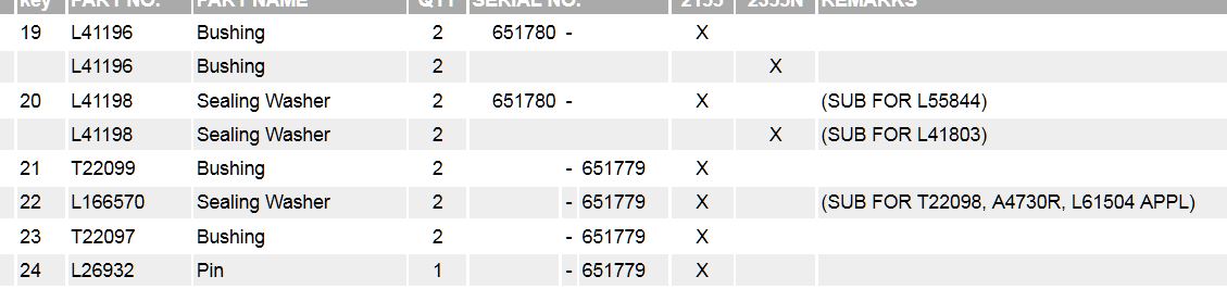

You can find the parts schematics titled: PARTS FOR LOAD CONTROL
   / JD 2155 Leaks..Please explain to a newbie! #9
Thanks Tx Jim - With your help I got the correct parts and changed them out.
