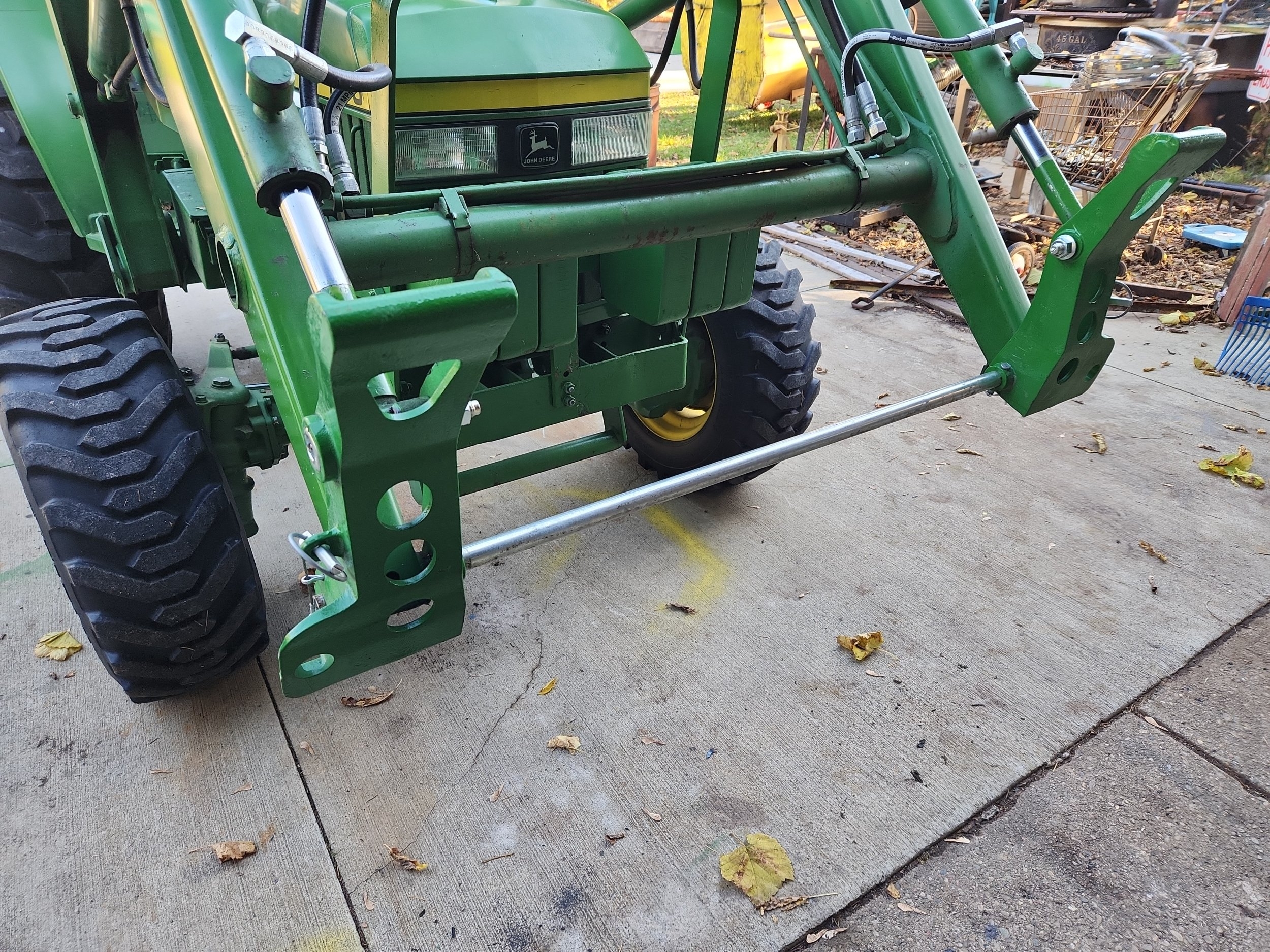

Correct, trying to figure out the best way and if the newer JD style would fit my pins with the older 146?

OP, do you have fabrication capabilities or are you looking for a plug and play option? I can't help you with John Deere specific parts compatibility but I've converted half a dozen or so different tractors to SSQA (including one John Deere. Don't recall the model) and could help if you have questions about a conversion.

I can fab a bit with stick welder and some cutting. But I am not the best.

That's not a project for a novice, IMO. Not that its complicated, but weld or design failure could cause some serious damage. Sounds like you should be looking for a plug and play option. Unfortunately I doubt that's gonna be cheap. If it's not urgent, and you've got the time, start developing your welding skills on other projects. Some folks pick it up quick.

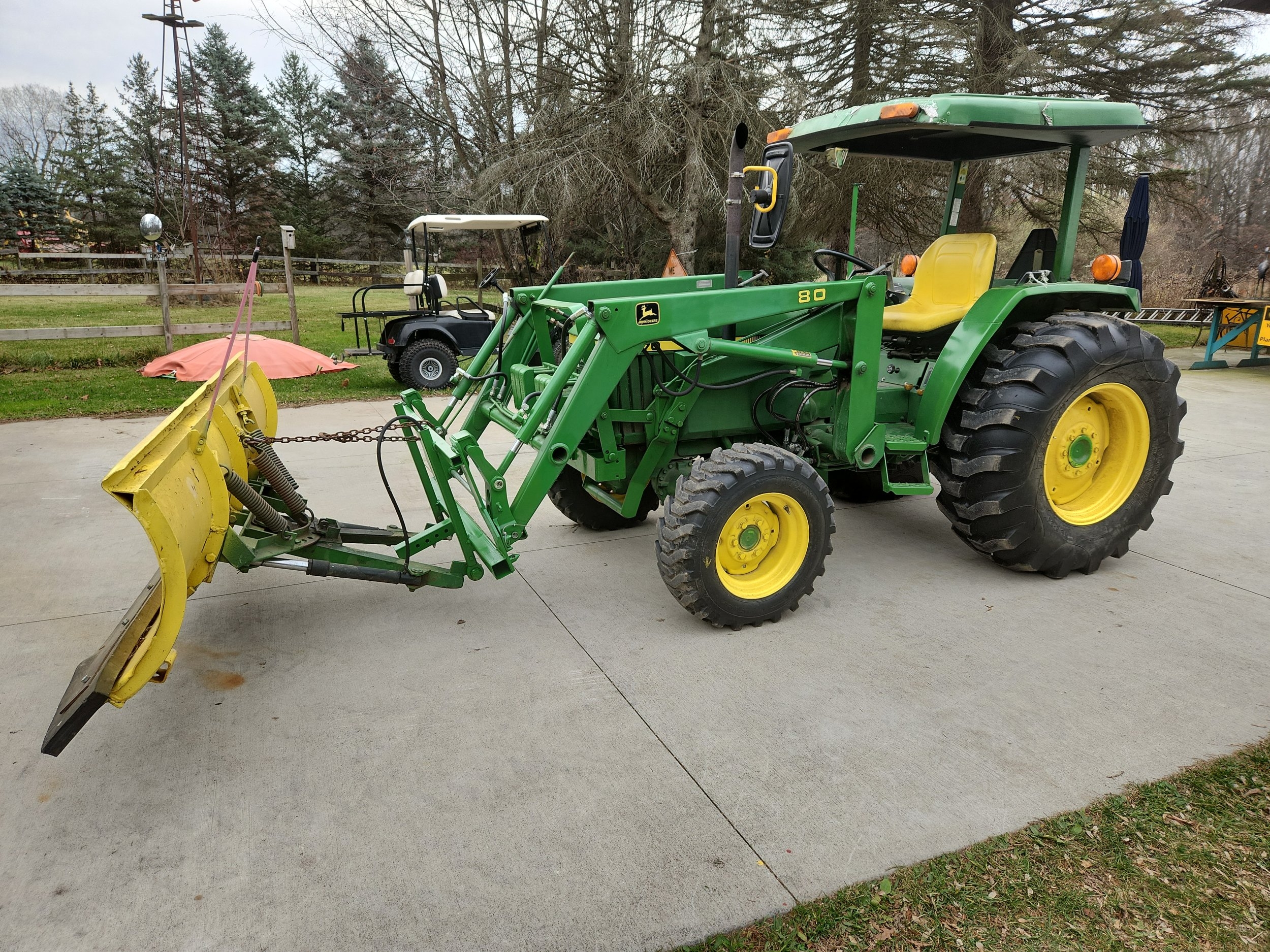

I bought this framework from Deere for my 80 loader. 'They' said it wouldn't work. It does if you make a tiny modification to the curl cylinder pin collars: Grind off 1/16".
then I bought a new bucket all set up for the Deere QA, but a grinder can remove all the old bucket's pin fittings and then you weld on these 2 plates. I even made up a new offset post hole digger from a set and it runs hydraulically. Nice to see where the auger is headed into the ground and my owl neck is gone. Even my bucket old level rod fits right in. By far the most use I get from it is forks. I even move my golf carts around with them. Built a snowplow frame up by this year I want to try a broom. Have not used the tree puller yet, but pretty soon !
