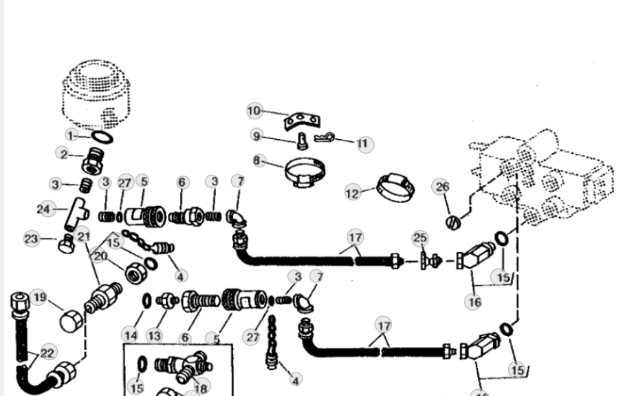

What kind of quick connect do I need for a 145 loader on a JD 2240. It has two hoses going to a control with two handles.
   / JD 2240 Quick Connect #2
If I was attaching hyd hoses to a 2240 to operate a FEL I would attach similar to the method JD engineers utilized. It will provide the best/fastest boom/bucket operation speed. Ported hyd filter cove is part # L55982.
If you desire cheaper & slower FEL operation plus tie up rear breakaways you'll need male hyd tips(AR30210 or 5060-15) similar to 2nd photo
