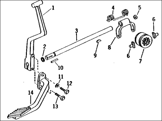

My guess is spring is broken allowing pedal(key 14) to drop engaging diff lock when not needed. Normal problem is shaft(key 3) gets rusted tight in axle housing.

   / jD 2240 with busted differential lock? #12
You have to pull the left axle assembly, not split the tractor to access the differential lock.
   / jD 2240 with busted differential lock? #13
Good point zebrafive on no split required to repair.

Bought my tractor from someone who never used the diff lock or the foot throttle for 26 years because his 520JD did not have them. It took weeks of spraying and tapping to work the diff lock lever loose.

   / jD 2240 with busted differential lock? #16
We've all done that!!!!!
I'm betting the spring was broke, thus the wooden block. A tarp strap would have done the same thing. :)
