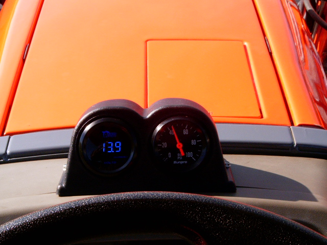

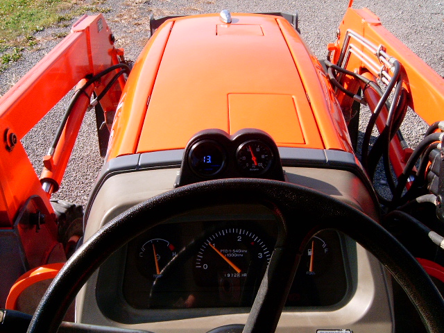

This is how I added oil pressure and volt gauges to my DK 35.
I think it looks fine here and easy to see.

Vince;
Where did you get the set of gauges ? Are they water proof ?
I like real gauges . Just installed a trio ( temp, oil, and volt ) Sun brand with the classic turned metal face on our 63 Belair. Next to the Hurst lever, bench seat, the gauges turn the clock back to the 60s.
