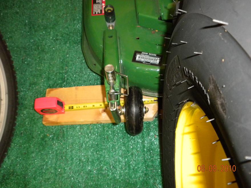

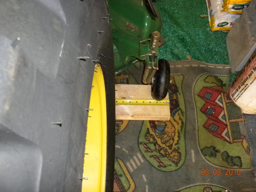

thanks Joe...if its not to much to ask..do you have a pic of how far the 62D sticks out past the rear tires..?...maybe a shot from the back...thanks :thumbsup:
   / JD 2320 advice please #10
Looks like different width for each side, hope these help....:thumbsup:
About 8" on the right (discharge flap up) and almost 11" on the left.
