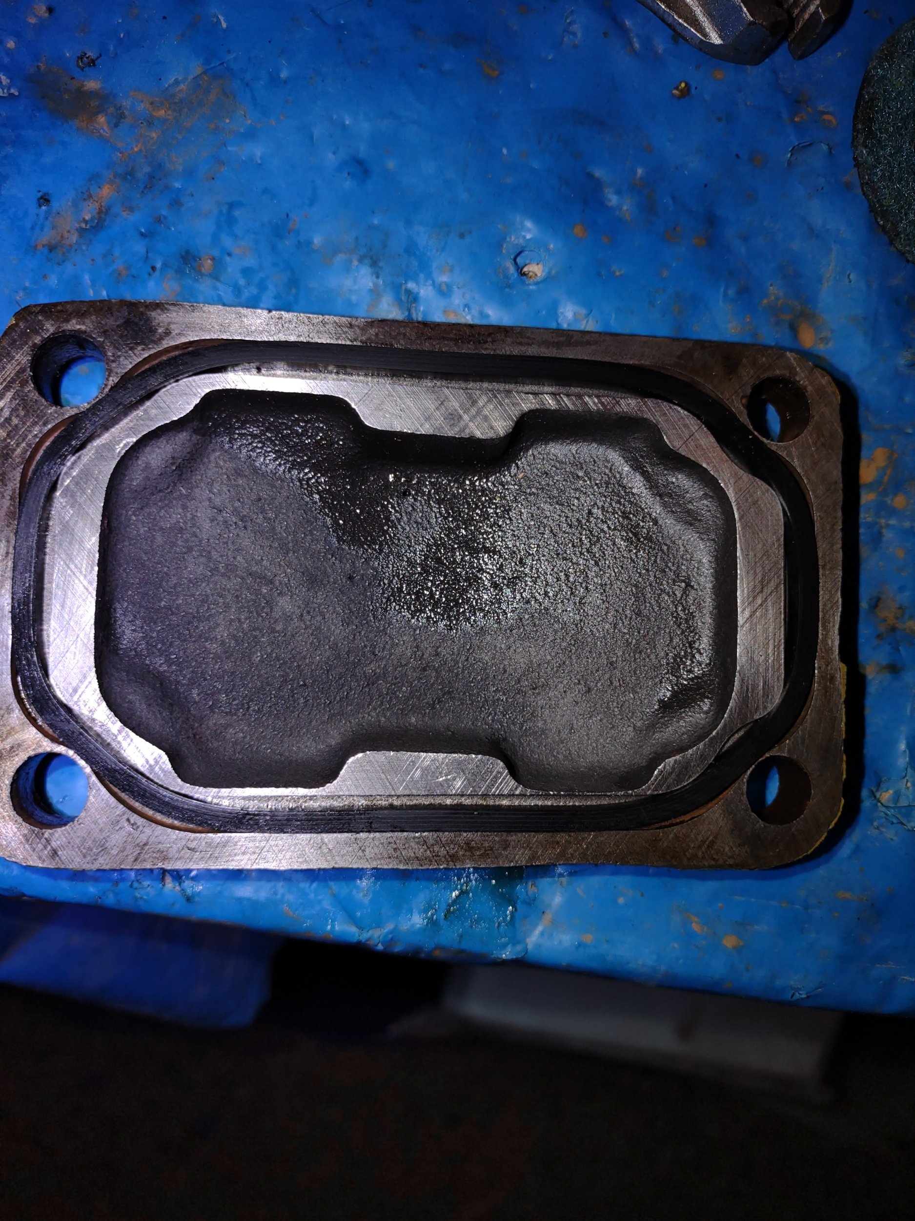

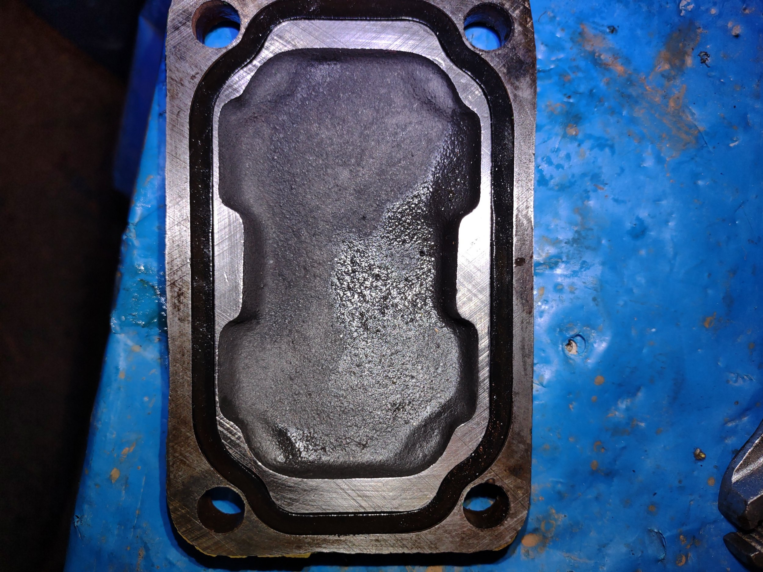

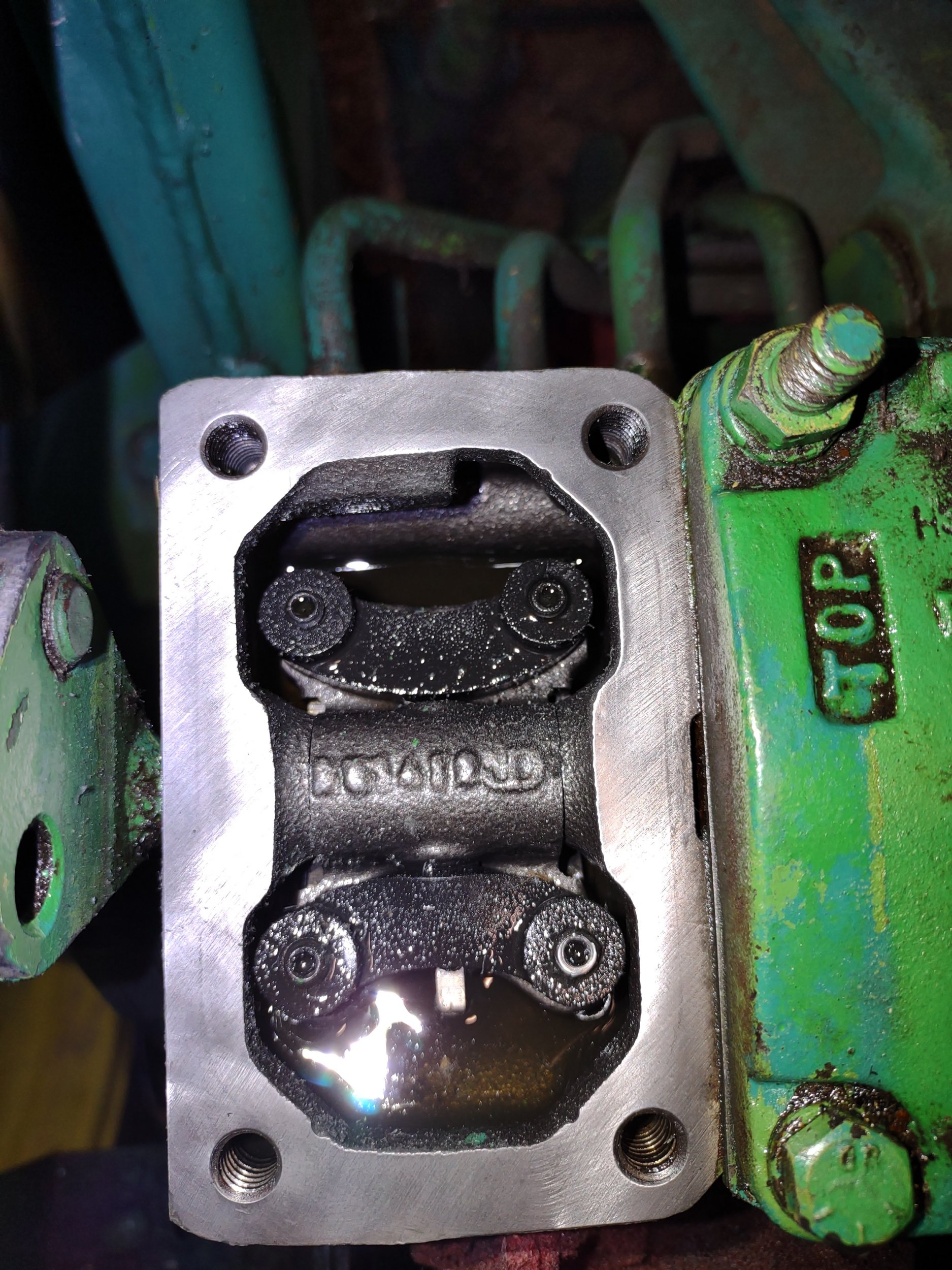

Can you also provide close up photo of the valve housing surface where the cover bolts on? R49187 is the correct seal number
@jd110 Here is a picture of the assembly where the cover bolts to. It is leaking right in the middle between the two covers. I am confident it is the cover on the left leaking which is not installed.
   / JD 2440 Leaking from Cover of Old Style Dual Remote SCV #13
Does new seal extend out higher than groove? It should extend out of groove & tightening bolts should cause quad-ring to expand in width. I suggest placing cover on very fine grit sandpaper that's resting on a flat surface. Moving cover back & forth on sandpaper a few strokes then check for high or low spots.

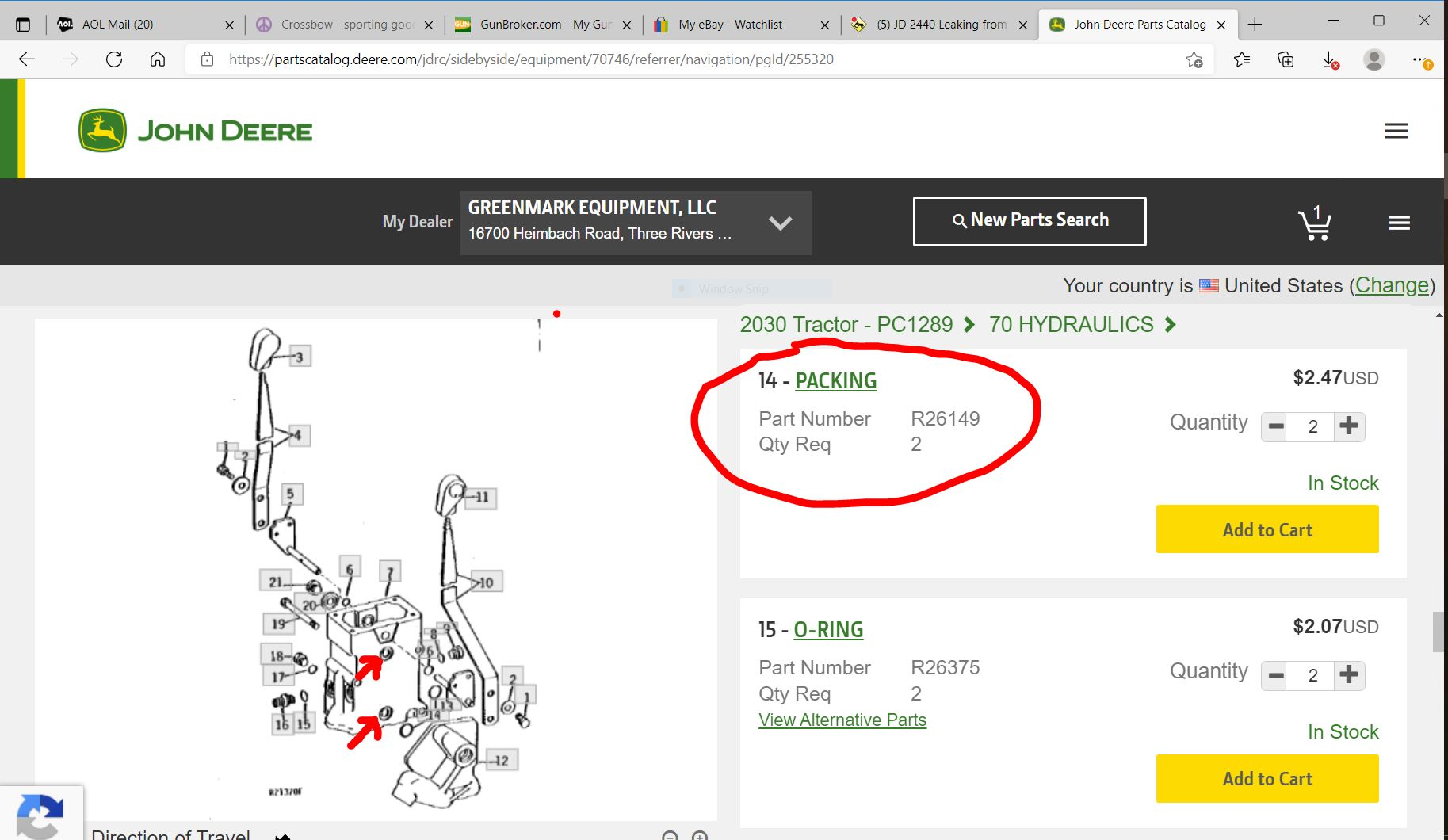

I had a leak on my dual SCVs on my JD 2030 between the valves. It was the O-ring between the valves, not the covers in my case.
   / JD 2440 Leaking from Cover of Old Style Dual Remote SCV #15
@Zebrafive Was it leaking out of the top cover? and if so which seal are you talking about? Thank you!
I will give that a go, yes it does extend out. Thank you again
Mine was leaking BETWEEN the two SCVs. I had to replace two packings R26149 (I called them O-rings earlier)
#16
Thanks for the information! I will take a look at that as well, I plan on removing the offending one this weekend and taking a deep dive on it. Would be nice if it was something simple like two packings... Not my luck though.
#17
just a follow up, the
Just a follow up, The leak WAS between the SCV's and it was the seals on the shafts! Pretty easy to replace!
