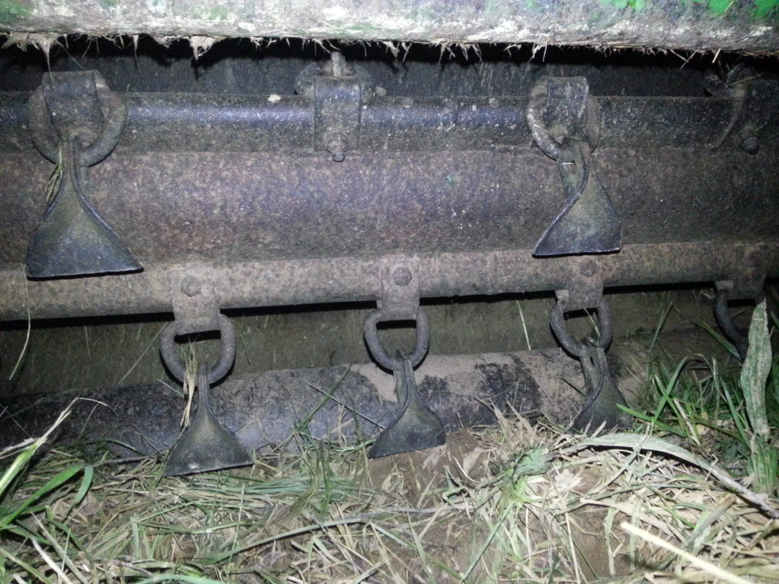

Hi All, new to tractors and Flail mowers. I think I have the same mower (in green). It came with the early 60's model Ford 2000 I bought and I'm hoping to get some advice. What is the best position/angle for the mower? I have tried adjusting my top link a few different ways and don't think I have found the right position yet. The mower is bogging down in tall (2ft) fescue and I'm even getting some vibration and clanking noises at higher revs. Should the roller touch the ground in that tall stuff or should I raise it up at first and make multiple passes? Any maintenance suggestions? Are the blades in the picture suitable for mowing tall grass and clearing overgrown fields and/or cutting small sapplings? Thanks in advance for any help.View attachment 315818View attachment 315819View attachment 315820View attachment 315821View attachment 315822

Are there any missing scoop knives????
If there are you need to replace them as soon as possible
before you mow again becuase this creates an out of balance
condition which will destroy the flail mowers Rotor Bearings.

The wear parts which are scoop knives, knive hanger strap,
nuts and bolts and D ring knive hangers are wear parts and
you should have a quantity of them on hand at all times.

The rear roller can be adjusted by removing the 4 bolts which attach the rear roller adjustment plate assemblys to the side weldments of the flail mower.
The rear roller has a pair of weldments that attach to the side weldments of the mower.
They should have 4 adjustment holes to set the mowers height using the rear roller to set the mower height.
As Greg has mentioned lowering the rear roller raises
the cutting height of the mower which is what you want
while making your first passes.
The rear roller always touches the ground or the matted brush
while mowing. You can mow with the mower above the ground but
it will not mow as well as it would if the mower was touching the ground.
leaving the mower on the ground also prevents the mower from throwing
an object it impacts as it will remain within the mower hood and pass over
the flail mower rotor and back to the ground.
Raising the cutting height will aid you in making your first mowings and you
will be able to see the ground better after mowing.

When adjusting your mower be sure to use a bubble level to adjust the
top link for the mower by placing the bubble level on the gear box and
then checking the level as you rotate the top link in or out.
The rear roller prevents scalping by maintaining the mowers level from
side to side to prevent the knives from impacting the ground.
