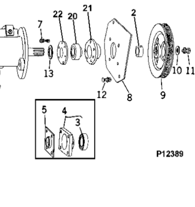

Looking for some advice and tips from individuals that have replaced the rotor/drum bearings. I read thru several threads and posts on the subject. Looking for a little more detail. I bought a really nice used JD 25A (2013 model year) several years ago and have only used it a couple of time. Unit has always been stored inside by original owner and me. I've only used it a couple of times. Now, I have 5 miles of trails and a couple of fields to mow. I've always cleaned the shafts around the roller and the rotor next to the bearings. However, my rotor drive side bearing failed 2 days ago while I was mowing my back field. Drive belt side of mower started smoking and I immediately shut the unit down. Pulled the cover and found that the shielding on the drive side bearing has melted and has what appears to be bailing twine wrapped around the bearing shaft. I can see the bearing balls so time to replace the bearing. I just bought two new bearings and collars from JD. How big a job is this? I’m going to replace both sealed bearings. Realizing that the rotor/drum has to be supported. Can I do one side at time or do I have to loosen both ends to replace each bearing? Once you remove the pulley and collar, it looks like you loosen the inner bearing support and then the larger support plate. Again, any tips or tricks would be appreciated. Thanks in advance - Ted

Thanks for your reply. The bearing and support are in the inside of the frame. It looks to me that I have to loosen the bolts holding the bearing support bolts surrounding the bearing #20 in the attached diagram, then remove the bolts holding the large frame plate #8 and hopefully pull enough of the bearing supports to actually get to the bearing. I need to get this piece of equipment back into operation. Looking for some help. Thanks. jd25adiagram.png

Both rotor bearings are on the inside of the frame? If so, then both bearing attaching hardware needs to be removed, then the rotor removed. There are no shortcuts.

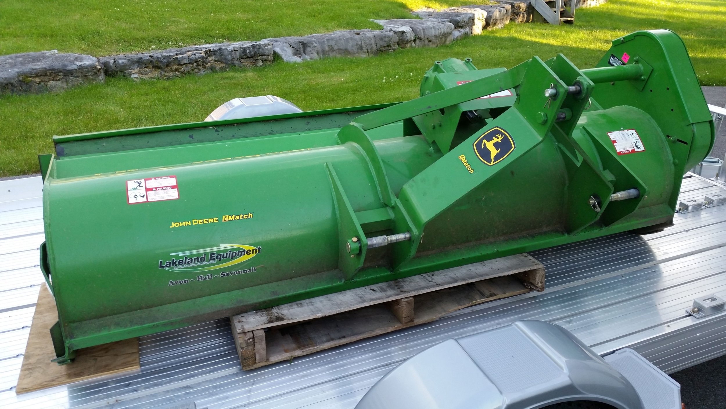

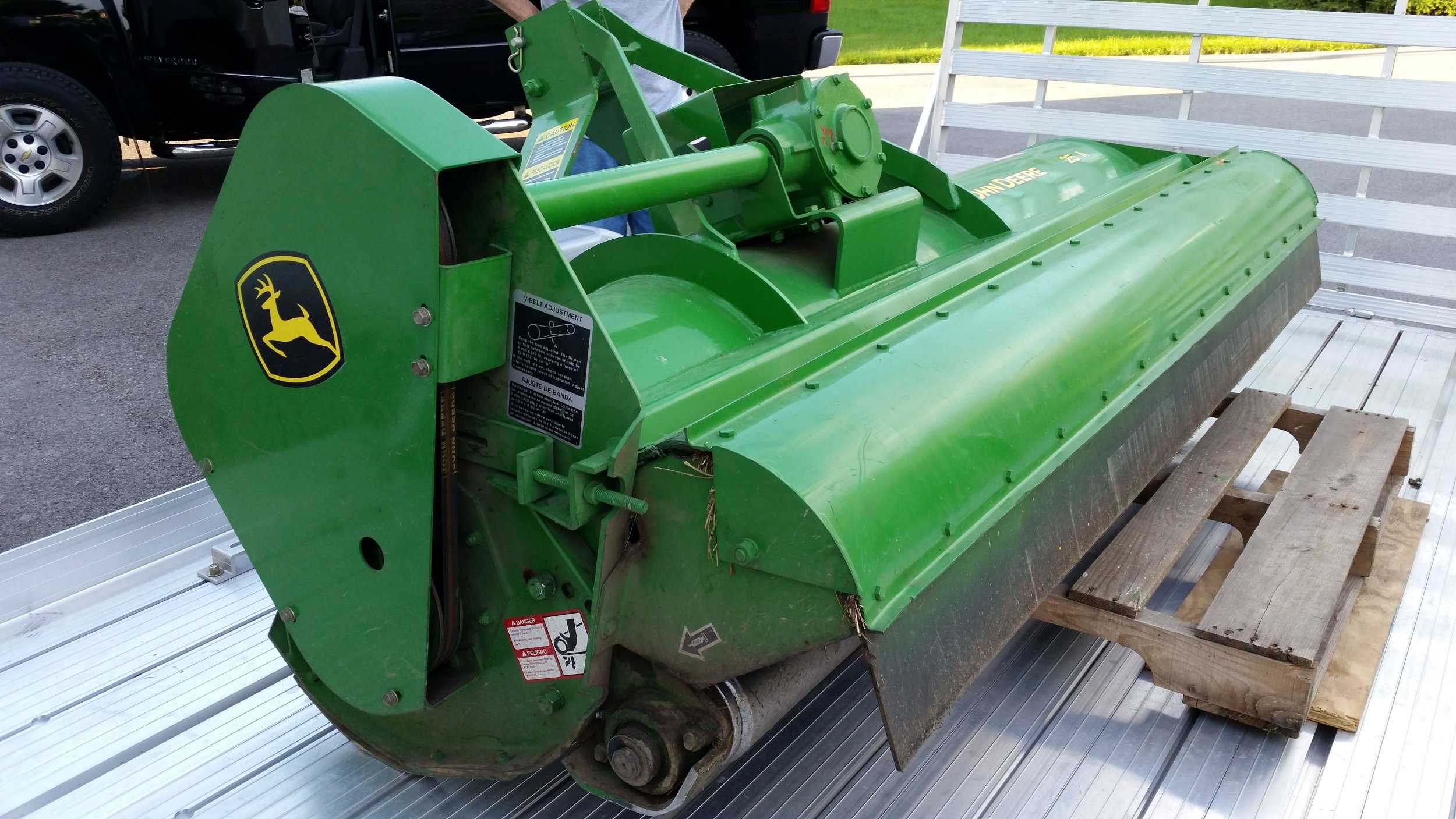

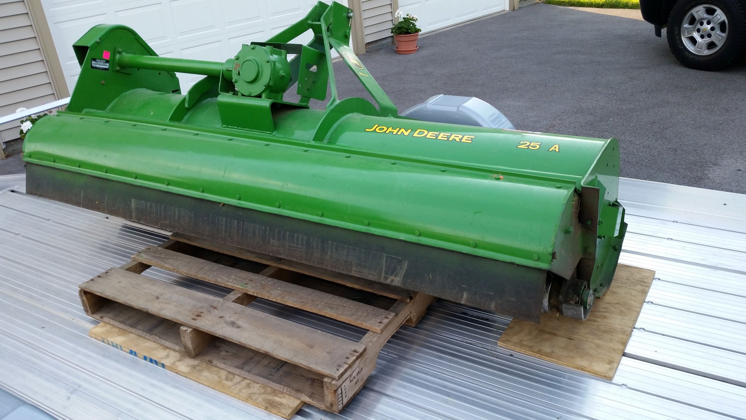

Thank you to leonz and Tractor Tech for the help. Here are a couple of pics of the flail when I brought it home a couple of years. Actually, better shape as I cleaned it up quite a bit.
leonz - as I've said that I have limited space and animals. As you can see, the unit is really clean and there is not much grease and dirt on the underside. Is it possible to block the drum up and with the flail frame on jack stands, then starting on the drive side, split the bearing supports without removing the drum from the unit and remove the bearing? Since I don't want to use dry ice because of animals, what pullers would you recommend? Thanks again for any and all help. Ted
